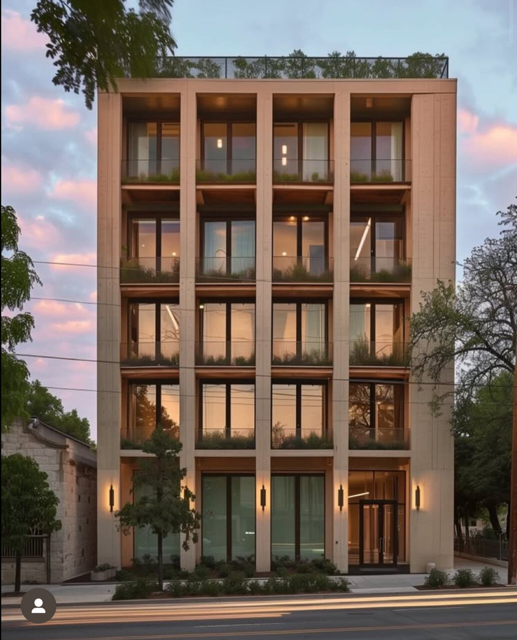

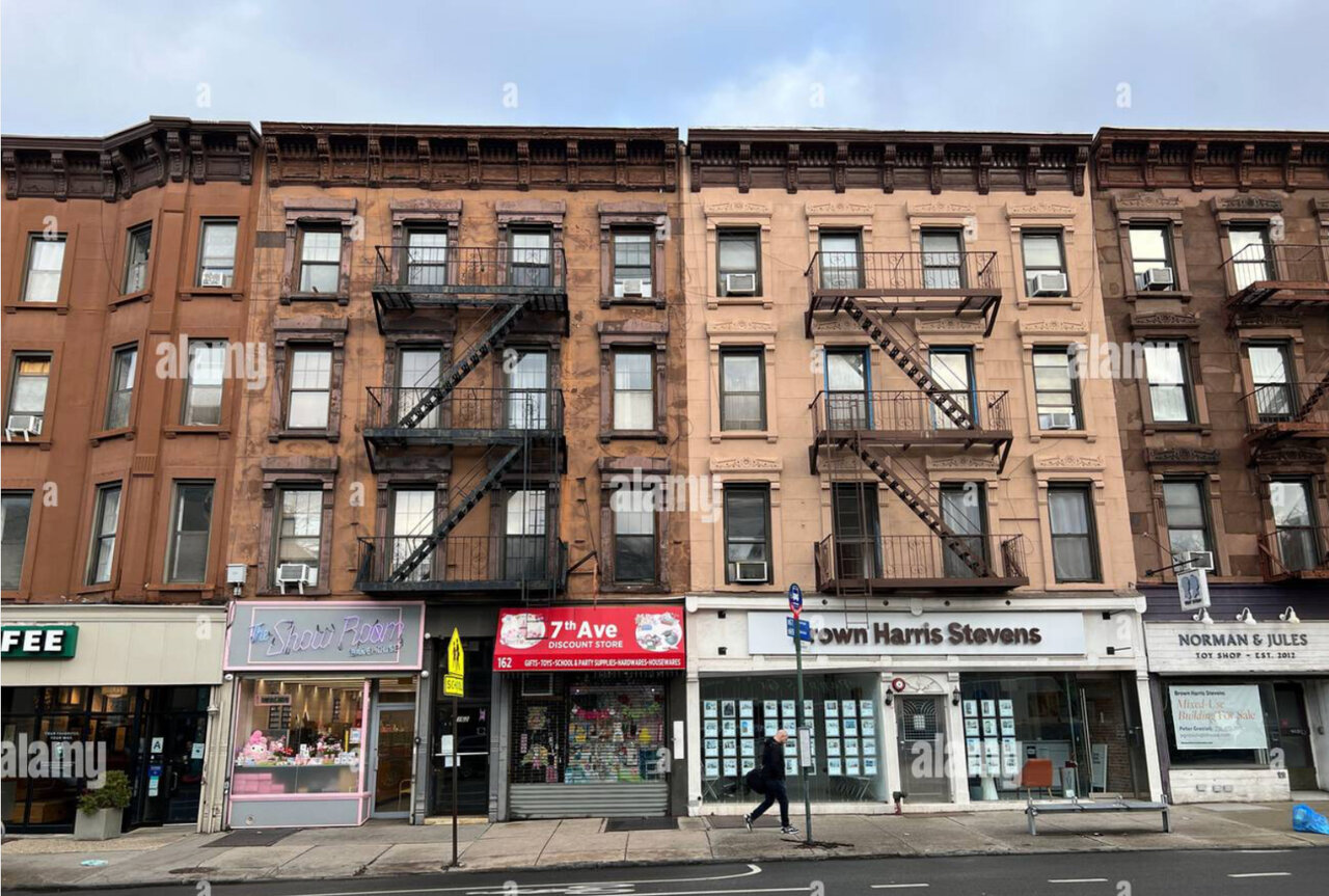

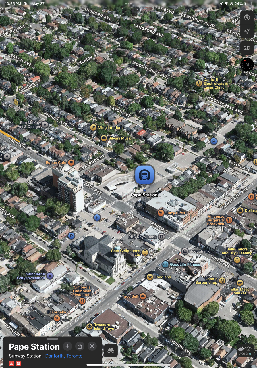

Hey everyone I just made an account even though I’ve been using urban Toronto for quite some time now. I have a genuine question: why doesn’t Toronto allow 4–6 storey walk-ups like NYC? Wouldn’t there be more benefits, like increased tax revenue? If they were built in close proximity to subway stations like Pape Station, which will eventually have two subway lines once the Ontario Line is complete it could bring a lot of positives. Compared to random tall high-rises in the middle of neighborhoods, these mid-rise buildings wouldn’t disrupt the vibe of a neighborhood. At the same time, they would increase ridership, which in turn helps maintain and expand public transportation. Maybe I’m missing something, since I only recently got into this urban planning stuff. But even texas, of all places, passed a bill legalizing 6-storey buildings with 4 units per floor. (1st photo nyc, 2nd Texas passed buildings, 3rd pape station)

Does NYC build much in the way of new walkups?

Perhaps one of the obstacles is that any building 4 storeys or taller requires an elevator, but I'm just speculating.
@Towered is on point above, you are required to include an elevator for any building greater than 3s in height. The requirement is for accessibility and safety.
So a 4s walk-up is a 'no'.
We can design equally attractive and we can do it a workable price point...........but we can't do it without elevators, and I think that's perfectly reasonable. We can't leave a huge chunk of the population unable to live in or visit tenants/owners in new mulit-unit builds.
