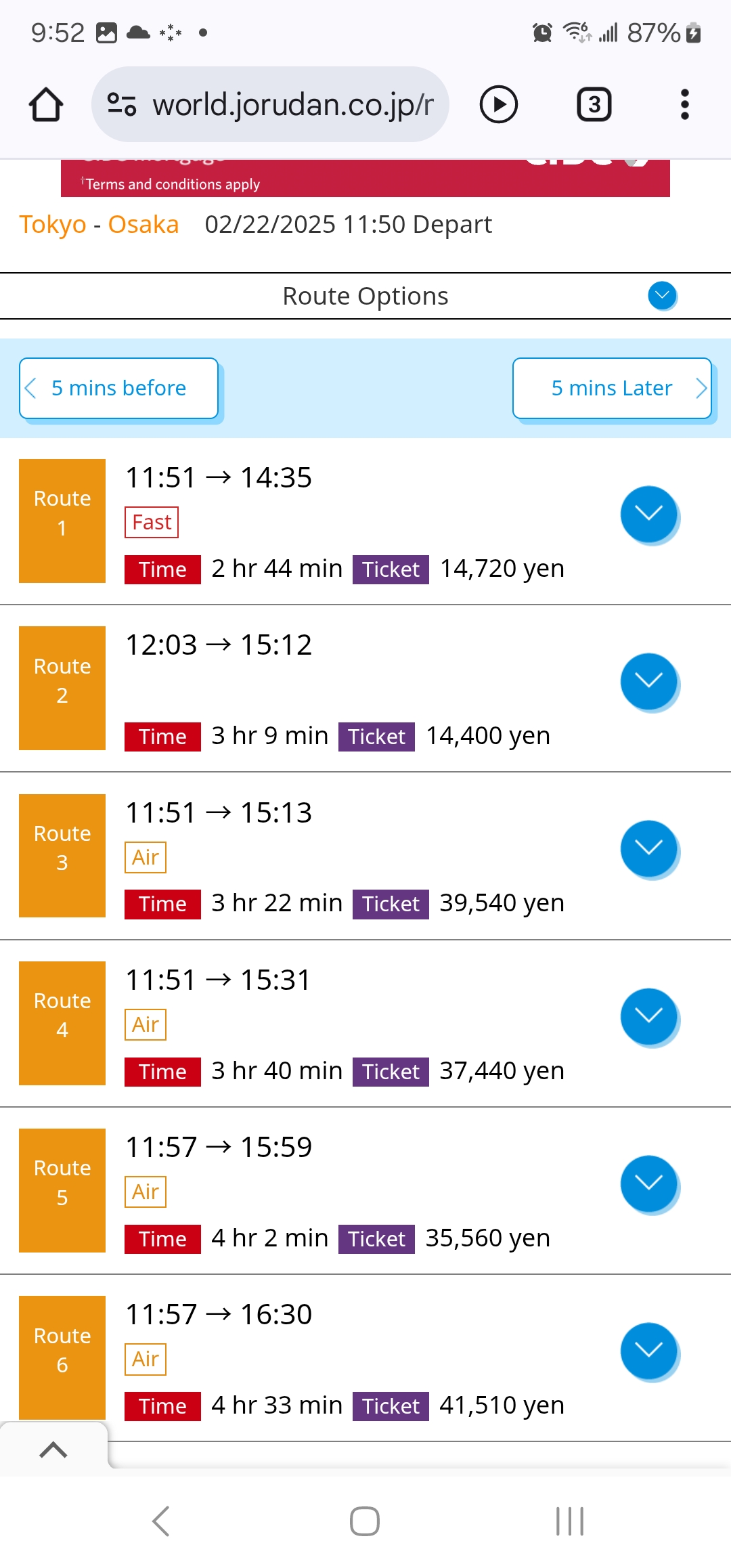

I'm a little late to the price/cost debate, but for what it's worth, the first two cost are for one-way travel from Tokyo to Osaka by high speed train (the remainder are for air).

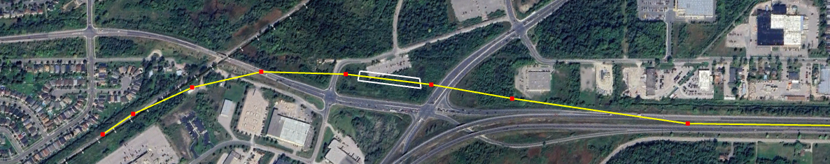

Peterborough. I can't be the only person who got on Google with conceptual crayons. There are several possibilities. Keeping the existing route requires kilometers of grade separations, and going overland past the airport is a lot of land acquisition and road severance. The Bypass is sitting there with about 60 feet of space between the directions, enough for building a partly elevated structure without too much disruption. This spot near The Parkway and Fisher is already on two bus routes and is about 4 km from downtown. There is already a park and ride/carpool parking log nearby, and parking for the Toronto-bound could be added.
I would personally think a downtown station is the best option, but I have no idea what the locals think about the issue. I would guess most have not thought much about the realities of the existing route because no concrete proposals have been put out there. Nothing focuses the mind like renderings of a viaduct running past your back yard.
Downtown would be expensive and difficult given the cost of all the grade separations. It would also increase travel times as trains would have to slow down to navigate the tighter turns to get downtown, all for what is really a very minor stop on the line serving an area with almost universal auto ownership.
Remember that 300km/h rail needs railway curves to be in the minimum of around 4km radius - even what you drew there is nowhere close to what is required. I would be surprised if Peterborough station doesn't end up as a station in the rural area south of the City.
What you drew there may be a worthwhile effort to place the station somewhere which is still convenient while still sacrificing a small amount of speed, but we'll see I guess..
Just to translate the currency for people.
The two train trips are in the ballpark of $135 CAD
While the flights are more in the $350 CAD price range, (based on picking a number in the middle of those listed)
