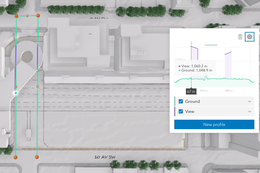

Or, as you're advocating, make it elevated through downtown. Considering it's a low floor train, and it's going to be bridged over the Bow for the northern crossing, I don't think elevated is a bad trade off if it could contribute to significant savings.
It would. Don't need to put a single pile into the bad soil if it really that bad, don't need to ever have empty volume if it is only mostly bad. Now it will create other problems, but whatever.
Here is the profile with the structures needed to clear in purple (CPR also needs 12 or 14m rail to structure iirc):
Definitely would be good to revisit the idea of elevated. It would solve a lot of headaches and get this through DT without intersecting the Blue/Red line.

Someone remind me what the CP clearance has to be? Doesn't really matter as the line would have to be even higher than that to clear the city parkade entrance off 9th Ave and the +15 that's there. I also don't know how you can support an elevated line with all that in the way. I'm not worried about the rest of the +15s along 2 Street, you can integrate them into an elevated line. The issue with elevated is where do you cross the CP tracks? Very few places can accommodate the turn radius required coupled with the need to cross the tracks. Every option comes with its own alignment affects, it's actually why I think they stick with what they have.
If can do the turn slowly, can turn just fine. All a matter of trade offs. It is all a matter of optimization. Digging a big hole turns out after 7, 8 years of trying to mitigate it, turns out to be an awful nut to crack.
