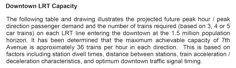

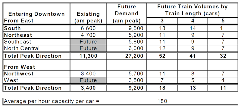

Is it actually feasible to interline all 3 lines on 7th Ave.?
There's a study from 2006 that actually claims the limit on 7th Avenue is 36 trains/hour in one direction.
I'm not sure if 36/hour really is possible. But due to loss of DT employment, WFH and other commute shifts, rush hour demand doesn't appear to have grown as expected. Right now the Red Line can't even use 4-car trains because of work at Haysboro and its peak frequency is still only about every five minutes. With 4-car trains, there should be room to reduce frequencies on the Red and Blue Lines to fit in 5-6 trains/hour for the SE which should be sufficient for the short-term and get an understanding for what the ridership from the SE will actually be. Whether it's enough to justify the 8th Avenue Subway, or to start on an independent NCLRT.
