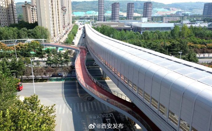

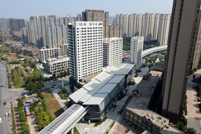

So options for mitigating issues with elevated in urban environments, China edition, Xi'an's Line 5 Phase 1 East:
Line 3 with sound wall on 1 side.

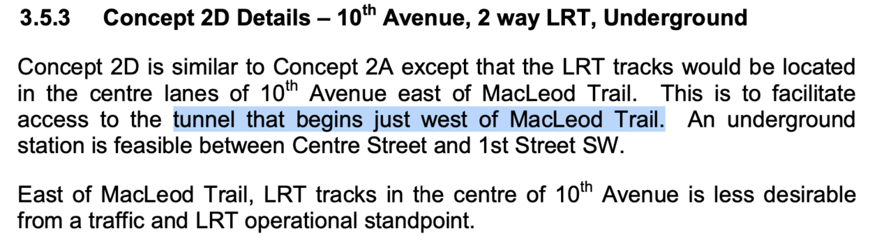

One of the 10th Ave concepts seems to have involved crossing Macleod Tr at grade and then tunneling under 1st St SE...which is weird:

But largely the focus was on determining the E-W alignment in the beltline, landing on 10th Ave

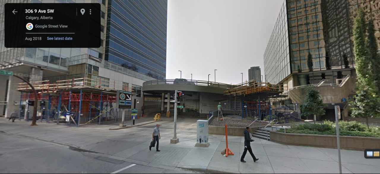

So...the CPA parkade ramp demolition/rebuild idea was new to me here. And I'm now remembering that it seems to have been on/off construction a lot in recent years (but I never really paid attention to it). But holy shit:

It was obviously open for a while in its new form, but kind funny that it was closed again for the latest street view.
Now I'm sure there's a reasonable explanation here...but presumably one of the impediments to a cut/cover plan was closed for like a year for a major renovation anyways? That maybe needs more work already? It looks great...but WTF? I guess that's just a +15?
