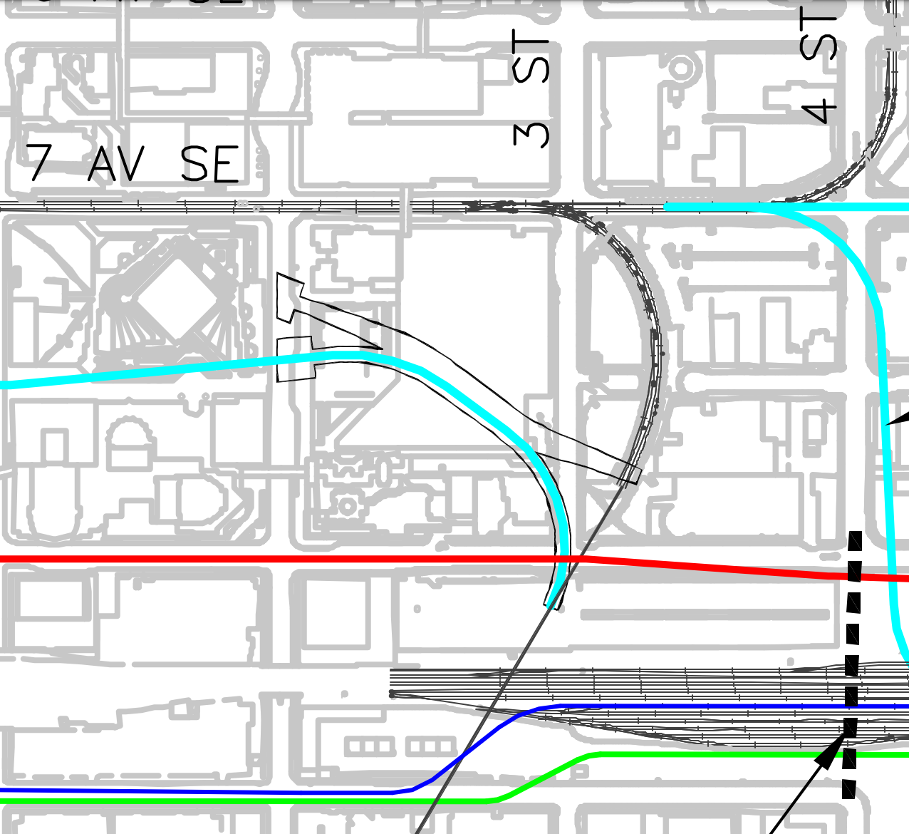

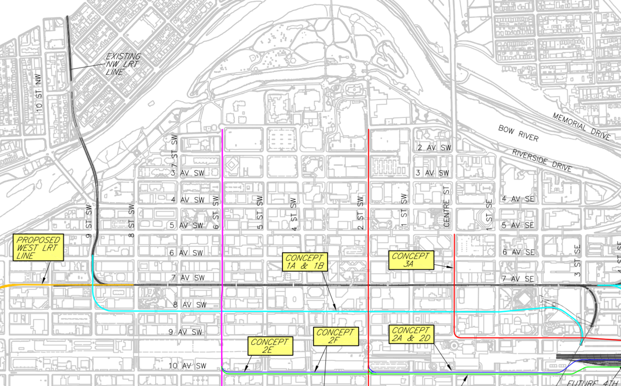

Would be curious how this would actually be done and what level of design has been sketched out for a future 8th Avenue subway. Would a tunnel portal be possible before 4th Avenue using the existing LRT bridge? Or would the grades be too steep and require a bunch of reconfigurations for the LRT approach and 4th Avenue?

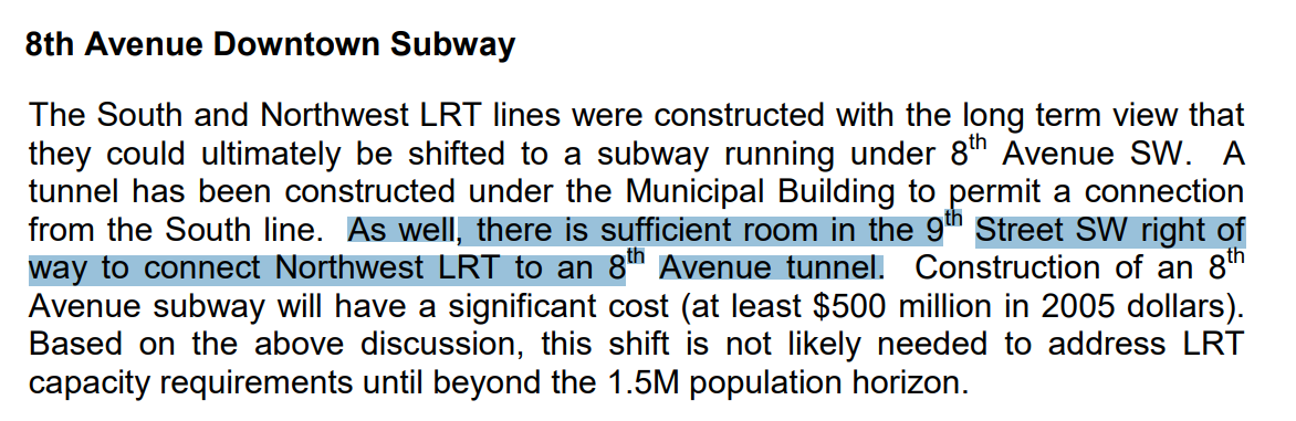

I assume there's enough room, LRT is a beast up the grades. The CP tunnel south portal fits inside two blocks
Edit: it's directly quoted as having enough room
Side note, interesting that this doc shows the tunnel layout under City Hall:
Did the math on slopes and the bridge awhile back -- it works with a road reconfiguration somewhat like this:
With a smoother transition, that's not a bad option.
Oh yeah no I figured. I suppose it was just my two cents that yes it could work. It would also have the added benefit of calming traffic on the Louise Bridge since they'd no longer have their own blood on-ramp.
