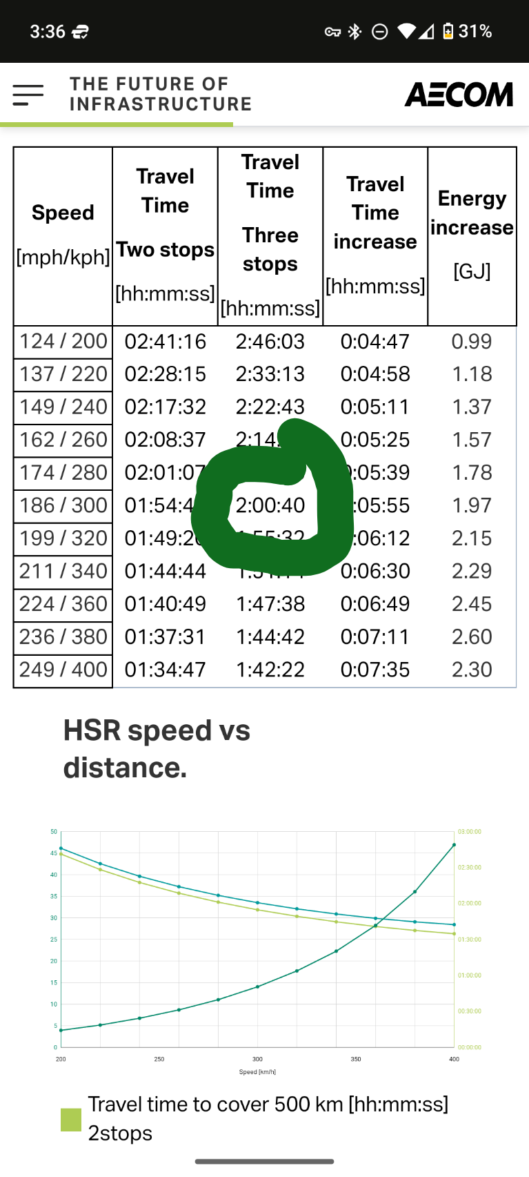

Taking my targets from the AECOM report I linked.
They claim a 500 km journey, with three stops (YEG, RD, YYC) can be done in 2 hours at 300kph.
As the Edm/Cal city centers are closer to 300 km apart, the journey should be doable in ~1.25 hours.
So maybe DT to DT in an hour is a stretch, but airport to airport in hour seems reasonable.

Downtown to downtown in an hour isn't just a stretch. It requires instant acceleration to top speed and zero stops. The graph you provide is optimistic because it assumes perfect track engineering with no need to ever slow for a turn, while getting from downtown Calgary to the edge of Calgary will require lower speed operations unless the builder is going to SimCity Bulldozer a corridor through Calgary and you don't care about noise pollution. Ditto the edge of Red Deer to downtown Red Deer. Ditto the edge of Edmonton to downtown Edmonton. And then there's topography to contend with because the corridor is not anywhere near as stereotypically flat as some people think it is.
If you scroll down past that chart, the article authors actually get into some of the variables that limit ability to operate at top speed.
Back in the 2008 study, the more realistic travel time put forth was 1:35 for a 320 km/h TGV type HSR, while 1 hour would require a then prototype Siemens maglev with a top speed of 480 km/h.

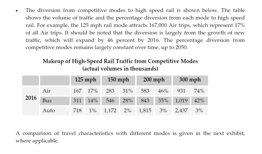

A report created in Canada in the 21st century referencing everything in MPH?
Into the trash it goes...
That said, this table stood out before I clicked x.
Anything less than the fastest option doesn't displace enough intercity air traffic, and if you aren't taking that off the table, then there's no point in bothering at all.
As to your concern trolling on routes and noise, seriously have no idea what you're on about..
In Calgary nose creek is wide open and ready to go, no bulldozing needed.
Ditto in red deer, where the station is anticipated to be on the west side of hwy 2 near the college. Again, wide open there.
And the direct route into Edmonton via the gateway corridor deserves to be bulldozed, we should welcome any pretext to do so with open arms!
But don't let any of that stop you from believing things can't be done. :)
