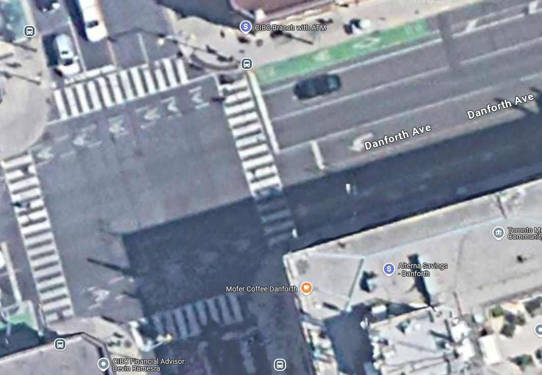

ie. The Danforth/Coxwell intersection:
Note the absence of parking right at the intersection, with a left hand turn lane and a right hand turn lane absorbing most of that space.
But there is no scenario where the left turn lane is removed. The space in the ROW btw the two Cycle Tracks is only 10.0M - 2.5M for the left turn lane and you have only 7.5M You're not getting 4 vehicle lanes squeeze in there.
There is no room here to add one vehicle lane per direction without removing the cycle tracks entirely.

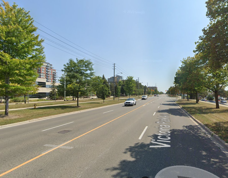

Example: (Victoria Park just south of Steeles); here there is sufficient space available between the surplus boulevard and existing vehicle lane widths to allow for cycle tracks and retaining current vehicle lanes.
Above there is roughly 1M per direction available by lane narrowing and a further 2M in each boulevard without causing undue harm to existing trees.

Remember in the example I afforded above, at Danforth/Coxwell, if you keep the left-turn lane, you'd have only 7.5M available across 4 vehicle lanes, that's 1.87M per lane.
Edit to add, important to remember that intersection capacity is key to any analysis.
Those are almost always the most constrained parts of the ROW w/the most demand.

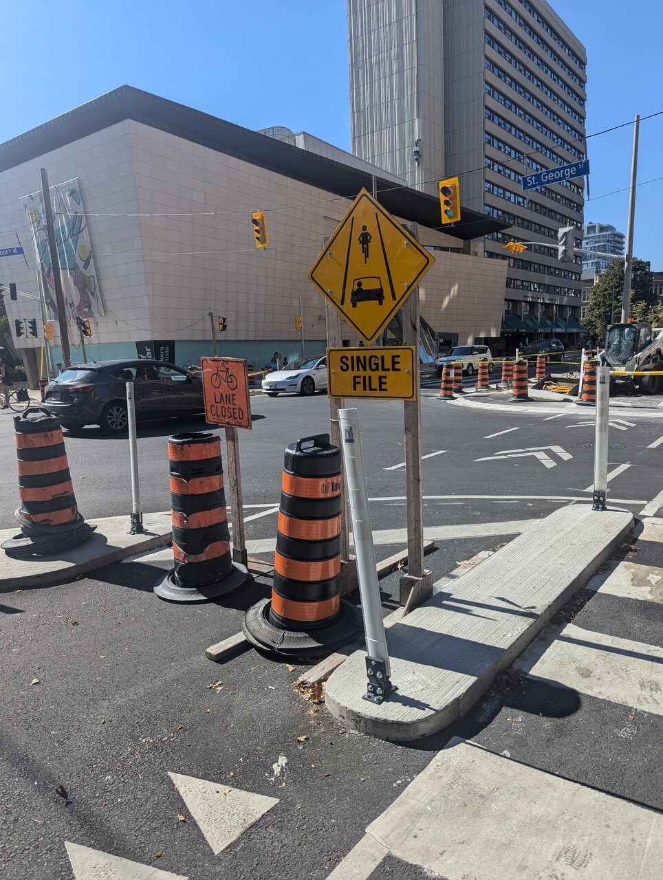

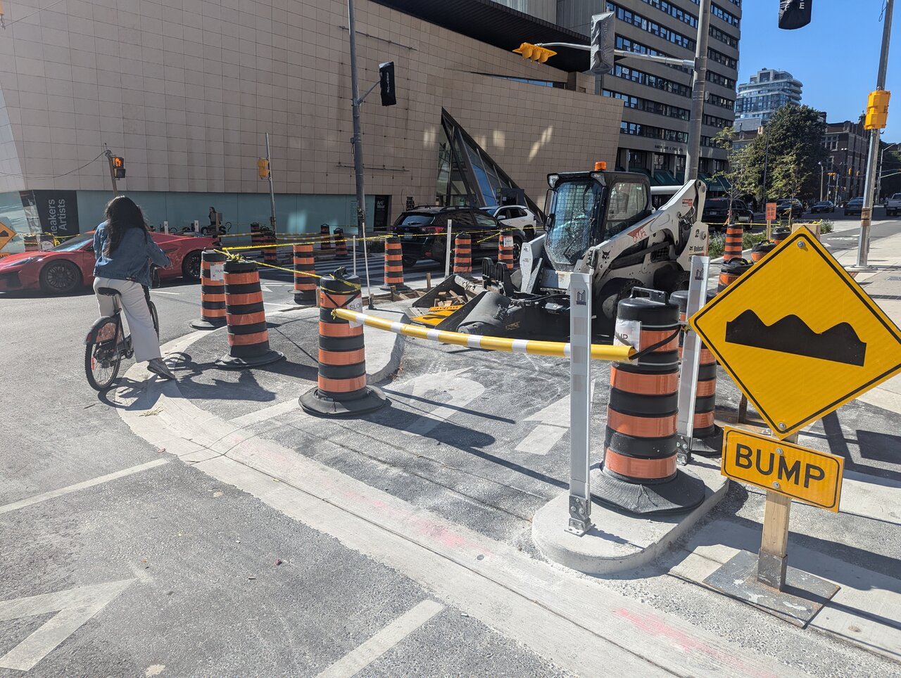

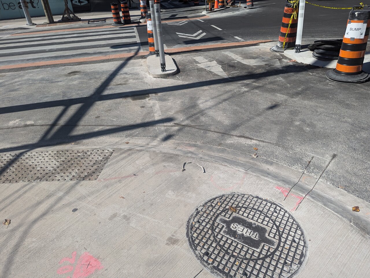

At Bloor and St. George today the concrete edge has been replaced at the SW and SE corner. It's now orange and at least visually looks less hazardous. However the asphalt patching looks very rough in places, and there are random cuts in the sidewalk and the asphalt with a some sort of concrete saw for no obvious reason. The NW corner is just closed off for bicycles, at least there is a "single file" sign.
Unfortunate situation with all the rework needed for what I felt was supposed to be the pinnacle of bicycle infrastructure in Toronto. I really wish they replace the bike lanes asphalt fullly, and not just leave asphalt patches there.
Well I was pleasantly surprised today, the asphalt patch job was replaced with nicely poured brand new asphalt 😀.
