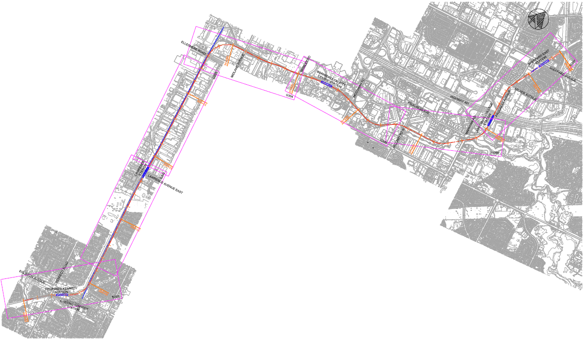

So is the surface alignment still a possibility? I get that city council voted on the single station McCowan route, but is that more of a temporary formality? TTM linked the 2013 Surface Feasibility Study to me earlier, and I feel like it wasn't brought up in any debate. It's a bit wonky, but perhaps it would offer the compromise people want: relative affordability and a subway.
In Early 2016 council directed TTC to study the surface alignment. The TTC studied a hook shaped alignment, where the extension would travel east from Kennedy and then travel northwest to the existing SRT corridor. The TTC determined this was not desirable due to high costs (almost as high as McCowan alignment) and added travel time.
But this is not the alignment that Metrolinx studied and determined was possible. I don't know why they didn't study the Metrolinx alignment.
I can't know for sure, but my one guess is this: the Metrolinx alignment requires a new Kennedy station. The existing station structure would have to be either completely abandoned, or used for emergencies / diversions only. That would be a very visible "waste" for people who are not familiar with the technical details of this project but evaluate the TTC's work from the formal perspective.
Thus, they might look better if they build a more expensive route and spend more money overall, but do not abandon the existing structure.

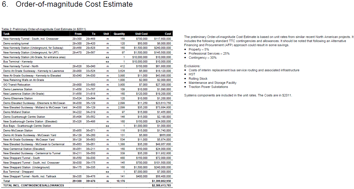

*Looking over the costs chart, take notice of the difference between the elevated station and underground station. $24,000,000 vs $240,000,000...ten times more! That's unreal. Hopefully people read that number and get why there are supporters of using elevated rail for subway expansion.
Should be noted that this pricing does not include the price of vehicles. The SRT alignment would require significantly more vehicles than the McCowan alignment, which erases a lot of the cost savings of the SRT alignment. However the cost escalations of the McCowan alignment likely still mean that the SRT corridor would be cheaper. And personally, even in a case where both alignments would cost the same, I'd opt for the longer SRT alignment with five stations between Sheppard and Kennedy, vs McCowan alignment's one station.

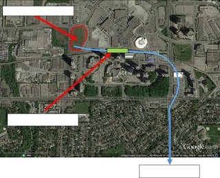

Some questions.
"Big Bend" What's that point of going all the way to McCowan and then turning back. If you want the station where the current one is, why not Brimley or Midland and reduce rather than increasing the length? How do you pay for the extra cost of running buses, since you'd have to demolish the last two stations of the SRT to build the subway station?
