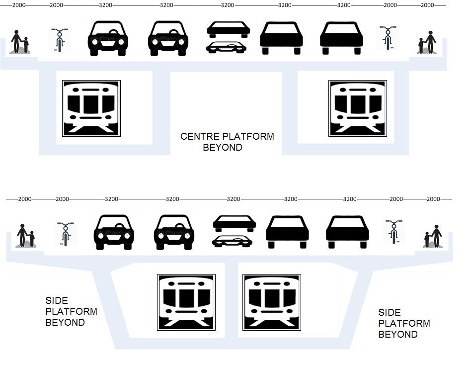

This would require 3.5% grades* south of Lawrence to go from the portal to elevated in the short 200m distance**. There then needs to be a vertical curve transition from 3.5% to horizontal for the station, and then another transition to 3.5% down grade to make it underground before St. Andrews. All this time, the terrain is dropping down as you head north (i.e. more of the flood plain is to the north) making it even harder to get underground before St. Andrews.
It's because of this terrain that I think you can still be underground at Lawrence and have a new subway with McCowan on top that essentially spans the Highland creek at a higher elevation (instead of the road and subway dropping to cross the valley on a short bridge, have them cross at a higher elevation).
Overall, I agree with your idea that station options for a low level station was not properly considered.
* - The Murray plan of using the SRT corridor had these grades and TTC really didn't like it.
** - It would also block off all access to the strip mall from McCowan. Then entrances would have to be change to Perivale and Lawrence only.
The station would be roughly from the south edge of Lawrence towards the existing hospital entrance. The subway would run inside the bridge, meaning that the bridge depth would be 4.5 to 5m (due to the subway height inside). This 4.5m depth bridge can easily span 80m (while the existing bridge has a 30m span). The new bridge would have similar soffit elevation to the current bridge, with the south abutment about 10m or 15m south of existing, and the north abutment about 30m to 40m north of the existing. This extra span should allow passage of the Regional storm under the bridge.
The new hospital entrance from McCowan would be elevated (or perched) and about 15m to 20m south of the existing. I see a small utility building (red brick) that would have to be relocated. Here's how the bridge would look. Access to the centre plaform (or farside platform) would be through a "mezzanine" underneath the platform.

I don't mind at all. There are options that should be at least explored.
