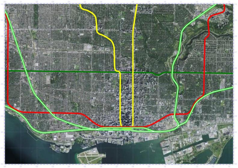

Ok, so I did a concept map for this. My thinking behind this is that Metrolinx is clearly saying that GO service is going to require some sort of separate tunnel in order to handle capacity. The DRL is also needed, there's no way around that. So, why not combine the GO tunnel into a DRL tunnel for at least part of it?
The DRL would run straight down Keele/Parkside to the Queensway, where it would turn under Queen. It would then veer south just west of Bathurst towards the rail tracks. It would meet up with the Lakeshore line and go in a 4-tracked tunnel under Wellington until about Church, where the GO line would veer south and the DRL would gradually veer north back towards Queen. From there the DRL is the standard alignment shown in just about every DRL map there is.
While a 4-tracked tunnel would be more expensive, it would still be cheaper than tunnelling 2 separate lines in 2 different spots. It also creates two separate yet linked transportation hubs in downtown. One under Wellington and Bay, and one at Union.
This set-up also allows any GO line to either be routed into the tunnel, or continue into Union. Flexibility is a good thing.
Comments?

hmm 5A-2 with a tunnelled go just seems so RER-ish... it would actually work quite well. I just wonder if GO would need to get rid of the double deckers to run in a tunnel.

The main things I'm wondering about is:
Are 2 tracks enough to handle all of Lakeshore East/West GO traffic (especially near the station)?
Is there enough space at Wellington and Bay for a transit terminal the size of Union Station?
Will there be foundations of buildings in the way as the Lakeshore and DRL lines cross over to Wellington?
But if those don't wind up being problems, then I think it's a good idea.

While I like the concept, I am not sure how feasible it is..
First, I am not sure about what the clearances are to bring the heavy rail corridor up to Wellington from Bathurst.
Second, most rail tunnels these days are individually bored. That fact coupled with the cost of land purchase and utility relocation outside of the rail corridor would not really make a combined rail tunnel for both DRL all that less expensive.
Third, is there even room for a full rail station underground in the vicinity of Bay/Wellington? What would happen when the system requires expansion?

All very good questions. I don't know the answer to all of them, but I do have some ideas on how to solve some of them.
What I envision for the Wellington tunnel is, at least until about Spadina, you can cut and cover Wellington. In the grand scheme of things, it's a pretty minor street. No streetcars, not even any bus routes as far as I know (and if there are, none that can't be diverted). Dig the street up, do a double stacked tunnel with the DRL on the top and GO on the bottom.
East of Spadina, it will be a pretty big engineering challenge, no doubt about that. The station at Bay and Wellington may need to be double stacked. However, these are very similar problems that would be encountered with Metrolinx' proposal of the "Second Union" south of the current one.
In order to ensure adequate capacity, I would make both stations 3 platform stations (wait on the outside, exit on the inside).
Not saying it won't be difficult, but any of the options going into downtown will be.

If they build the LakeShore tunnel by cut & cover then then could keep their double-deck trains. It would be a massive disruption, so I doubt they can do this politically.
See that hole on Front? Now imagine it stretching from Bathurst to Cherry and being twice the width.
All this talk of tunneling GO lines makes me think it would just be easier and cheaper to build a second train level to the Union station train shed.
As for the DRL, clearances are tight downtown, not just for the tracks, but for the stations, having to negotiate all the building foundations. Perhaps running the eastbound and westbound tunnels under separate streets would also be a cheaper and easier option. I'd prefer Eastbound under Wellington, westbound under King. Distances between the two streets are negligable, and with the TTC moving to timed transfers, you may not even need a fare-paid connection between the two.

I agree with the Westbound DRL going on King, but what is it about Wellington that makes it worthwhile complicating things (even if only a little) instead of just continuing on King Eastbound?
