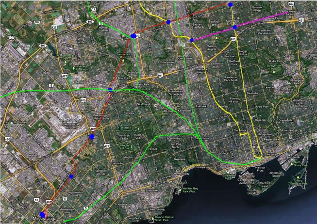

Another point in all this reading is...Is there no way to push employment to North York Centre? I personally would love to see Mississauga City Centre explode but we know with zero rapid transit links it won't happen for a while. But NYCC is ready for employment! Why isn't the city pushing employment there?
Would a development freeze on Downtown be bad for the economy? Would it not be cheaper to push more jobs to NYCC than pay for these multi billion dollar GO Train tunnels?
Also, wouldn't a GO Crosstown line along the Finch Hydro-Corridor be of help in making NYCC a great big employment Hub? Essentially Finch would become like Union Station North. You could have a line from Square One use the existing transitway and then follow the hydro corridor diagonally up to Finch Station. That would create an express line between NYCC and MCC. Can you imagine a quick 15-20 minute ride from MCC to NYCC? That would really attract employers in my opinion. An interchange station @ Etobicoke North would be great!
NYCC has potential as an employment hub, and deserves support. But it will be long time before it can rival downtown.
Generally speaking, the economy dislikes the government meddling and tends to react in a way that defeats the purpose of such meddling. I suspect that an artificial freeze on the downtown employment growth will push a great deal of new jobs outside Toronto / GTA / Ontario / Canada. Some of jobs will remain in GTA but will be pushed into office parks with terrible transit service and nearly 100% of employees driving to work. Only some will be relocated to new transit-frendly employment hubs such as NYCC.
That's an interesting idea, but I suspect that the residents will give the City Council or even the Queen's Park a very hard time if Metrolinx attempts to build heavy rail service in that corridor. Hydro One might not be particularly impressed, either.
