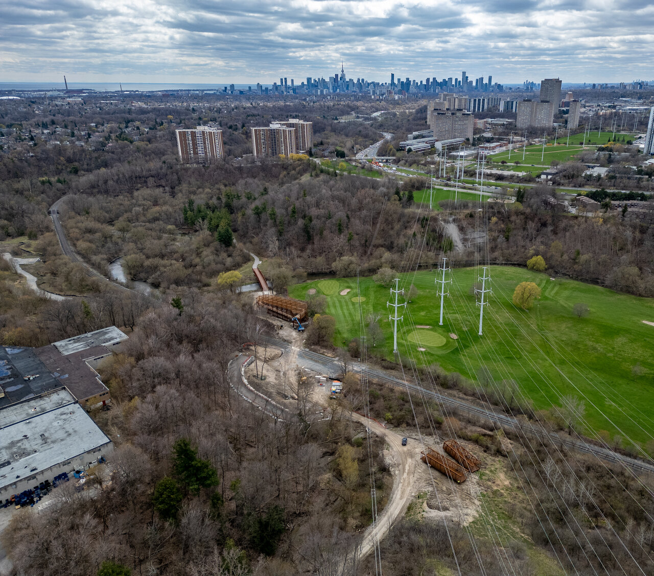

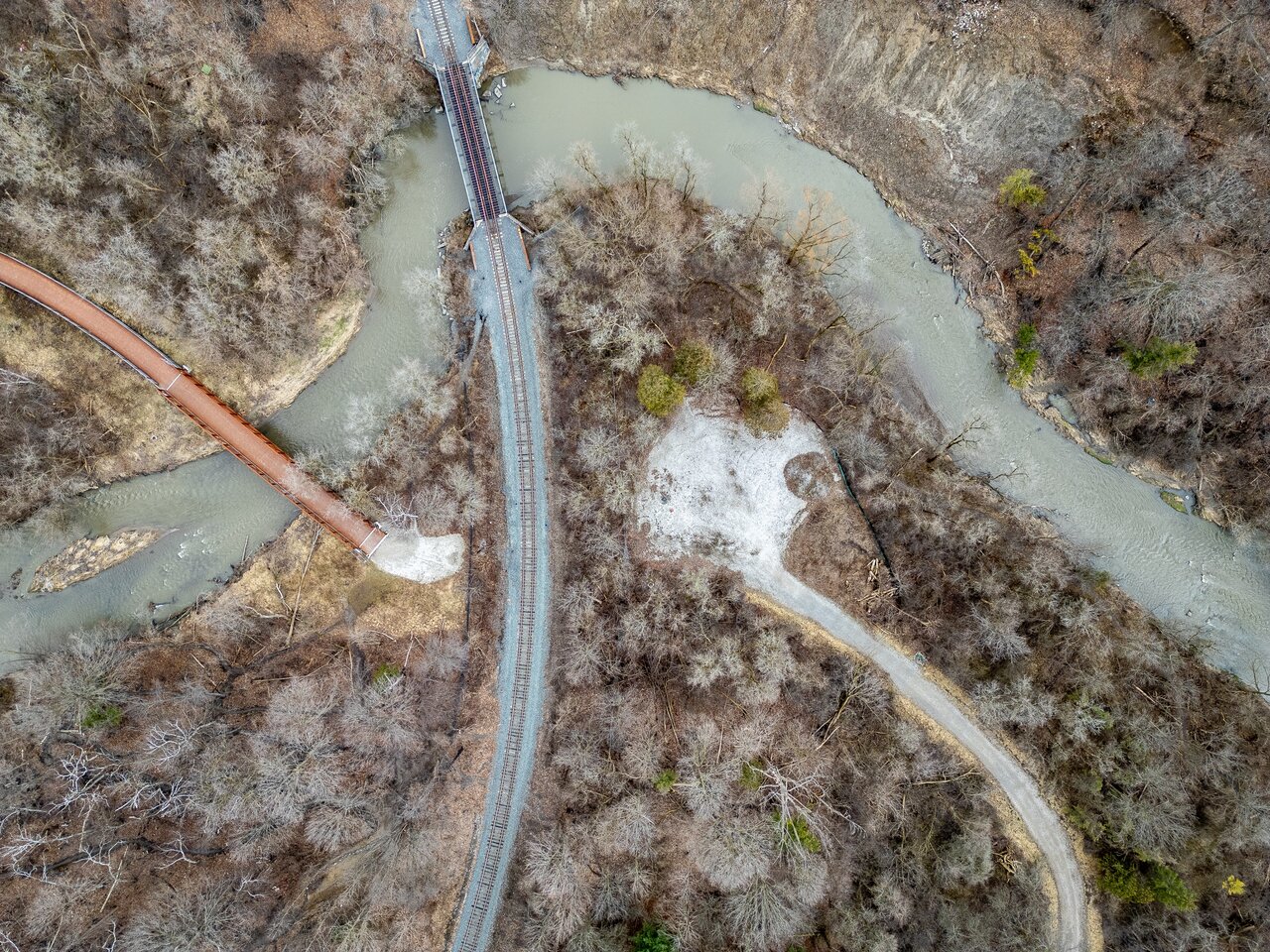

The geography in that area is all wrong for what you propose.
The trail is just above the river level, and the tracks sit another 15 to 20 feet higher than that.
To make it a straight ramp up and over the tracks (plus their own clearances), and still maintain an appropriate grade, you would have had to start from the previous bridge over the river.
Thinking about those grades now, all of a sudden an overpass makes sense here. A tunnel under the tracks would have put the floor just above the spring water line - it would have made it a potential target for scour and erosion.

What are your thoughts on the crossing to the south? It's to be a tunnel.

It almost looks like one of the contributing factors of this odd design is a requirement to put a cage around the sides that face the golf course (I can see what looks like a cage on the roof and side facing the golf course, but not the opposite side)
It looks like this will be the last significant section to be completed and unfortunately work has not yet started.
Yes, this one is to be a tunnel. But as it is located towards the inside of a river bend (and past the outside of the previous), I guess that the situation there when it comes to flooding is less dire than the one upstream. That's just my intuition however - there are others out there far better versed in this kind of thing than I that will know for certain.
There is to be a full-weekend closure of the line at some point in order to cut the embankment that the track sits on, excavate it, install the tunnel sections, backfill and reinstall the track. I believe that this is currently scheduled for a weekend in May, but I need to verify this.
There is also a tunnel a mere 100 metres or so north of the level crossing, making the crossing if not redundant then only a small added convenience for a moderately small number of people.
