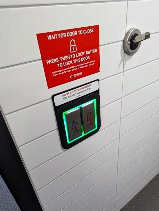

The use of vestibules can also be an issue. Can a person in a wheelchair open both door without having to readjust in the space.
The new accessable updates at St Albert city hall also have large buttons and foot controllers as well.
