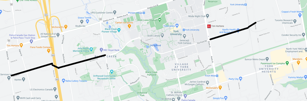

The object is one new E-W road that crosses over/under highway 400 and the GO Barrie line.
It has to reach from west of 400 to Dufferin in the east in order to alleviate the E-W congestion on Steeles.
This is likely the most practical solution; it requires the least new land and very few building removals.
But York U would likely hate it for all the through traffic it would bring.

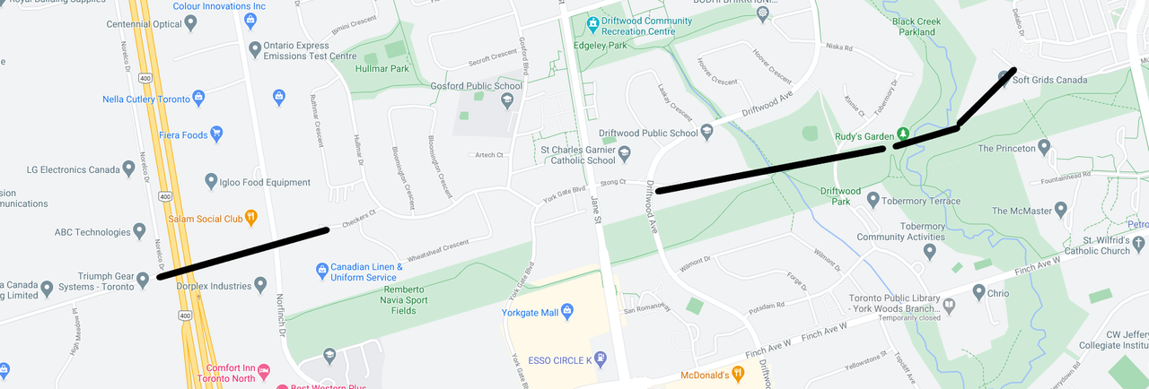

An alternative would use the existing York U busway corridor in the hydro corridor as a regular street, using the existing infra from Dufferin to Keele, then connect to Murray Ross Parkway.
The challenge is how to get it intelligently west of there.
The further west bit is straight forward. But the road pattern to Jane is just silly.
East of that, to make the connection you need to get across Black Creek.
I have tentatively shown a connection via the hydro corridor as its the least damaging and most efficient route.
However, it divides Driftwood park and would requires the demolition of some homes.

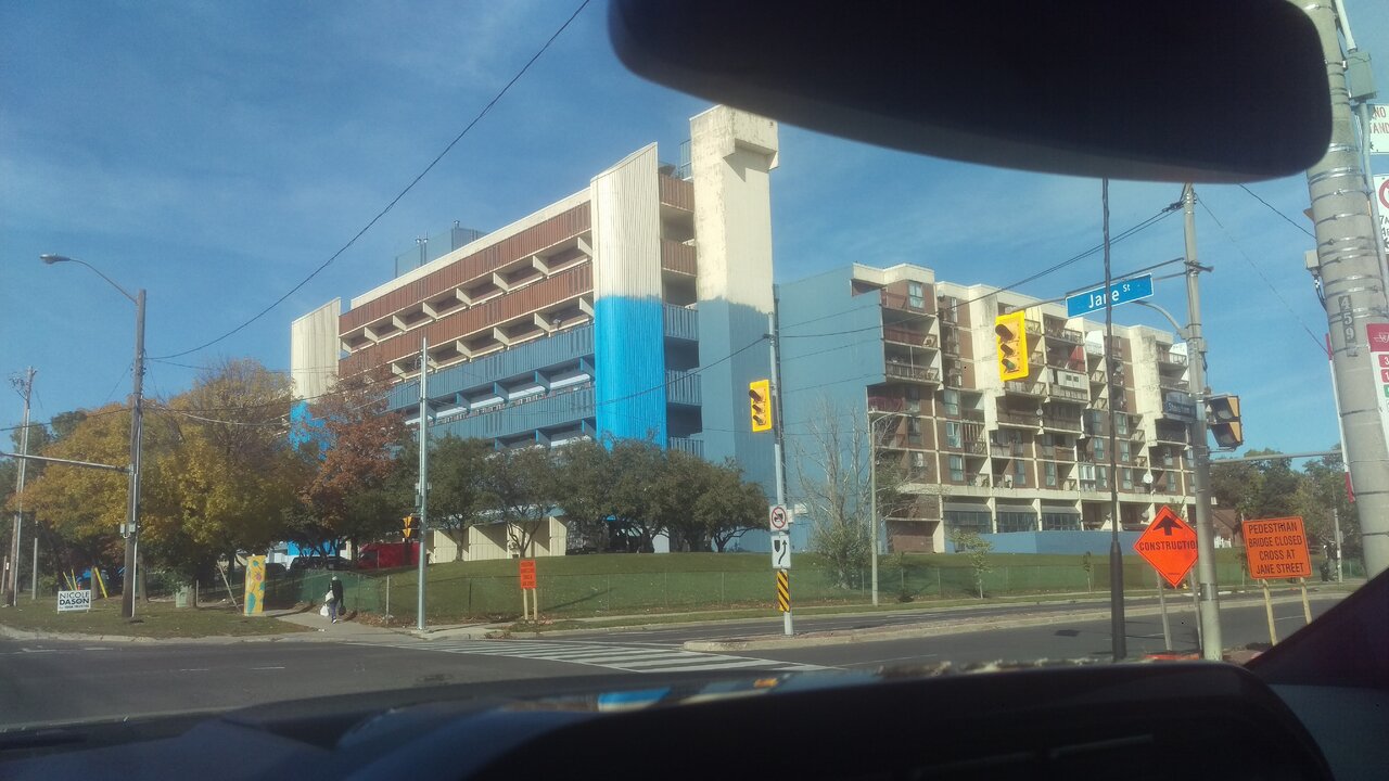

Was a bit shocked to see that they are painting the buildings near jane and steeles quite a bright blue
