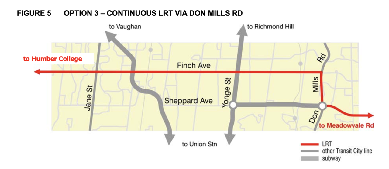

For ease of continued trips east and regional connectivity benefits, yes there is a advantage - in fact, Metrolinx tested a few options in the early 2010s as part of the Planning process - including a continuous LRT to Don Mills, LRT to Shepard-Yonge, extension of the subway to (then) Downsview etc.
However, the Environmental Assessment (links down the page) for the line has the line as far as Yonge St (Finch Station) - much easier to build this "approved" line.
Any other extension options east such as a LRT extension to Sheppard-Yonge, or a subway extension to Sheppard West (don't be surprised if some councillors try to push that instead :rolleyes:) would require an EA.
The extension east to Yonge is not even being considered, yet the EA has already been done.
That would take away passengers from the Sheppard West extension business case so I would expect them to not even approach that extension as long as Sheppard West is still considered "in plan".

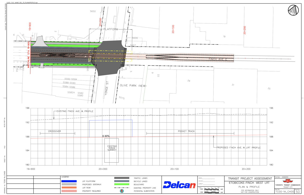

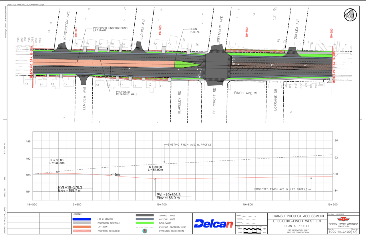

As for Finch LRT, Finch/Yonge station never made it past the concept stage. All they want is an underground connection. How deep and how it would connect to the existing Finch Station subway station was never shown officially.
This is not the case - as mentioned, the EA documents clearly shows how the route would reach Finch. The station would be built above the subway tunnel, below Finch Ave.
