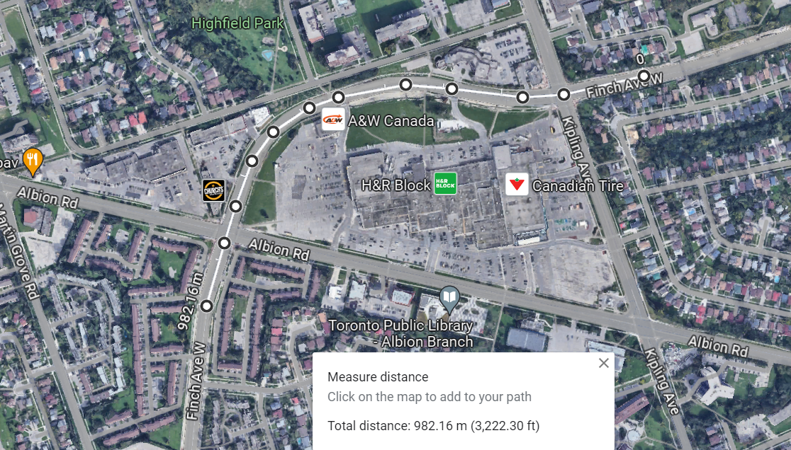

So, I haven't drawn any conclusions as I type this first line; but I will look at the map, to see if I can discern why the stops you note above were inserted, and what impact, if any, is obvious.
Stevenson:

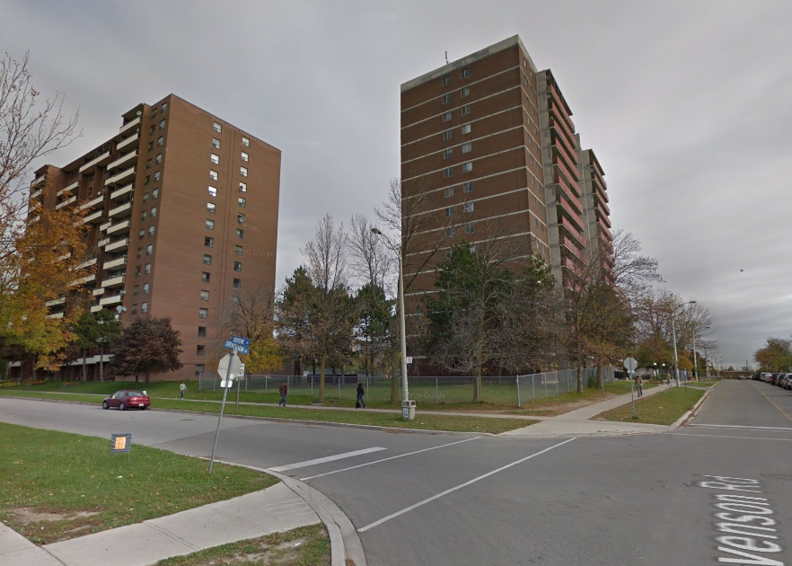

Chosen likely for 3 factors, the mall to the south, but this, as noted prior is served by 2 other stops.
But the stop also directly serves these 2 residential towers:
It also serves a Junior High just up the street that is ~290M from Finch.
So the impact of removing the stop is taking the distance for the residential ~ 25M and the Junior High and considering the distance w/o that stop.
Distance to Kipling : ~710M (school); 430M for apartments.
Distance to Albion: ~560M (school); 332M for apartments.
I think there's a reasonable case for removal here, the primary impact is on the middle school which is material, but likely represents a fairly low portion of any potential ridership.

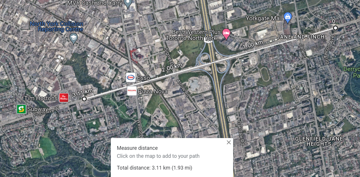

Now lets' look at Driftwood:
Serves the east end of the Jane Finch Mall.
The only significant density currently is San Romanoiway which is under 300M to the Jane-Finch intersection.
There is the vast proposed densification of the Jane-Finch Mall site to consider here; where I would note, I have proposed moving Driftwood closer to Jane, which definitively remove any justification for a stop.
The only knocks on removal here are:
Removes a connecting bus route and stop, creating a walking transfer.
Also, with future density, I don't believe the current platform design at Jane would carry sufficient capacity. (there is, however, room, for now, to widen those platforms, albeit with some expensive changes to curbs/roads/streetscape etc.
I think I'll leave it there for now.

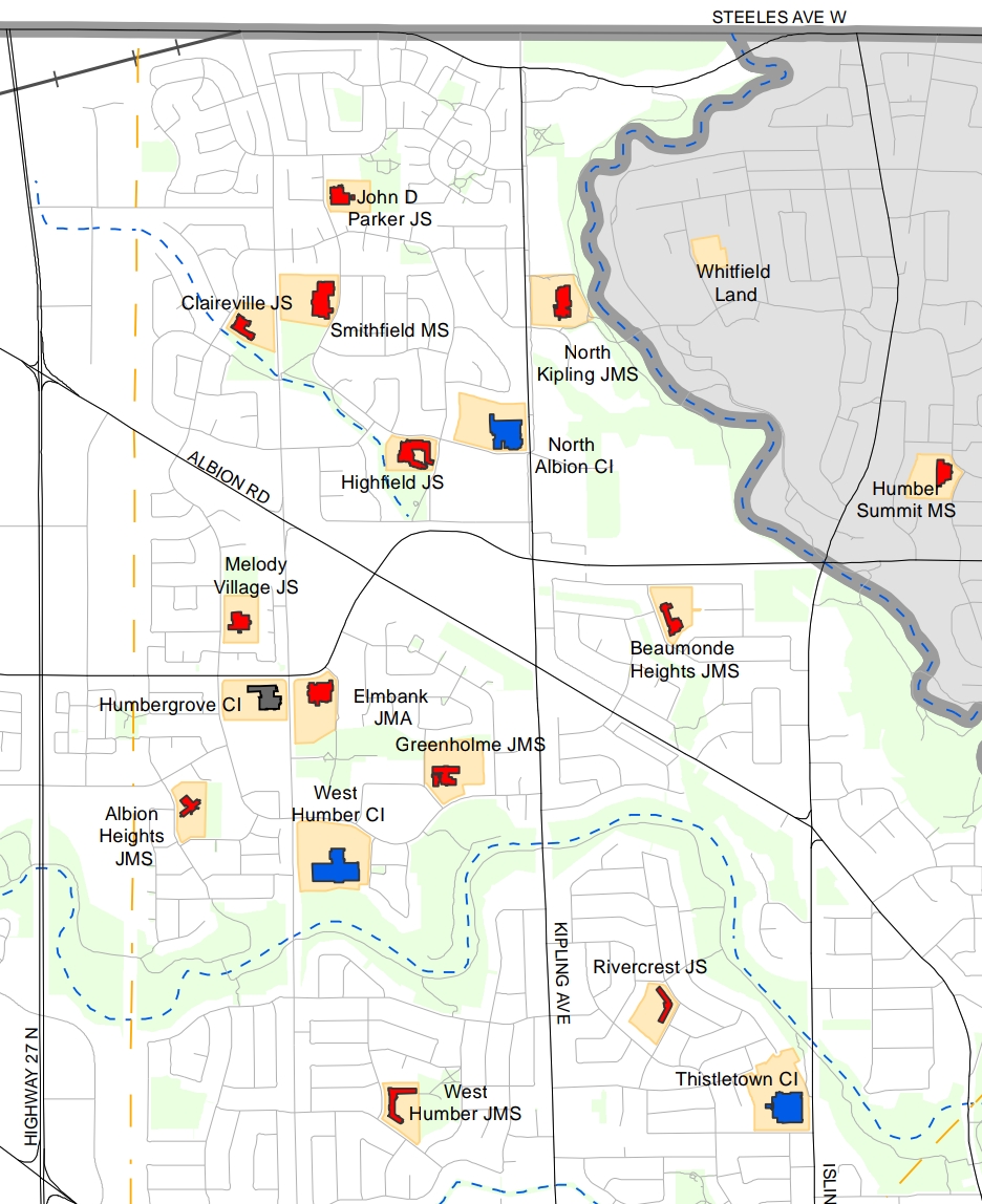

The one question I have to you is what is the transit modeshare for that junior high? Do grade 7s and 8s really take public transit that often because I typically I associate transit use with full on high school students.

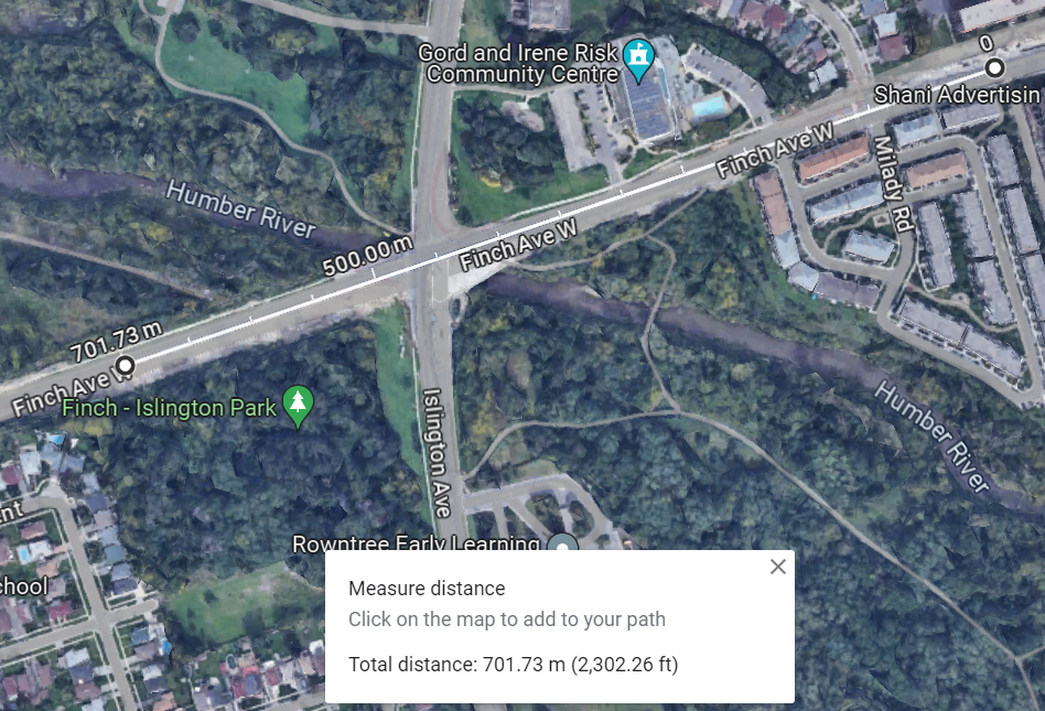

1. LRT should have resurfaced after passing Romfield Lane. It would allow the LRT to bypass traffic lights and avoid unnecessary delays. From here the LRT would run surface level to serve the local community,
2. The next big and expensive change would be to remove the Driftwood Ave stop and bury the Finch West LRT between Jane and Weston. The LRT could have entered a trench before driftwood to avoid that traffic light. My logic here is Finch West during rush hour is packed with cars and having the train run surface level here increases the chances of delays due to traffic and accidents. If the LRT ran unground in this section the trains could travel fast. The stops would remain the same with stops at Jane, Norfinch/ Oakdale, Signet/ Arrow, and Weston. The LRT could have resurfaced after passing Jayzel Dr, avoiding another traffic light, and run surface level to serve the local community.
3. Now for a smaller change I would have removed the stop at Duncunwoods Dr.
4. After passing through Pearldale Ave. the LRT could have gone through an above-ground section with an above-ground station at Islington. Between Islington and Kipling the lrt would run along the surface
4. lastly the LRT would go below grade between Kipling and Albion to avoid those busy intersections. It could have been built similarly to the Mississauga Transitway to keep costs down. Also, Stevenson station would be removed. After Albion, the LRT would resurface and run above ground.
My logic overall is the LRT would run separately at busy intersections, but serve more local trips between the major intersections. You would get both speed and convenience. hopefully satisfying both parties in this debate.

So, Highfield Junior School is a K to 5 school with just under 600 students. Considering the proximity of other junior schools (elementary), the catchement area must be small.

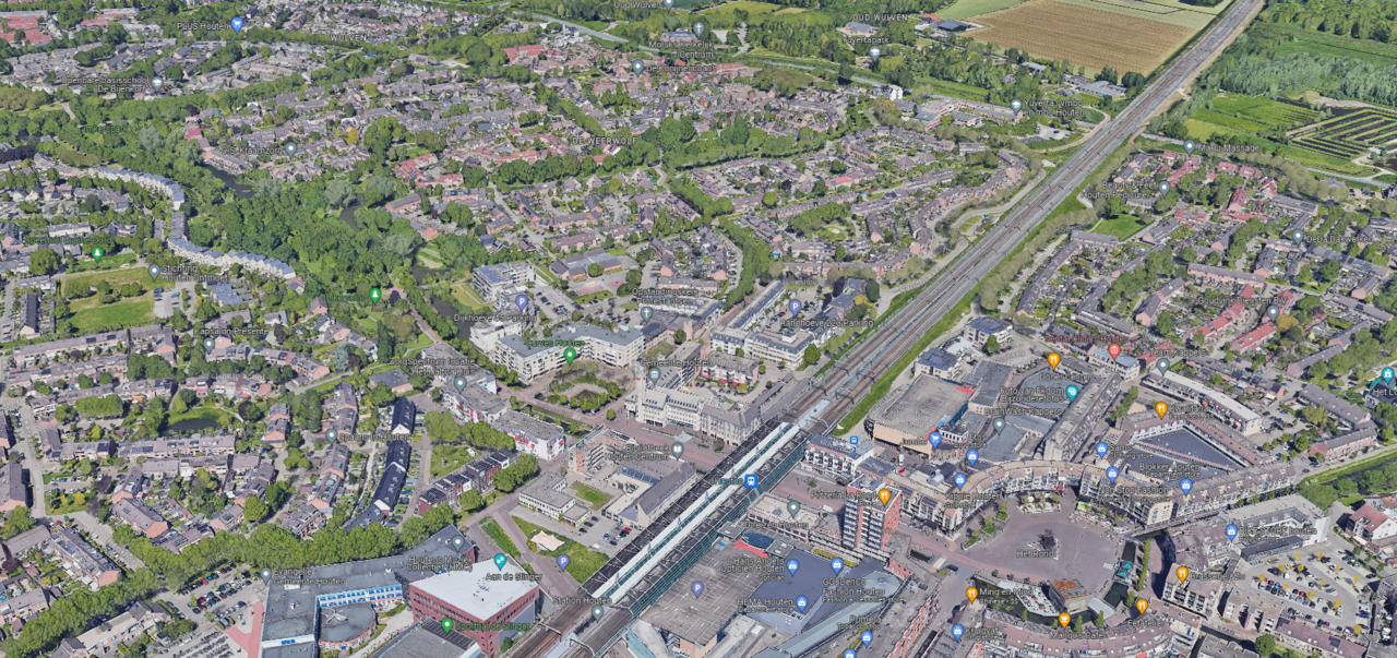

Personally, I find the streetcar suburbs too dense. They're not intended to host the numbers of cars they do today. I find the street parking and lack of garages really make those areas feel cramped as people are forced to store their cars curbside.
Overall, I don't think this to be the case; I find much to like about 'The Beach' or 'High Park/Roncy' or 'Leslieville' or Parkdale.
Many properties have decently deep lots and either large front or good sized backyards; many have laneway garages, but people either prefer parking out front, or that's where the 'second car' goes.
I accept that the on-street parking is both excessive, and problematic, if you actually need a space as a visitor to the area (or resident). I don't think this requires less density. It requires vastly more carsharing, which can be achieved simply by increasing the number of 'floating' permits; as well as reducing the cost for an on-street, reserved carshare space to the same as any other permit holder (instead of more than 15x the price).
It also requires that parking permits be more expensive. The entry level permit is $21.32 per month; even though, tenants in multi-res buildings routinely pay $70 or more for a space.
While the max permit (for residents with enough spaces for 2 or more vehicles on their property is still only $86.29 a month, when a market priced, reserved space would cost no less than $100, and possibly double that.
If we set the entry level permit at $70, and the permit where you have space on your property to park at $105 per month, there would be far less street parking demand. On major streets, this could be taken up as a boulevard separating a cycling track from a road. On side streets, it could allow for reserved spaces for movers and deliveries, and some additional streetscaping that could bookend those spaces; all the while providing more parking for those who need (and are willing to pay) for it.
We can also create more walkable grocery shopping simply by capping store sizes at 30,000ft2. In the east end of the old City (Danforth to the Lake, The Don to VP) this would force Loblaws and Metro to essentially divide 3 large stores into 2 smaller ones, which would bring grocery much closer to home.
Some modest transit improvements would do wonders to; The Ontario Line will accomplish much, but right now, frequent N-S bus services don't exist from Pape/Carlaw to Coxwell. That's a large gap; the moment the Greenwood and Jones based buses go to 10M service or better from 6am-10:30pm; M-Sat; and 8am-10:30 Sundays, you'd see lower interest in 2-car houses in particular.
The 'streetcar suburb' for the purpose of talking about better suburban typology isn't some huge idea, its just narrower lots, rear laneway garages, and planning for mostly 1-car households, closer shopping, more mature trees, and better transit.
NL, I'm not making some objective statement. I'm just saying I wouldn't want to live in those areas because of the way they subjectively occur to me.
Honestly just mandate partial WFH to be the default unless a company can prove they need people in. I know this doesn't apply to every single job but it would really help.
Everyone here sees suburbs/sprawl as bad but nobody seems to care why someone is willing to drive from Barrie or Oshawa every day. Some people don't want dense housing. Personally I only have bad experiences in shared housing and if I had kids I would want them to have a backyard!
I'm not sure the backyard is a problem, it's the 5 cars in the driveway.
There are places that manage to have mostly low-rise housing, pretty high density, transit-oriented development where active transport is a huge part of the way people get around the community.
