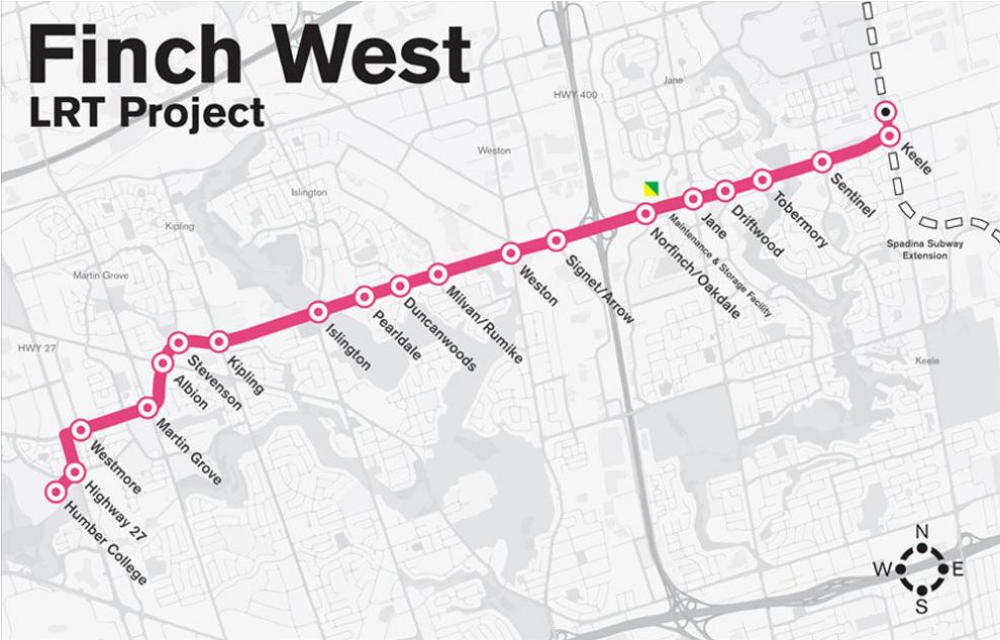

How about we take some of the passion out of this discussion, on both sides, and instead do the deep dive together on stop spacing.
Let's begin by looking at the stops as they are; the distance between each.
Source: https://www.toronto.com/news/7-fact...le_5895fc61-41cf-5952-acdd-98b585a503e5.html?
I will show this as stop name, distance, next stop name
* Note, I am not going to nitpick farside/nearside stops, as that is time I don't have, I'll go intersection to intersection on centre.
In (Brackets), the distance btw 2 stops if that one is removed. (does not apply to Terminals, obviously)
Finally, I have marked each stop that crosses a TTC bus connection with a T
Keele T
750M
Sentinel (1.4km) T
667M
Tobermory (1.1.km)
454M
Driftwood (807M) T
353M
Jane (801M) T
548M
Norfinch (1.5km) T
1km
Signet (1.5km) T
501M
Weston (1.3km) T
825M
Milvan (1.3km) T
451M
Duncan Woods (853M)
402M
Pearldale (930M)
528M
Islington (1.4km) T
1.1KM
Kipling (1.5km) T
420M
Stevenson (696M)
276M
Albion (836M) T
560M
Martin Grove (1.35km) T
788M
Westmore (988M) T
200M
Highway 27 (900M)
~700M
Humber College
There are other considerations than the above; including:
Distance to nearest trip generator/distance if stop removed from same
Distance from high density residential node, and same if stop removed.
Major barrier between stops such as steep hills/valleys, or unpleasantness of crossing a major highway interchange.
Have at it everyone, play nicely.

I've talked with quite a few people about this, and in general we came to one general conclusion.
1) Stevenson should be cut
2) Driftwood as well
3) Out of Milvan, Pearldale, and Duncanwood, choose 2/3 (Probably Milvan and Pearldale).
Its worth noting however that the map is outdated, as I'm pretty sure they nixed the stop at Highway 27 long ago,
So, I haven't drawn any conclusions as I type this first line; but I will look at the map, to see if I can discern why the stops you note above were inserted, and what impact, if any, is obvious.

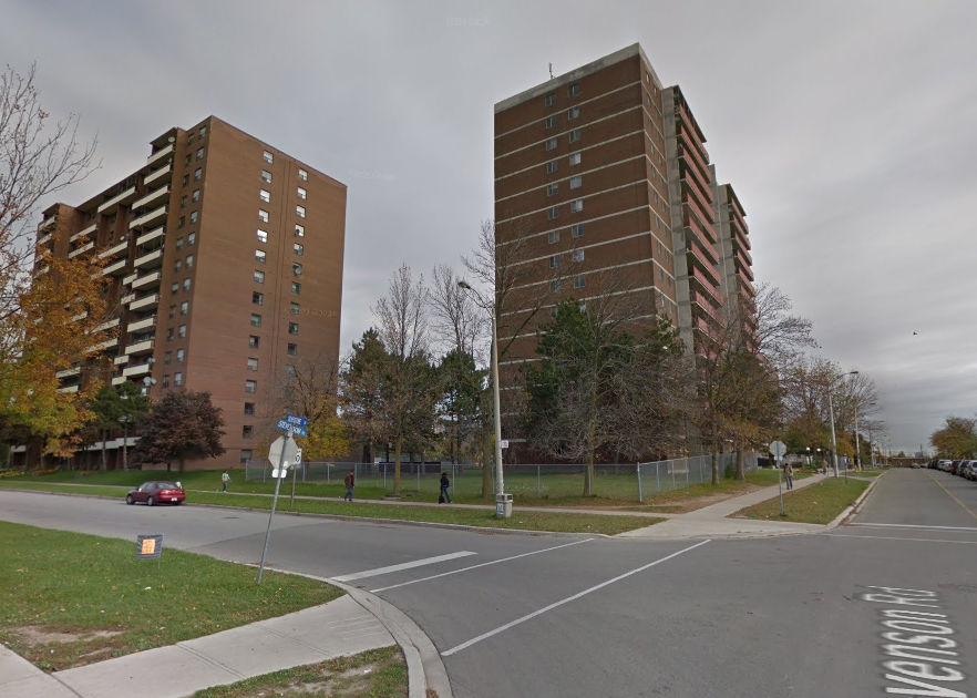

Stevenson:
Chosen likely for 3 factors, the mall to the south, but this, as noted prior is served by 2 other stops.
But the stop also directly serves these 2 residential towers:
It also serves a Junior High just up the street that is ~290M from Finch.
So the impact of removing the stop is taking the distance for the residential ~ 25M and the Junior High and considering the distance w/o that stop.
Distance to Kipling : ~710M (school); 430M for apartments.
Distance to Albion: ~560M (school); 332M for apartments.
I think there's a reasonable case for removal here, the primary impact is on the middle school which is material, but likely represents a fairly low portion of any potential ridership.

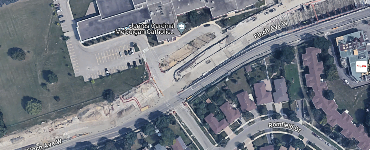

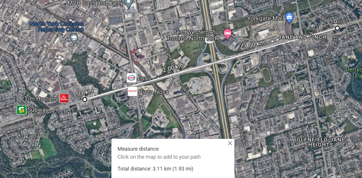

If we had unlimited money there could have been a better way to design the Finch West LRT which would have improved speed but still serve the local community.
1. LRT should have resurfaced after passing Romfield Lane. It would allow the LRT to bypass traffic lights and avoid unnecessary delays. From here the LRT would run surface level to serve the local community,
2. The next big and expensive change would be to remove the Driftwood Ave stop and bury the Finch West LRT between Jane and Weston. The LRT could have entered a trench before driftwood to avoid that traffic light. My logic here is Finch West during rush hour is packed with cars and having the train run surface level here increases the chances of delays due to traffic and accidents. If the LRT ran unground in this section the trains could travel fast. The stops would remain the same with stops at Jane, Norfinch/ Oakdale, Signet/ Arrow, and Weston. The LRT could have resurfaced after passing Jayzel Dr, avoiding another traffic light, and run surface level to serve the local community.

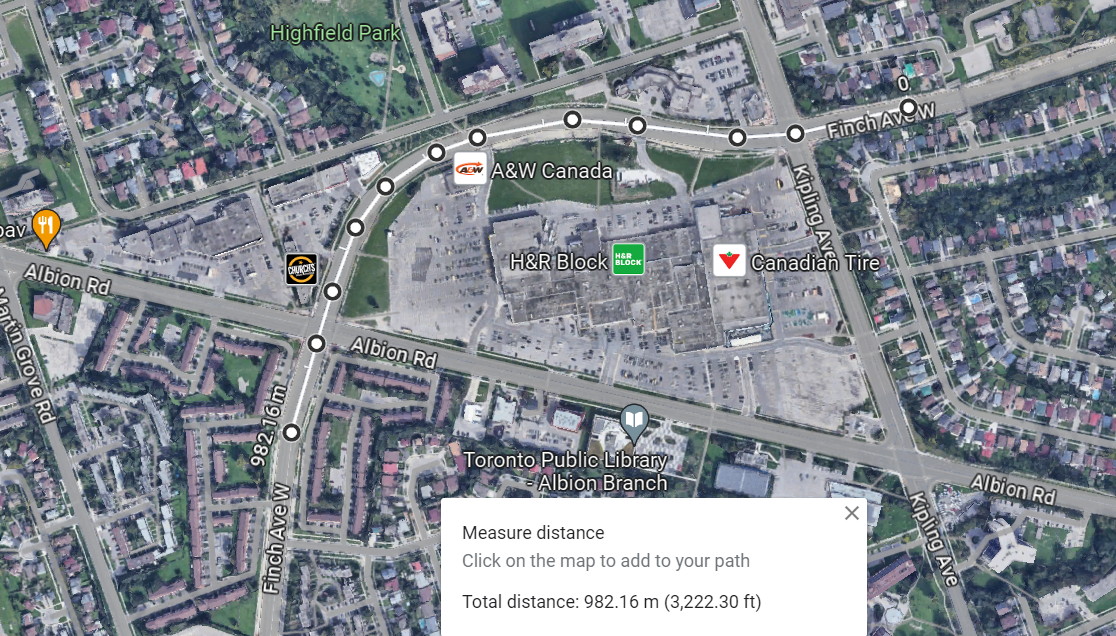

4. lastly the LRT would go below grade between Kipling and Albion to avoid those busy intersections. It could have been built similarly to the Mississauga Transitway to keep costs down. Also, Stevenson station would be removed. After Albion, the LRT would resurface and run above ground.
My logic overall is the LRT would run separately at busy intersections, but serve more local trips between the major intersections. You would get both speed and convenience. hopefully satisfying both parties in this debate.

I'm inclined to agree with @chrisw above; if we're wandering off into wild fantasy territory by vastly increasing the budget, then it suddenly becomes why not a subway to every door?
You're looking at adding ~250M of tunnel, so probably an added 250M; that's a big chunk of change; I'd have to see how substantial the delays caused by this light are; and whether one might not be better off removing the light, and making the intersection right-in, right-out for a lot less money.
2.5 km of tunnel/trench is going to literally double the project budget.
A trench is not viable and/or hugely expensive, in many sections along the route; every road that crosses said trench would sit on a bridge, in essence; and going under the 400 would mean rebuilding the entire interchange; stations/platforms add width beyond the core trench, and now that you're underground, you would need elevators and stairs to get back to the surface, and those can't come up in the middle of a traffic lane; so there's a big land take for this idea.
More tunnel? We're now tripling the budget.
