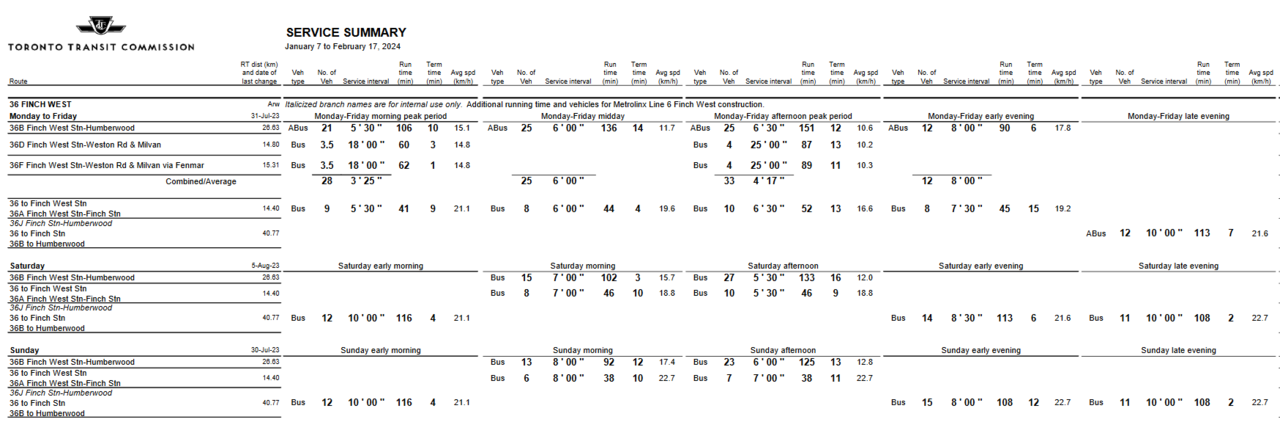

Objectively, numerically untrue. The quoted travel time for Finch gives an average speed of 18 km/h. As Northern Light has indicated, there are ways to improve this, and I certainly don't think that this is the best we can do. Transit priority, and a nixing of the dumb streetcar speed rules alone, could help quite a bit with this.
But no faster than the bus service? Have you ever looked at the service summary and seen the speeds the Finch West bus runs at?
During most (note: not all) service periods, the LRT will be faster than the bus. Certainly during rush hours, when it matters the most. The 36B/D/F don't even crack an average speed of 11 km/h in the evening rush hour!
18 kph is achievable with buses with BRT lite measures such as dedicated lanes or queue jumps. That would have cost perhaps some tens of millions for paint, signs and minor changes to the ROW.
