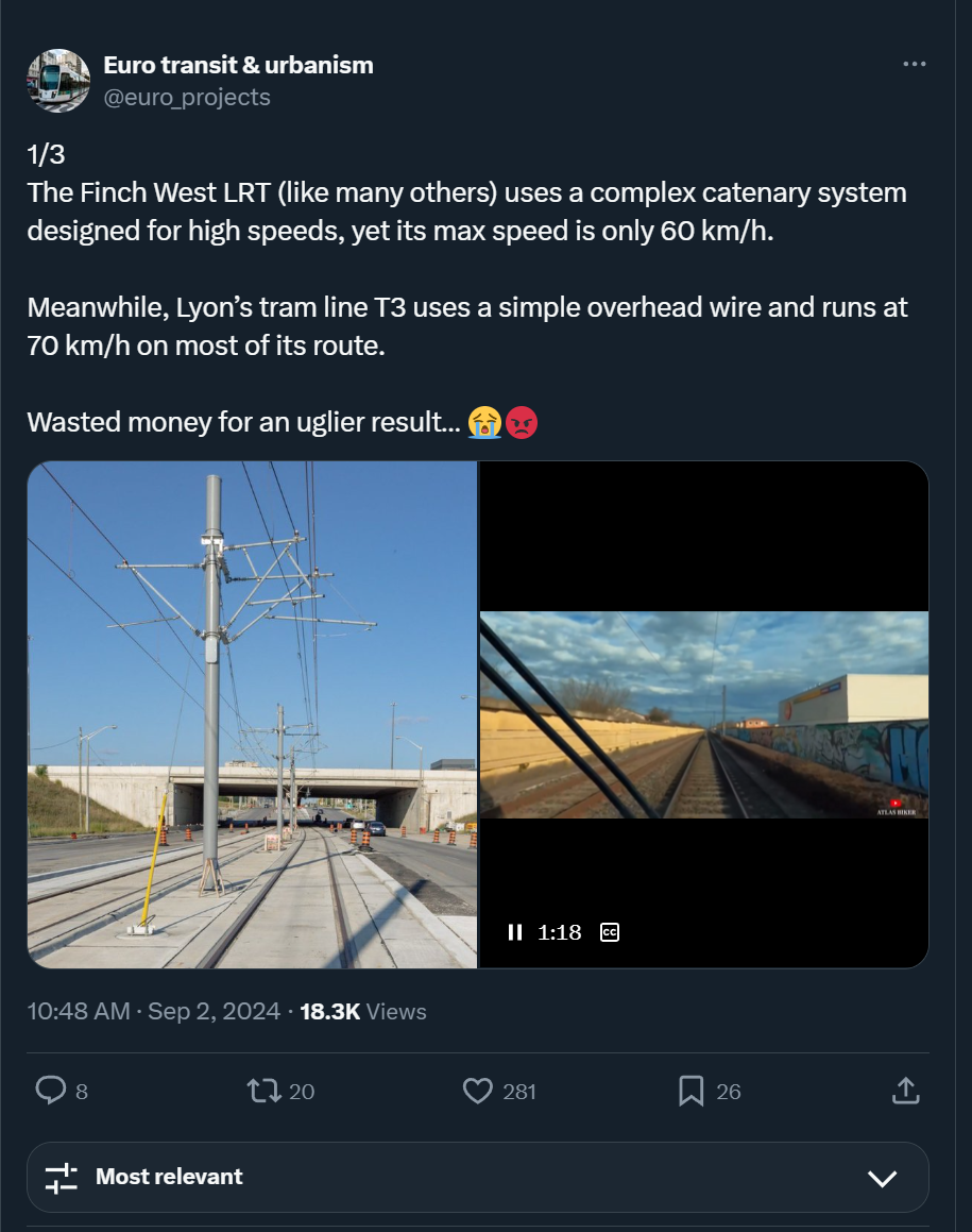

My best guess is the average temperature range, year round, is much slimmer in Lyon. Seems to be the case from a quick google search.
Power lines can expand and sag a lot at high temperatures. If the catenary is strung such that it’s taut at say -15 degrees, then it will be very droopy at +30 degrees. So our complex catenary may be more of an eyesore but it’s robustly designed – not necessarily over engineered.
Also, as I’ve gleaned from twitter replies, the example in Lyon runs mostly in a rail corridor. Finch LRT runs in a road median with many more hazards.
It won’t make much of a difference in most parts of the route. Maybe save like 30 seconds between Kipling to Islington. Unless the difference meant missing red lights which transit priority should help. Oh wait, do we even have extended green like we do for streetcars?
