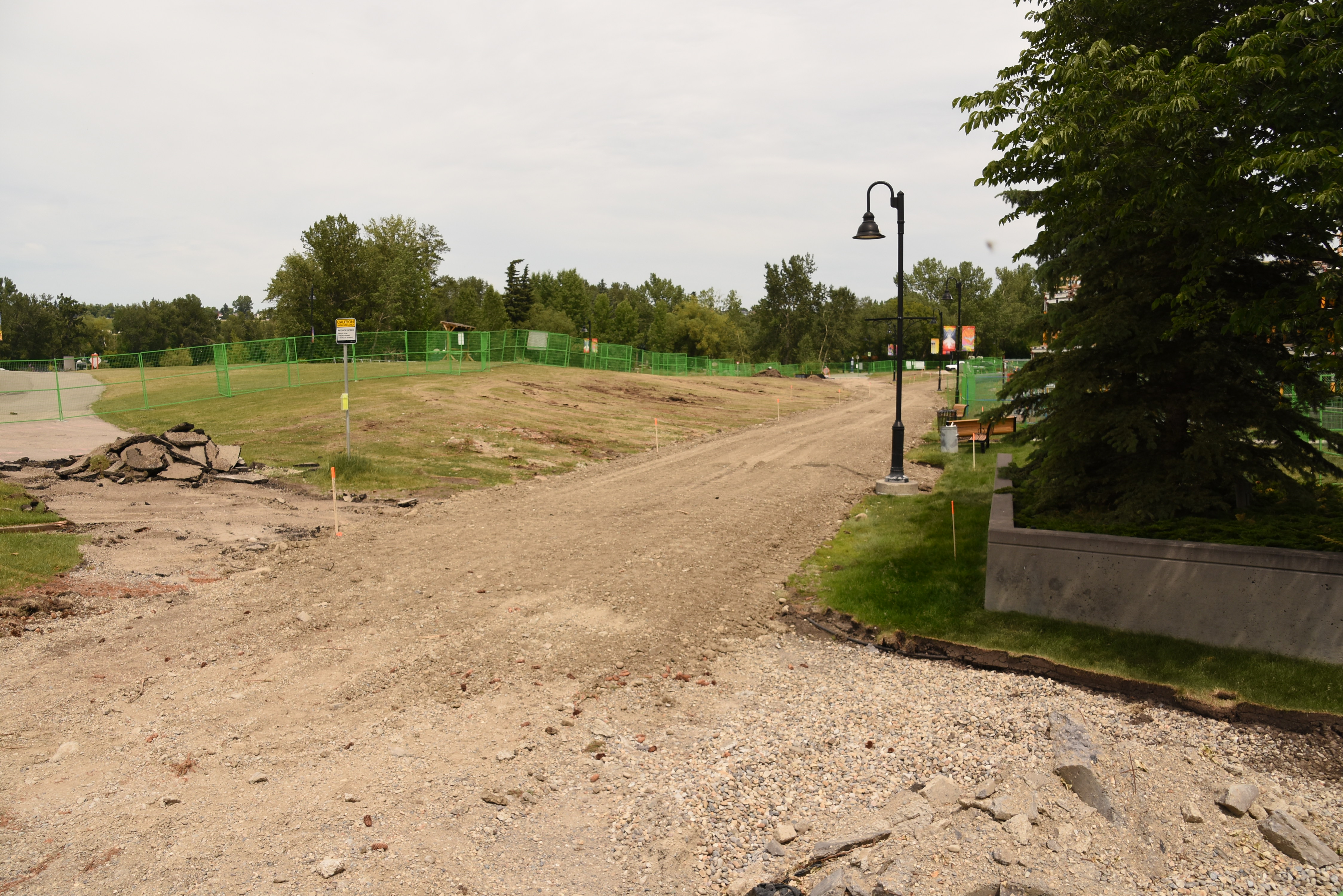

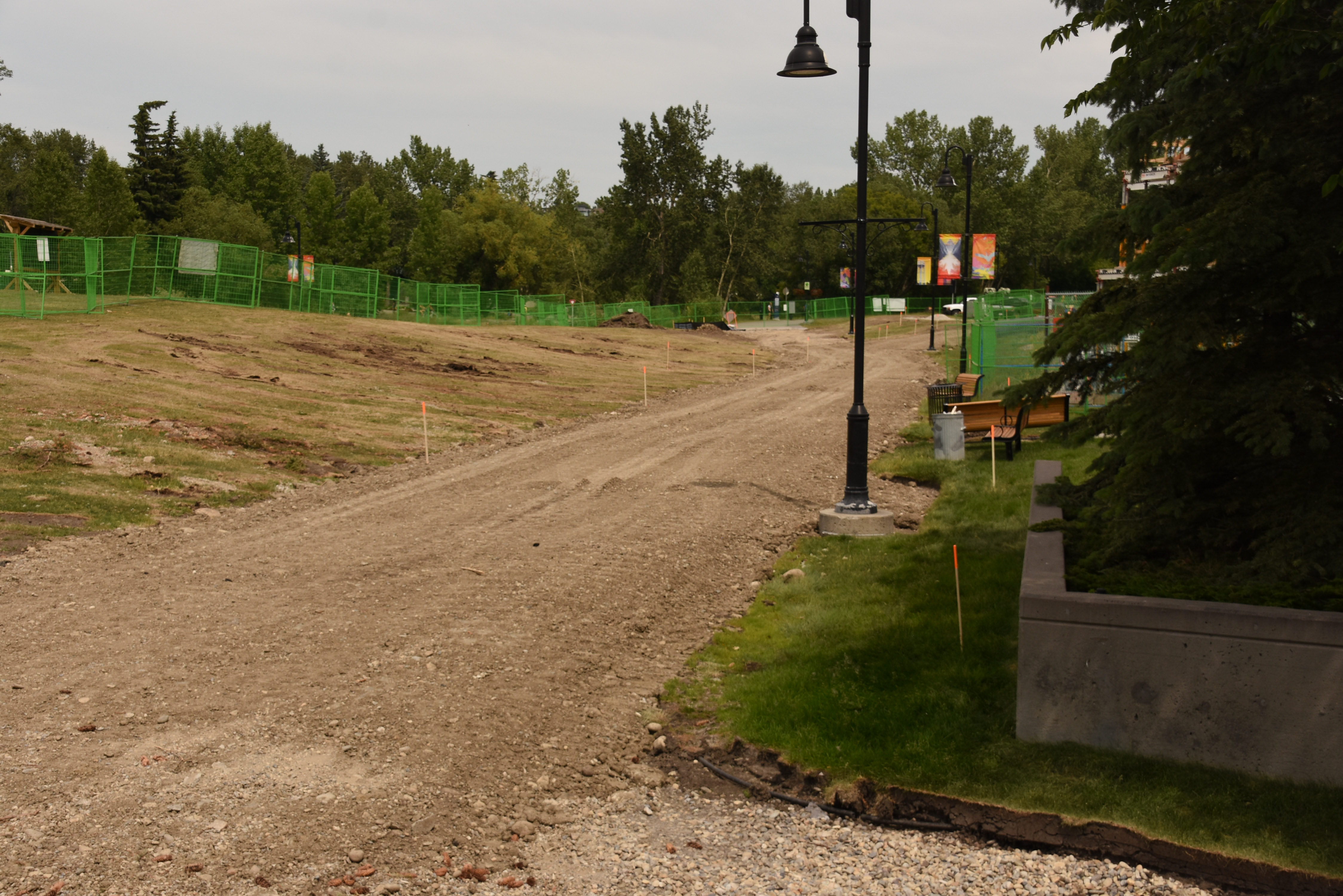

I am a little surprised they started before stampede. I know construction seasons are short, and it is always short term pain for long term gain, but to see a portion of the Eau Claire river pathway fenced off and torn up before Canada Day 150 celebrations and the Stampede, when we will likely have our highest number of tourists, is a bit rough.
I guess at some point you just have to bite the bullet and do it.

Hope they have a tight timeline, haven't seen much actual work there, mostly just fencing. This is the type of job that stretches on forever!
I walked the length of this today, a Thursday afternoon at 2:00 and not a single person working. Not one, anywhere. I expect we'll see this drag on.
