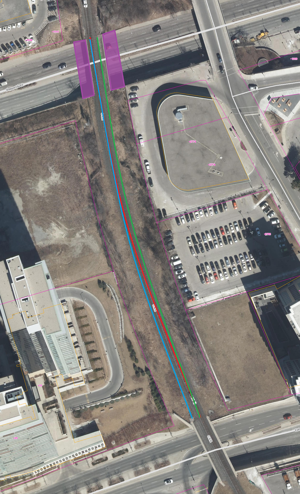

Roughing in paint. Red = existing track, green = realigned east track, blue = future west track, purple = new platform structures.
Very clear.
Is there a reason that the existing track (red) is not left in place and the West platform built now. When it's time to expand, then build the East track (green) and platform.?
(or is the "future" track happening pretty soon in the future).

Either way the track's got to move. Current track rests on west side of Sheppard bridge, and east side of the Esther Shiner bridge.
Yeah, I would think it'll be much cheaper to replace the entire track than replace part of the existing track and adding two switches.
Exactly. A West platform wouldn't line up with the current track, because it shifts east as it gets closer to Esther Shiner. Track's gotta move.
