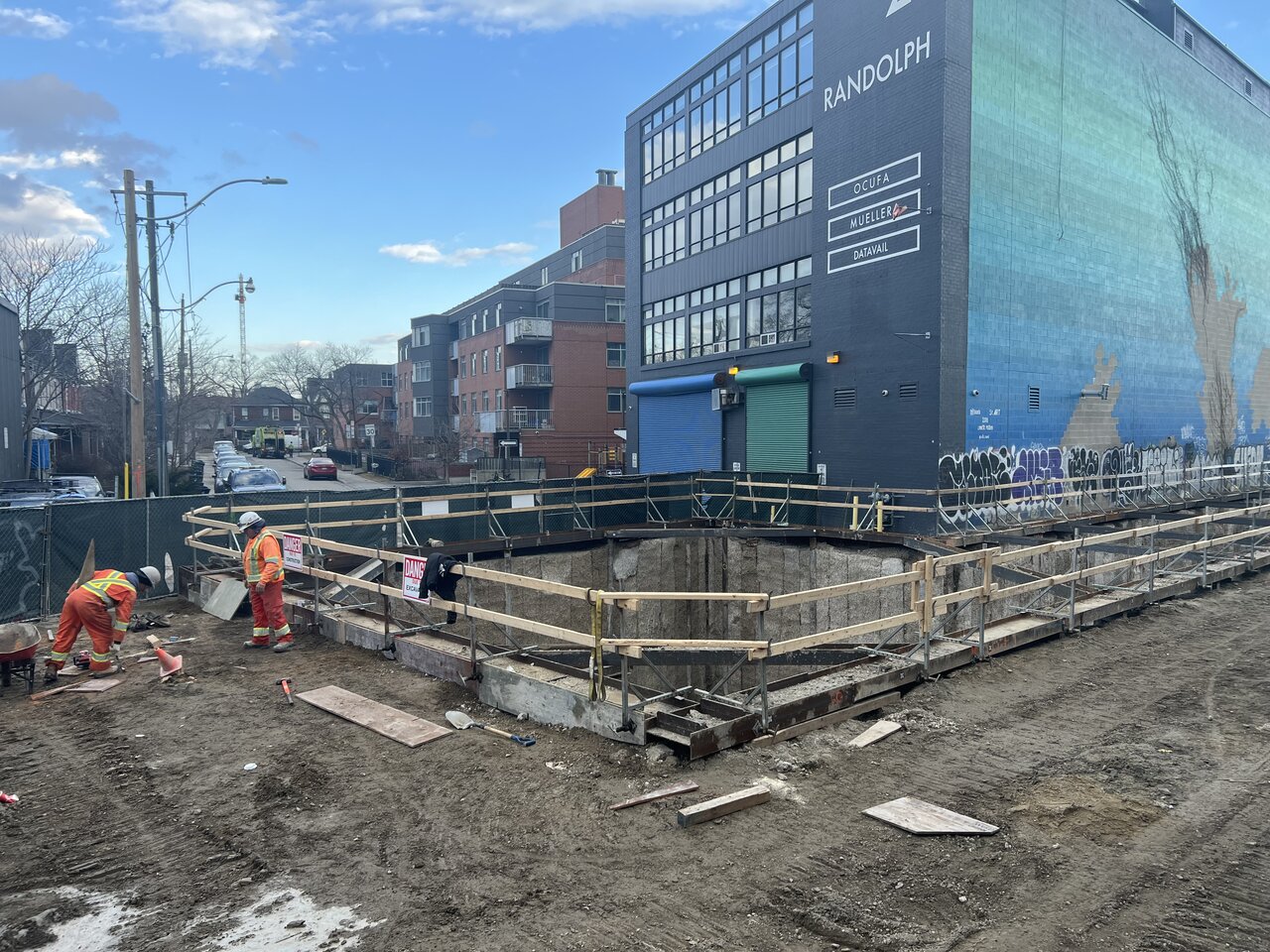

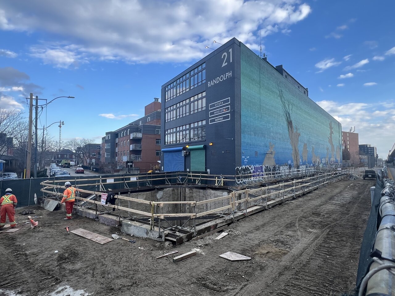

Anyone know what the wood base on the Milton line track is for?
View attachment 540126View attachment 540127View attachment 540128

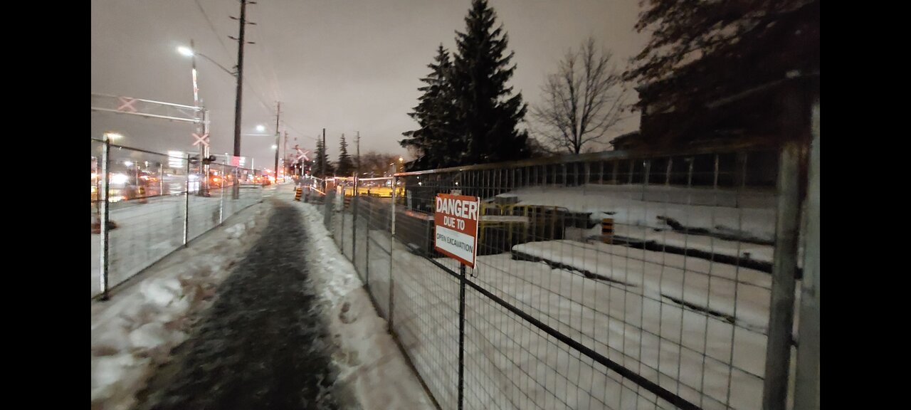

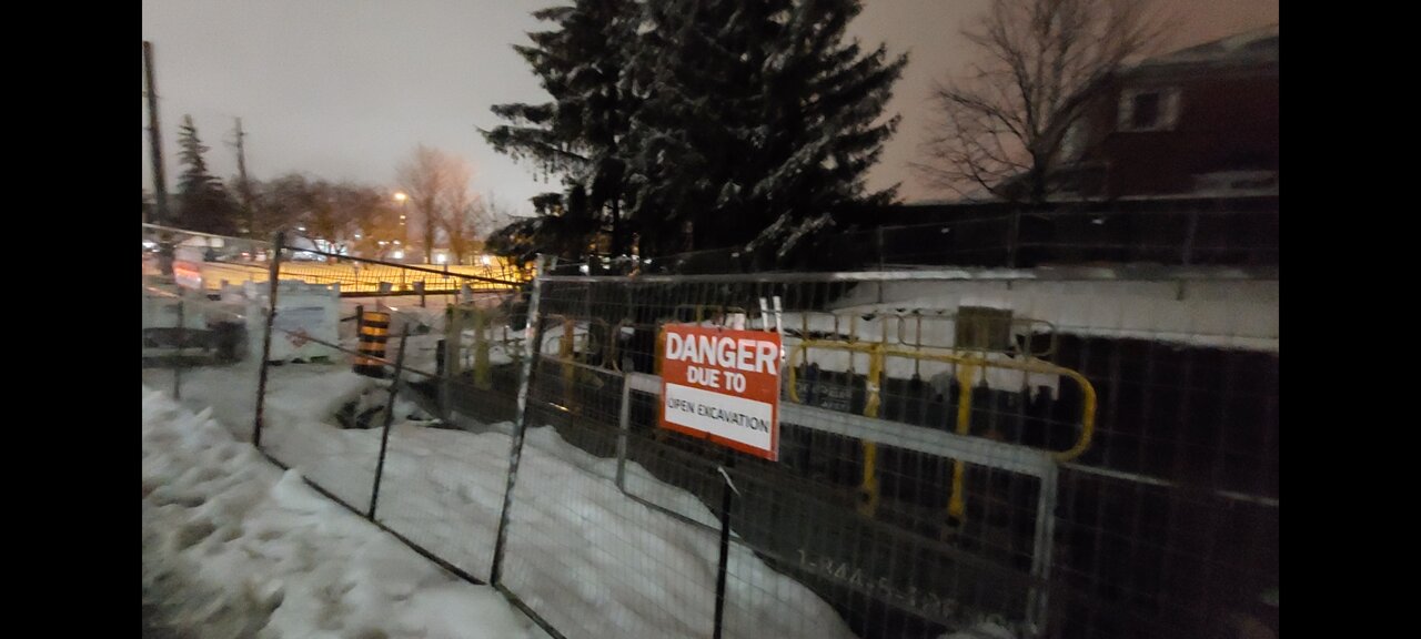

Shot of from inside the pit tweeted just now.
It has a video and here two relevant screenshots.

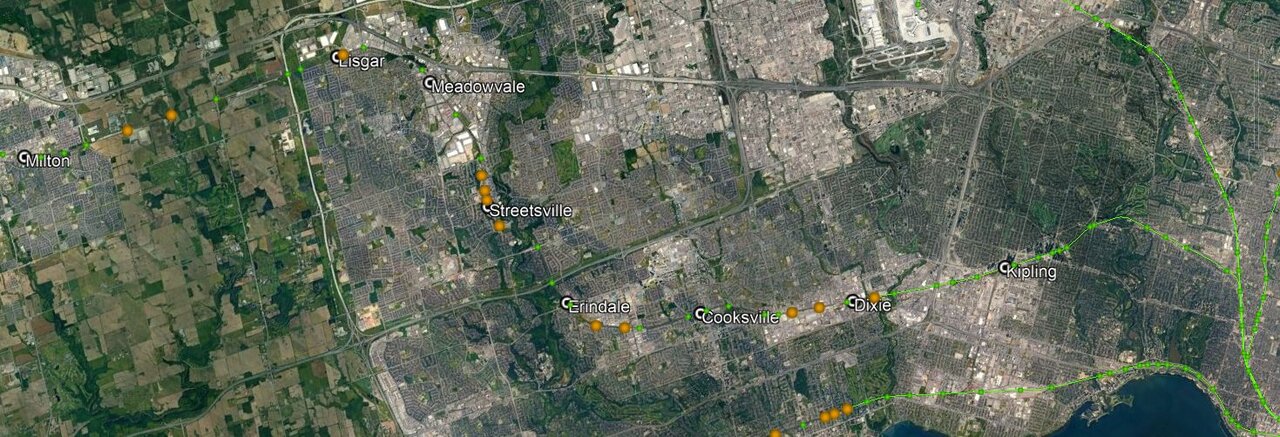

Here are the level crossings along the line currently:
Level crossings in orange, grade separations in green
A big part of the budget will be blown on a rail-to-rail grade separation somewhere between West Toronto Diamond and Kipling, so there won't be much left over for grade separations. Grade--separating through Streetsville will be a huge obstacle so there's no way we'd get through that within the budget. But we could probably get as far as Cooksville and maybe as far as Erindale in the first phase. A regular off-peak train service from Union to Cooksville could be a useful express alternative to the subway+transitway service. Removing the existing at-grade conflict between peak-direction Milton trains and CPKC trains could potentially be used as a bargaining chip to permit a couple counter-peak trips all the way to Milton.
