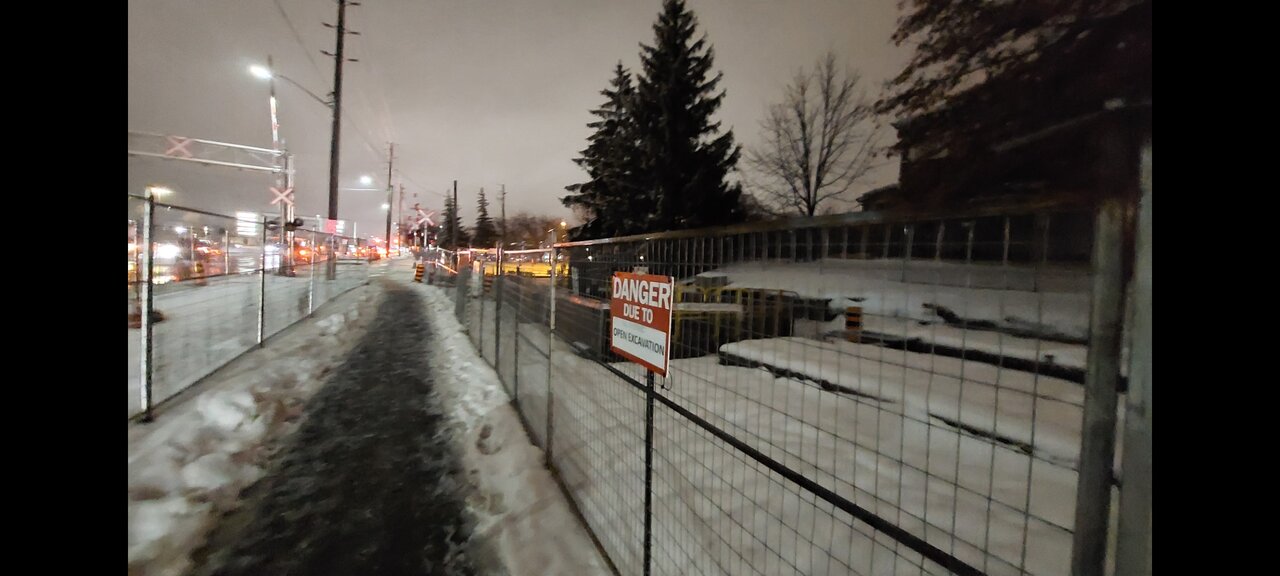

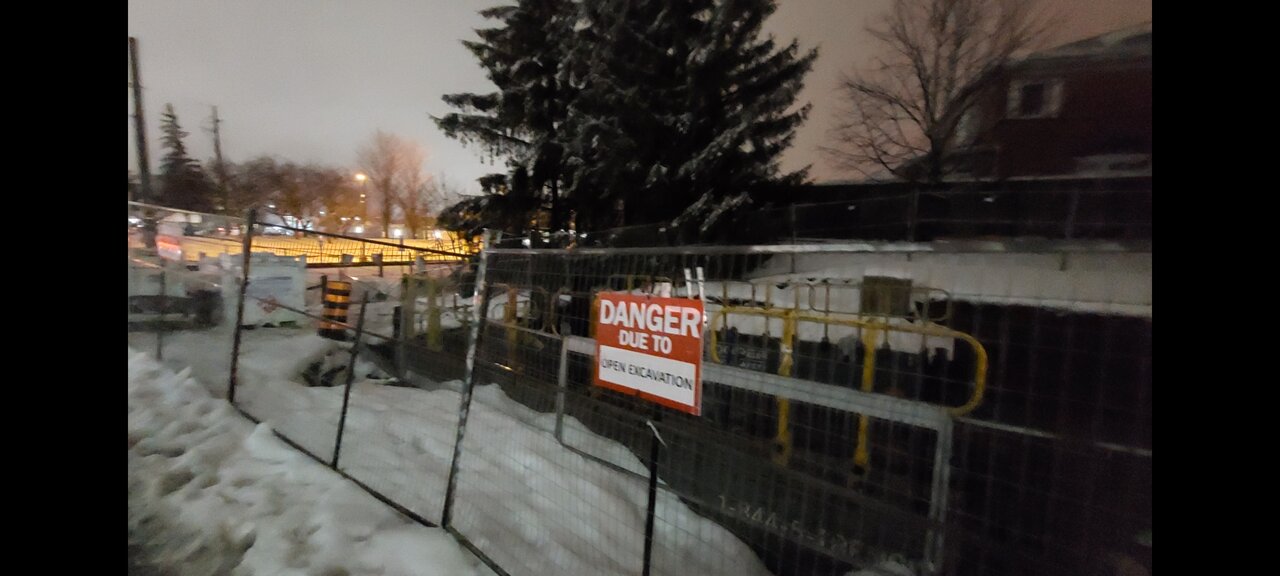

Saw this site at Centennial Station today. Seems that they are digging into the ground. What's happening here?View attachment 535053View attachment 535054
I found out what they are doing here...

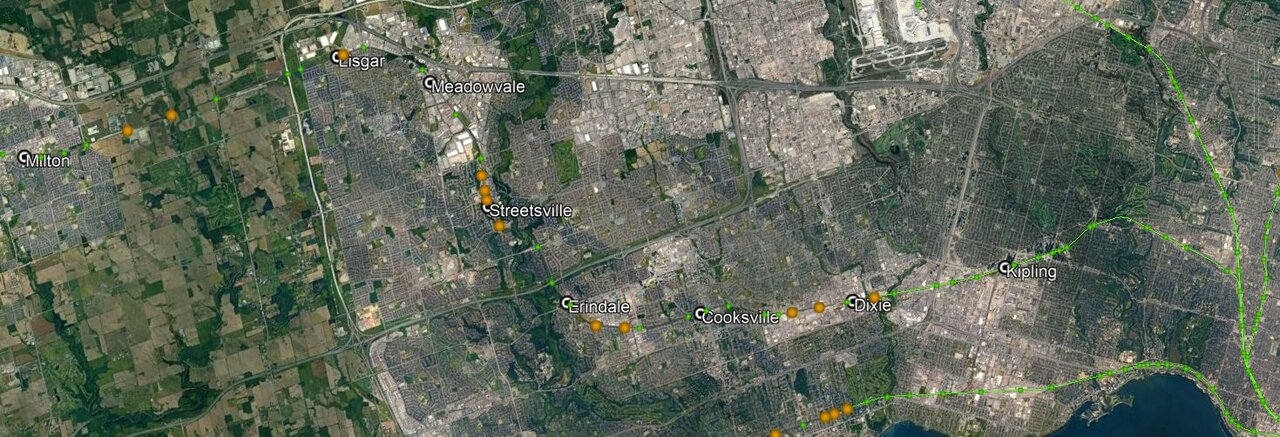

Here are the level crossings along the line currently:

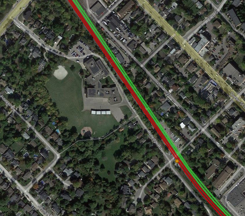

Level crossings in orange, grade separations in green

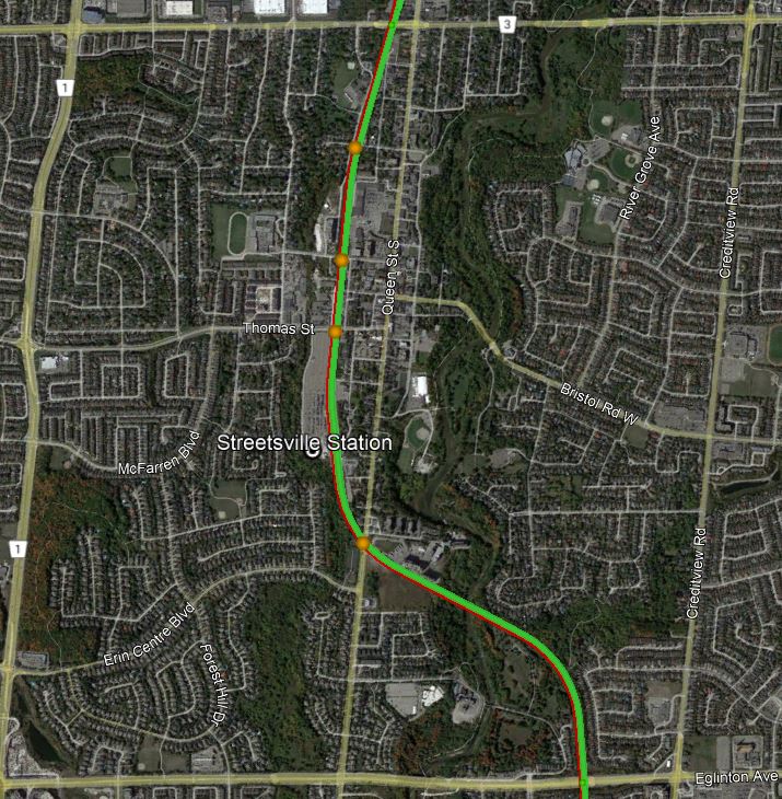

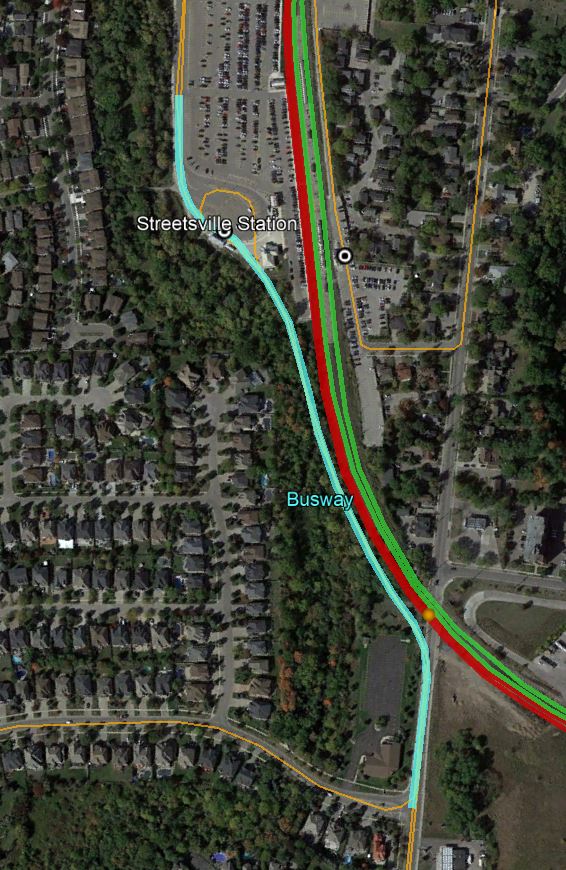

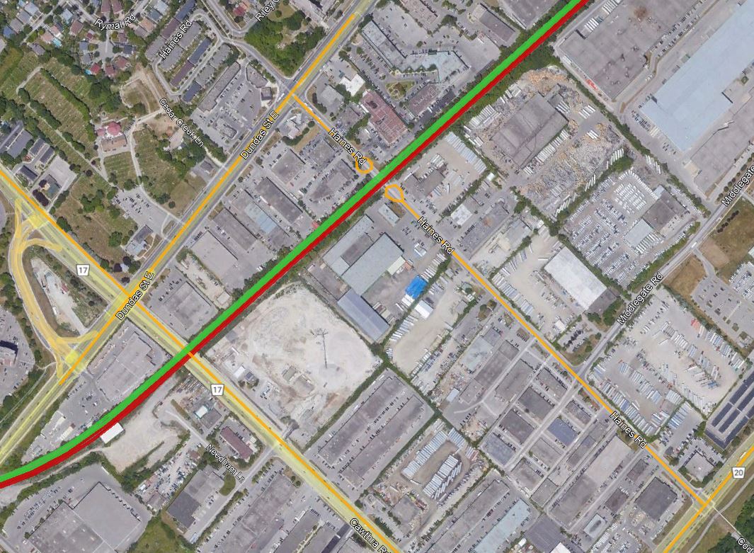

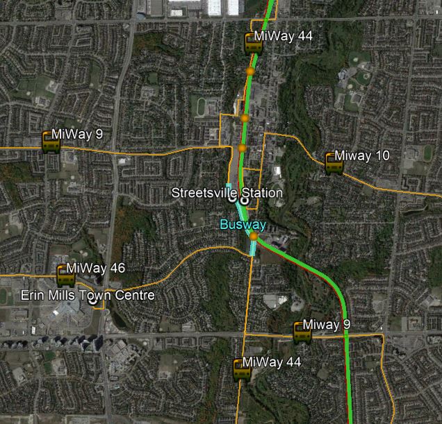

A big part of the budget will be blown on a rail-to-rail grade separation somewhere between West Toronto Diamond and Kipling, so there won't be much left over for grade separations. Grade--separating through Streetsville will be a huge obstacle so there's no way we'd get through that within the budget. But we could probably get as far as Cooksville and maybe as far as Erindale in the first phase. A regular off-peak train service from Union to Cooksville could be a useful express alternative to the subway+transitway service. Removing the existing at-grade conflict between peak-direction Milton trains and CPKC trains could potentially be used as a bargaining chip to permit a couple counter-peak trips all the way to Milton.
To save on track costs, the initial phase could include a mix of single and double track on the passenger line, e.g. for 30-minute headways, while protecting for the full double track to be added in future phases.
While work is underway on the $1.2B first phase, planning can continue on the challening subsequent phase that would extend the dedicated passenger tracks through Streetsville.

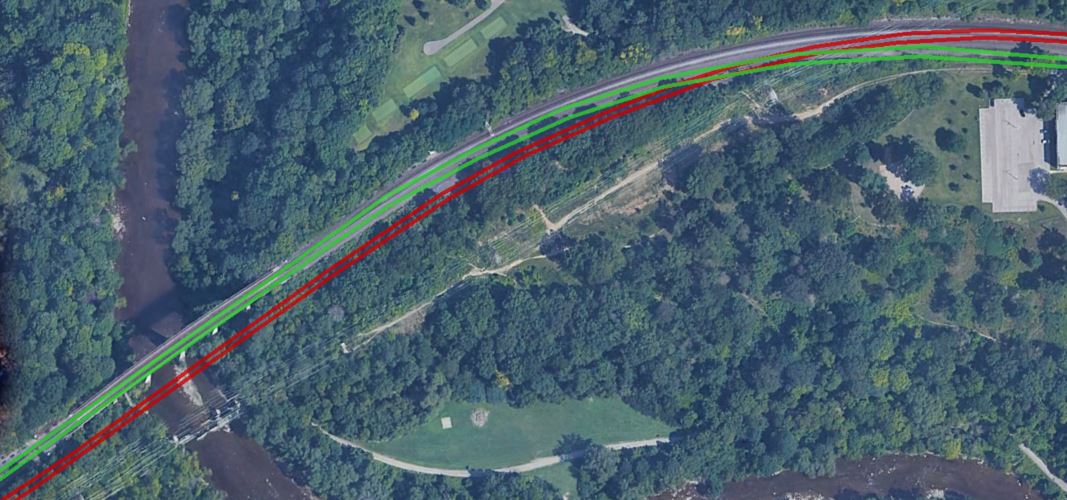

My parents look at the bridge over the Humber on the Milton Line from their condo. Honest question from them (that I don't have the answer for)... does this mean that the bridge will be twinned?
It is likely that there would an additional bridge; though possible they might just widen the piers there now. It currently has two tracks on it. If 15M GO service is contemplated, they are not running that and CPKC on just the existing bridge, as-is.

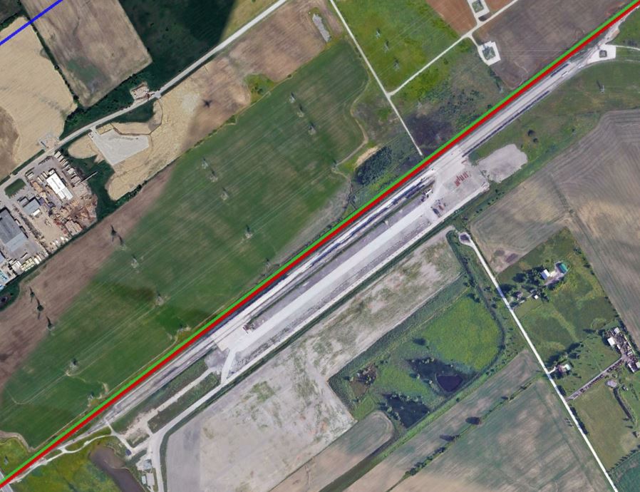

Isn't one factor that CP has a small yard on the south side between Milton and Lisgar?
How is that any different from the small yard on the north side in Streetsville?
There are lots of ways to skin that cat, but I can't see how a single, small facility - that isn't even used that much anymore - can be an impediment to better operation.

I have a feeling CPKC wants to hold on to their Milton Yard and it's specific location right off of Trafalgar to act as a surplus container yard for when the Vaughan yard reaches full capacity.
Their Milton yard is close to a lot of new warehouses and right off of the 401.

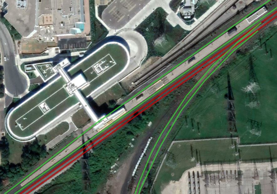

Cooksville Station (2 new tracks, one on each side)

Streetsville station (2 new tracks on the south side)

CPKC Milton Yard (2 additional tracks; no changes to yard access)
GO Milton yard (2 additional tracks; no changes to yard access)

If GO uses the northern pair of tracks, the only significant station construction required would be to add pedestrian tunnels/bridges at Dixie, Lisgar and Milton stations. The existing pedestrian bridges/tunnels at Kipling, Cooksville, Erindale, Streetsville and Meadowvale would not need to be modified at all.
I think it's clear from the overhead images that relocating all the platforms, pedestrian bridges/tunnels, and the Milton GO yard to the south side of the corridor and relocating the Milton CP yard to the north side of the corridor would be far more expensive than just adding additional tracks with the existing platform and yard configurations.
