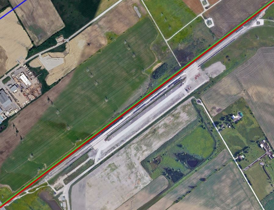

CPKC Milton Yard (2 additional tracks; no changes to yard access)
GO Milton yard (2 additional tracks; no changes to yard access)
Milton station (1 new track on the north side)
If GO uses the northern pair of tracks, the only significant station construction required would be to add pedestrian tunnels/bridges at Dixie, Lisgar and Milton stations. The existing pedestrian bridges/tunnels at Kipling, Cooksville, Erindale, Streetsville and Meadowvale would not need to be modified at all.

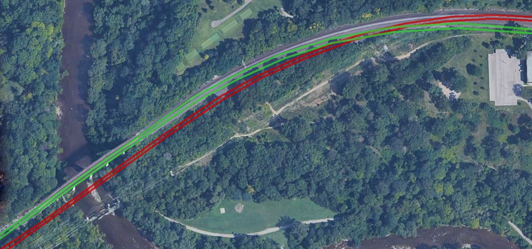

Meanwhile at the Humber River, a new bridge is required regardless of whether it is part of a rail-to-rail grade separation.
I suspect that sum of the costs to completely rebuild every station, build a new CP yard on the north side and build a new GO yard on the south side would be more than the net cost of building the new Humber River bridge such that the passenger line swaps sides with the GO line.
If it turns out that the sum of all that stuff is still cheaper than the net cost to swap sides at the Humber then yes the right solution is indeed to completely rebuild the entire corridor with platforms on the southern pair of tracks.

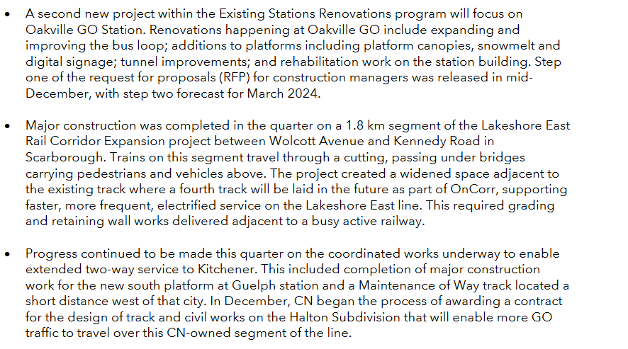

My guess for the Hamilton GO station upgrades for summer 2024 will include new platform canopies, and a new bus station canopy. Anyone want to take a guess, based on similar upgrades to other stations in the GTA. Unionville or Guelph comes to mind.
For some perspective Guelph's station upgrades (which also included new bus infrastructure) cost around 60 million.
There was a brief reference to preparation works on the Kitchener Line in Phil Verster's verbal report at today's Metrolinx board meeting. I think it relates to the "civil works" and the "CN-owned segment" of the "line" as noted above in @Northern Light's post. I'll post the time-marked link later.

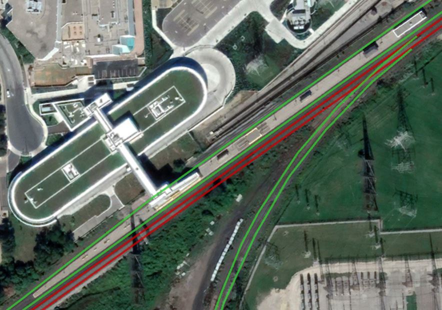

Relocating all of the platforms to the south side of the corridor would not be a small undertaking.
Take Cooksville station for example:
capture4-jpg.528927
The current platform would need to be completely demolished to make room for freight tracks, and a completely new platform built further south, with all the construction costs of the platform, shelters, full-length canopy, several stairs and two elevators. There would likely be several track shifts required and potentially a temporary platform during construction.
The pedestrian tunnel can be reused, though they would need to build new stairs and elevators. But for pedestrian bridges it doesn't matter if the new pedestrian bridge is longer or shorter than the current bridge. Either way a new pedestrian bridge is required since the current pedestrian bridge is supported by the elevator building on the platorm that would be demolished. A completely new elevator building and structural support would be required, which are most of the cost of a pedestrian bridge anyway. They could probably reuse some of the materials of the existing bridge's span, but that's about it.
Peel-Header-Photo-Cooksville-GO_bbeluc
How much would all that station construction cost? I don't know. If the above quote of $60M for Guelph is accurate for the cost of building a new platform and vertical circulation then we'd be looking at $480 Million of additional construction to move the 8 stations to the south side of the corridor. Add in the cost of building a new CPKC yard somewhere east of Milton and converting the old CPKC yard to a GO Yard and we're easily looking at over half a billion dollars to shift GO to the south side of the corridor. I suspect that the net cost of adding a rail-to-rail grade separation in Etobicoke is less than that.
capture4-jpg.528927
There is enough land on the south side for Cooksville to have five tracks there now. As noted, not a simple project not only for the station, but bridges over Hurontario St.
CPKC would have to run on a new north track and bridge that don't exist today before work can start on the south side. Both CPKC and GO will have to share that new track as well as the existing one GO uses today. Both the platform and the walkway bridge will have to be removed. Haft of the tunnel will have to be blocked off as there will be no access from the north side to the new south side platform.
A new walkway bridge will have to be built along with an elevator as well to the new platform with stairs and elevator for the remaining tunnel to the new platform.
Building a new bridge over Hurontario will be an issue that will require a temporary RR bridge to shift tracks to build the first haft before building the whole bridge. At the same time, you have an LRT station there. The new bridge should include the walkway overpass bridge that has been cancel for it. A new entrance to the platform from the street sidewalk will have to be built with an accessibility ramp to the platform.
The platform location can be shifted to the east a short distance or be place like the current one.
The first thing that needs to happen is to build the new pier support walls on both sides of the track set back further from the street sidewalks with the north side seeing a new bridge or temporary RR bridge along with a new track. The existing north access to the platform will have to be close off 100% requiring riders to do a long walking trip to get to the platform by John St and a fair number of riders use that access today. Will add an extra 5–10-minute travel time for them.
