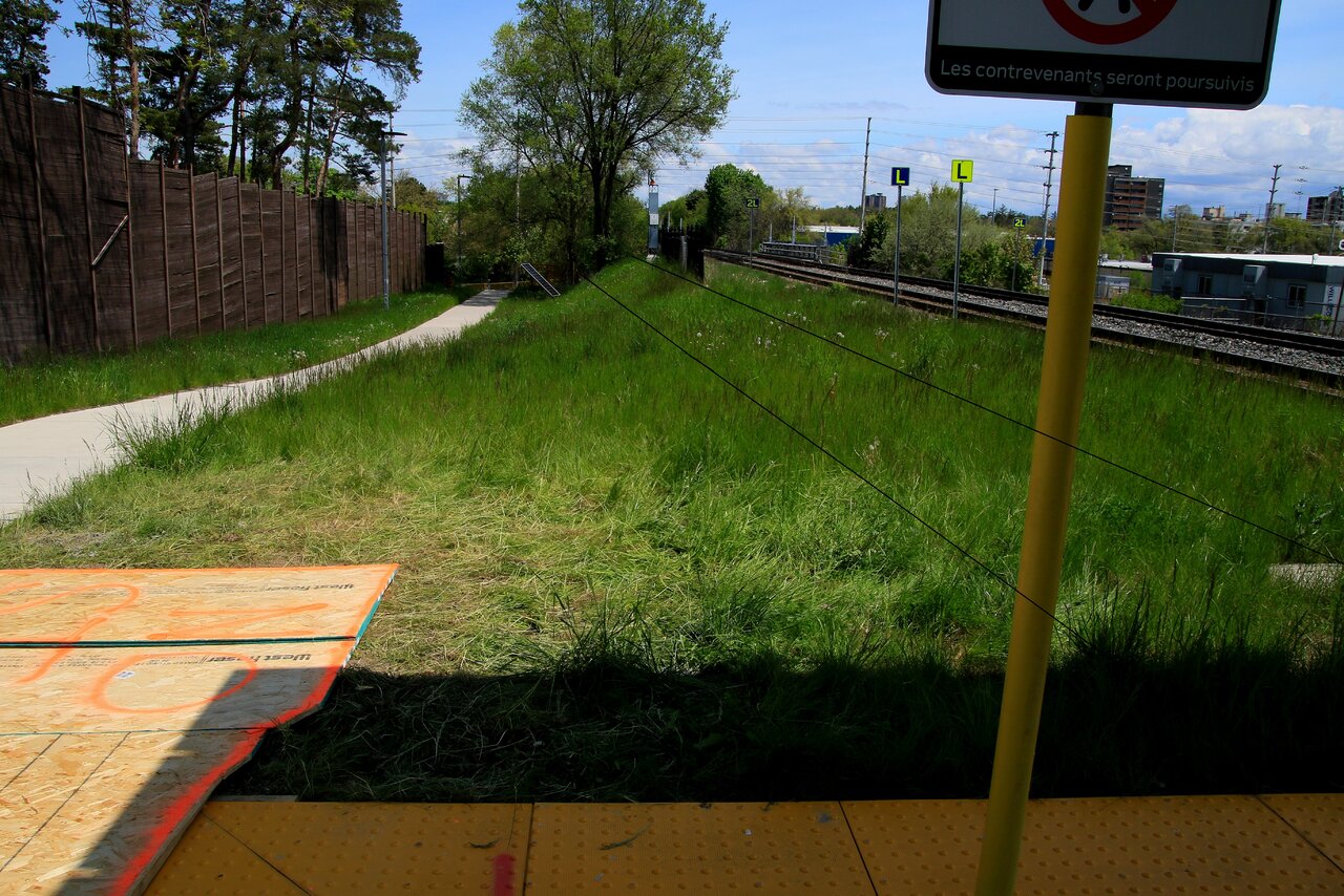

This is where I see the ramp to be. Any thought having it by the fence will not fly for safety reasons, manly having to cross the track to get to the platform. The plywood edge to the right is where the platform is with the ramp sidewalk moving to the left and about a foot of the centre of the track to the left. 2 retaining walls will have to be built for the new ramp with the south wall being about 1-2 left of the inside safety strip. That wall lines up with the bridge retaining wall.
According to OADA standards, the ramp has to be 1:10 to 1:12 with a landing or 2 part way up.
It is hard to say what the height is at the platform end compared to Hurontario sidewalk as the corridor is on a slope along with the station. My guess is about 15-20 feet over 200 feet +/- which is close to OARA requirement at this time.

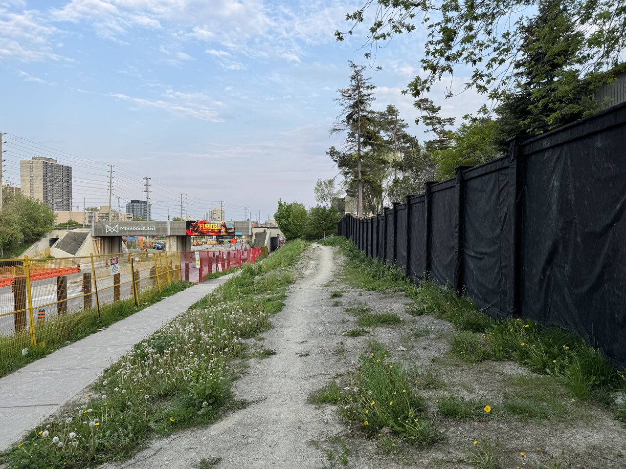

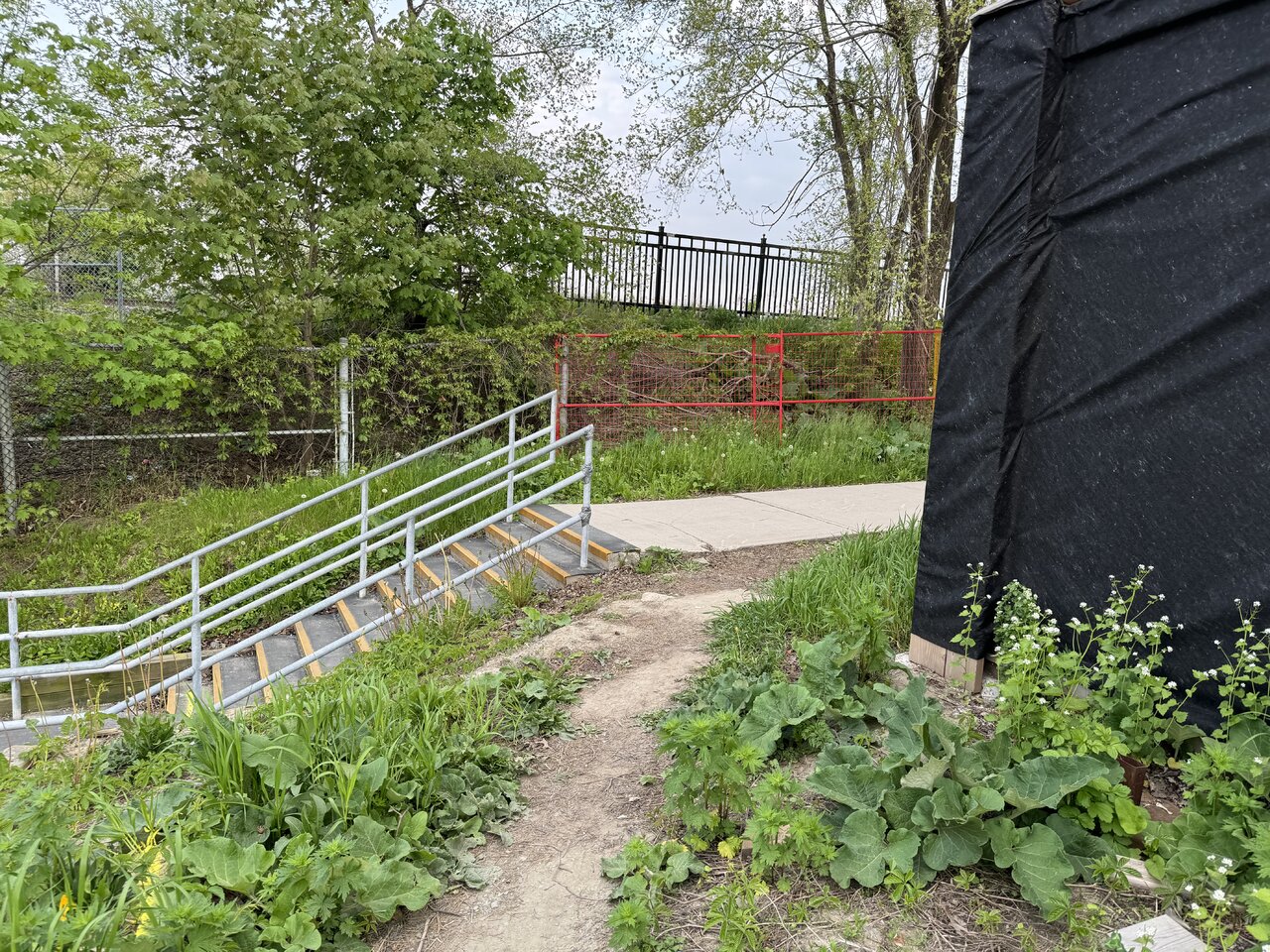

I was referring to the fence along Hurontario actually, where there are clear desire lines / dirt from where people walk to avoid the stairs. It's not really visible on google maps or street view, but when you take it frequently like I do, it's pretty clear.
EDIT to add photos of what I’m referring to:

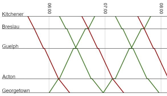

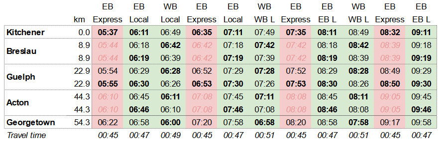

It's a puzzle. If you analyse the likely timings of the GO trains, the Acton and Guelph sidings may be more critical to 2WAD. It's almost exactly 30 minutes running time from Georgetown to Guelph, so if trains meet at Georgetown, hourly 2WAD only needs the Guelph siding to maintain the current GO schedule. Breslau and Acton provide contingency for delays, and for non-core trains eg VIA and peak GO service.
The configuration of the switches at Breslau seems to imply a "running meet" design - the length of the siding, plus the 45 mph turnouts, suggests that two trains timed to meet there will normally be able to meet without either stopping, assuming the most frequent amount of variation in timekeeping. This is done at the price of forcing every train to slow to 45 mph at one end or the other. Possibly GO does intend to speed up running times so trains pass at Breslau instead of Guelph, but that seems a bit optimistic for the moment.
Acton is no more important than Breslau, for the reasons you stated. The pairs of sidings need to be 30 min apart so the basic hourly service will either use Breslau and Acton, or Guelph and Georgetown. Acton is useless without Breslau.
When I mocked up the two way timetable (for fun in my spare time) I needed to add 4 minutes travel time each way between Kitchener and Georgetown to get the peak period 30 minute service to line up with the passing track locations. It's either that or somehow save 15 minutes between Georgetown and Breslau which is not plausible.
The extra peak-period service needs to run express skipping Breslau and Acton because those stations only have a platform on one track.

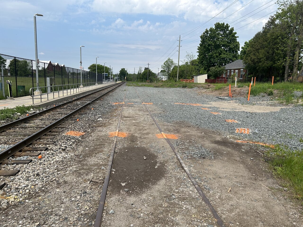

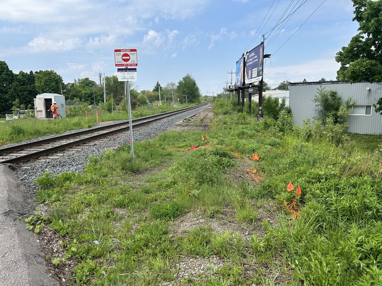

Had a chore in Acton today so I had a look at the station - lots of new spray locate/cable layout markings and a bit of brush clearing, but no further activity towards the planned siding work.
This appeared to be mostly related to shifting buried telco and crossing protection wiring, no evidence of prep work for the east end siding switch or signals.
The rail and tieplates from the decommissioned end of the siding had dates back to 1927 so one can be confident that what is there will be torn out and relaid.
The west end of the siding is a stub end affair used for storing work equipment.
All in all, early days yet.
