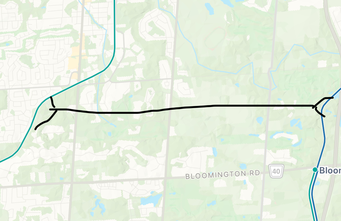

We got the Bradford Bypass when what we need* is the Aurora Bypass **
* okay nice to have
** yeah it looks crappy I did it on my phone
Bloomington station was partially built as a relief station for Aurora. The Richmond Hill line service however does not intice many from Aurora from using it.
