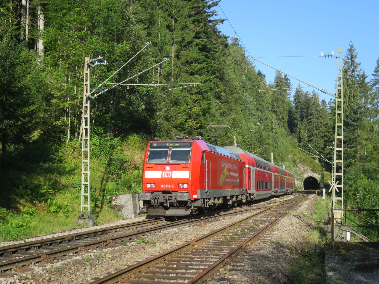

Here in south west of Germany bi-level cars are pulled or pushed by ordinary Bombardier Traxx - https://en.wikipedia.org/wiki/Alstom_Traxx
You can ride the regional express on the famous
Black Forest Railway (Baden) - https://de.wikipedia.org/wiki/Schwarzwaldbahn_(Baden)
Being resident of Toronto and the Black Forest area I have a feeling what DB as the Metrolinx GO train consultants is proposing. Definitely no EMU’s. See the photos below! 😀

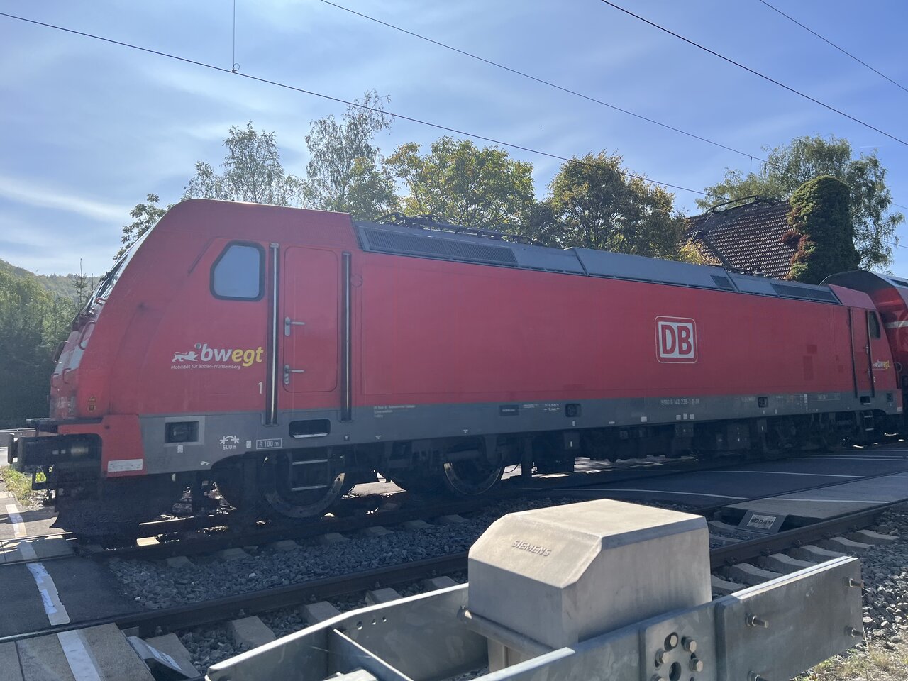

Here in south west of Germany bi-level cars a pull or pushed my ordinary Bombardier Traxx - https://en.wikipedia.org/wiki/Alstom_Traxx
I can show you the same thing for Frankfurt, Hamburg and other places under DB control as well showing EMU's in those same places. DB is not a one fit all, but use equipment that is needed for those area.
Zurich was the first place I saw in 2012 using this setup with 8 cars on the trains for most local routes. Longer intercity trains were 2 sets of 8 or more cars. I also saw 3 and 5 sections EMU's running in 2-4 car sets including Germany
You will also find single level car trains like this as well EMU's, let along DMU's.
