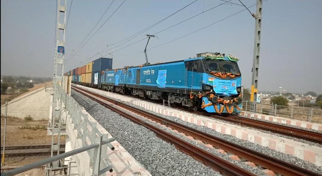

High reaching pantographs can extend over a 3m height difference between extended and folded position.
Overhead lines and double stack containers are possible.

as the photo clearly shows, its possible to design the OCS to accommodate to the double stack and autoracks from the CN/CPKC lines and bi levels
its all dependant on their spines. clearly CPKC/CN are too afraid of change so are resistant to allow for OCS on their lines. RH couldve been part of this too.

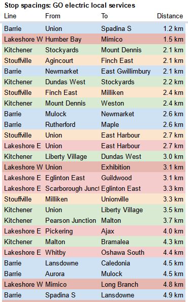

Here are the stop spacings for the core local services in the future network. These are the services which would be the top candidates for EMUs. The remainder of services can happily continue using BiLevels with Electric, Bi-Mode or Diesel locomotives for the forseeable future.
2-jpg.395357
Based on these spacings, it seems that the Bramalea-Unionville local service would be a great candidate to be run by EMUs. So when it inevitably comes time to buy some new trains to accommodate ridership growth and replace old coaches, it would make sense for those new trains to be EMUs. Those new trains could be assigned to that service, and then gradually rolled out to other local services.

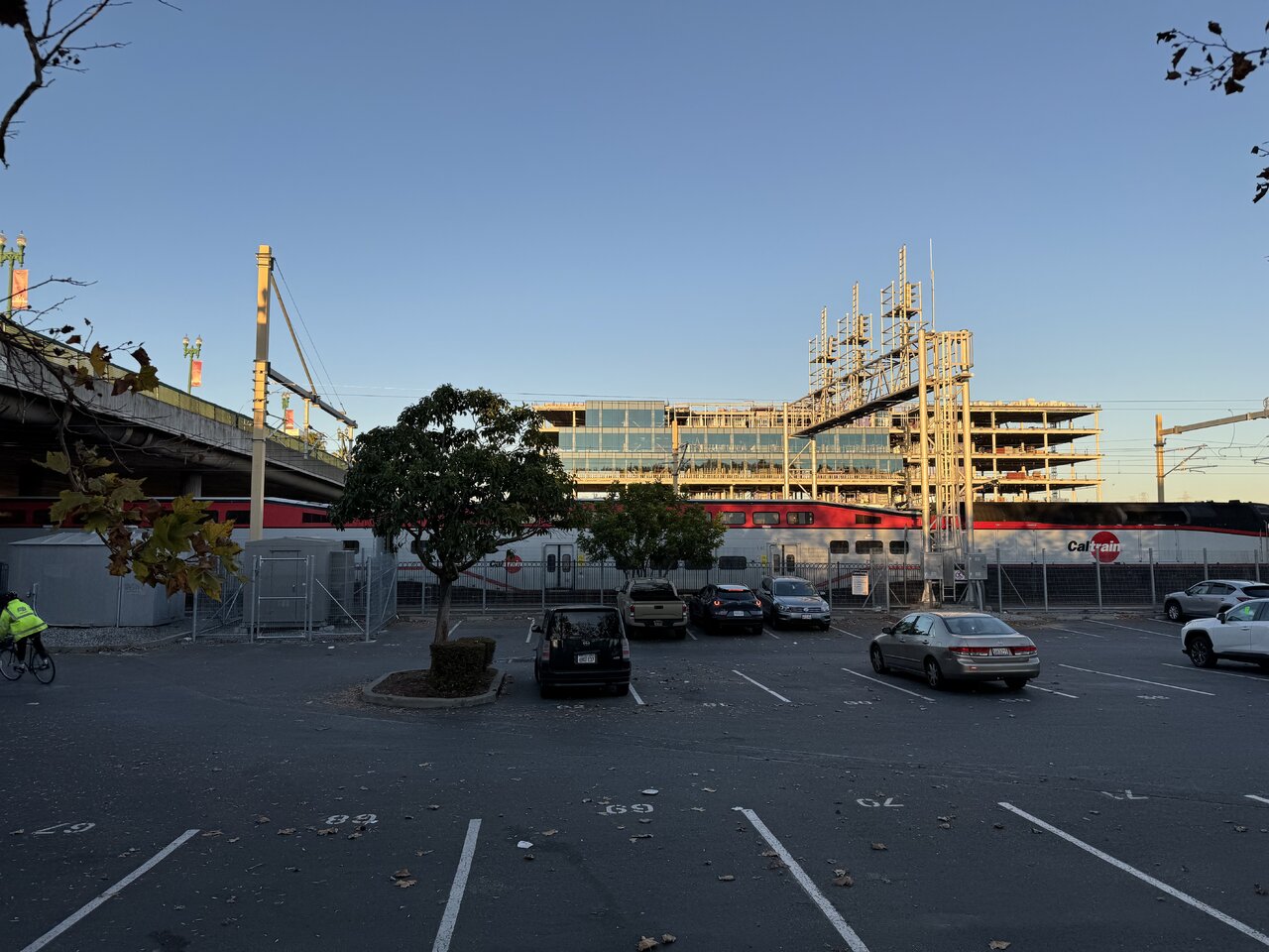

The Caltrain bilevel trains seem very short. I saw one at Millbrae but didn’t get a great picture, as I was rushing to catch my flight, but I’ll just post it anyway. I think they had only 4 coaches. They seemed to accelerate quicker than a GO train.
its all physics. when you have only 1/3 of the weight to pull its natural
