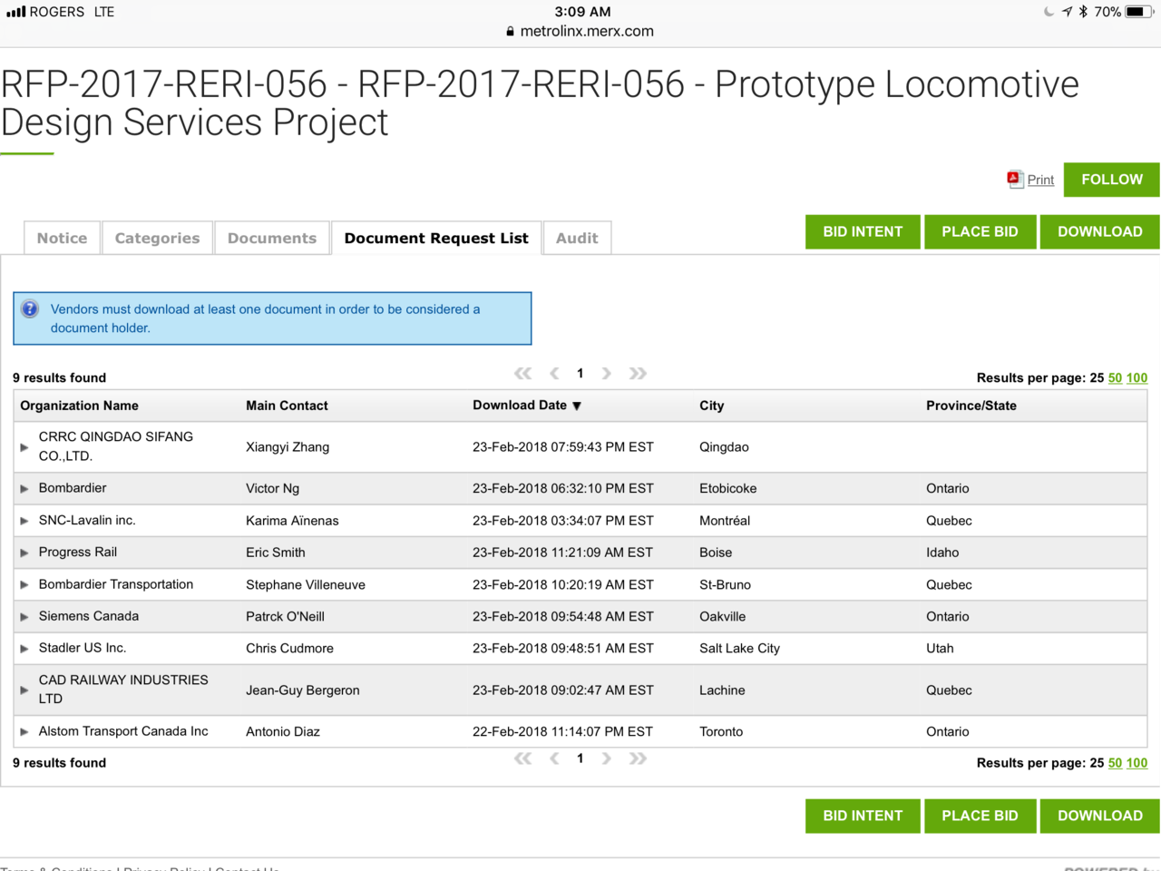

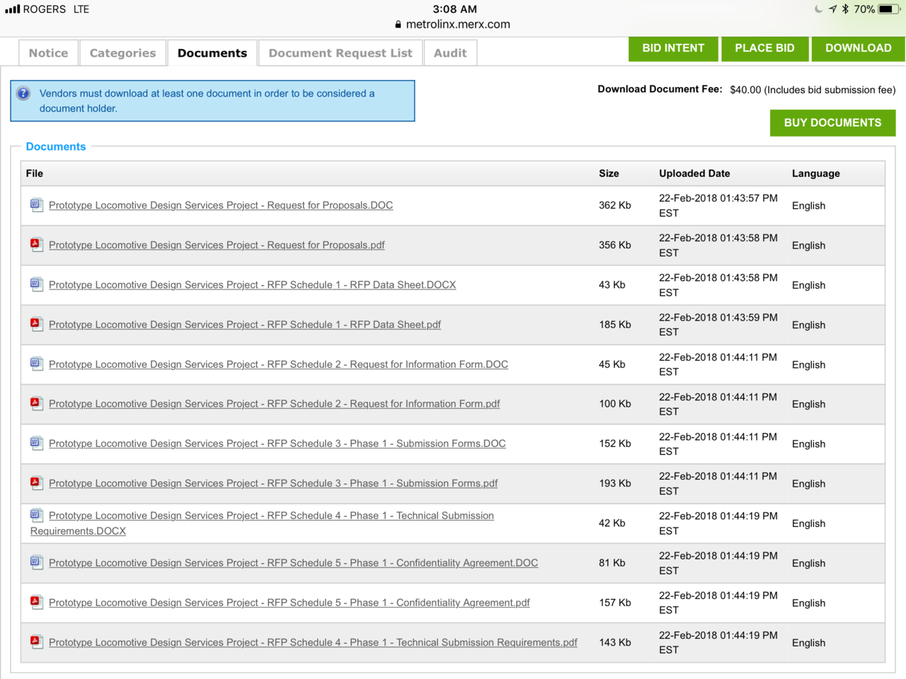

For those interested, Link to the Prototype Locomotive Design Services Project RFP
For those interested, here is the documents list and document requestor list.
Personally, I think hydrail is only good for a trial on a feeder line.
Bolton shuttle, Niagara-Hamilron shuttle, etc.
View attachment 135367 View attachment 135368
