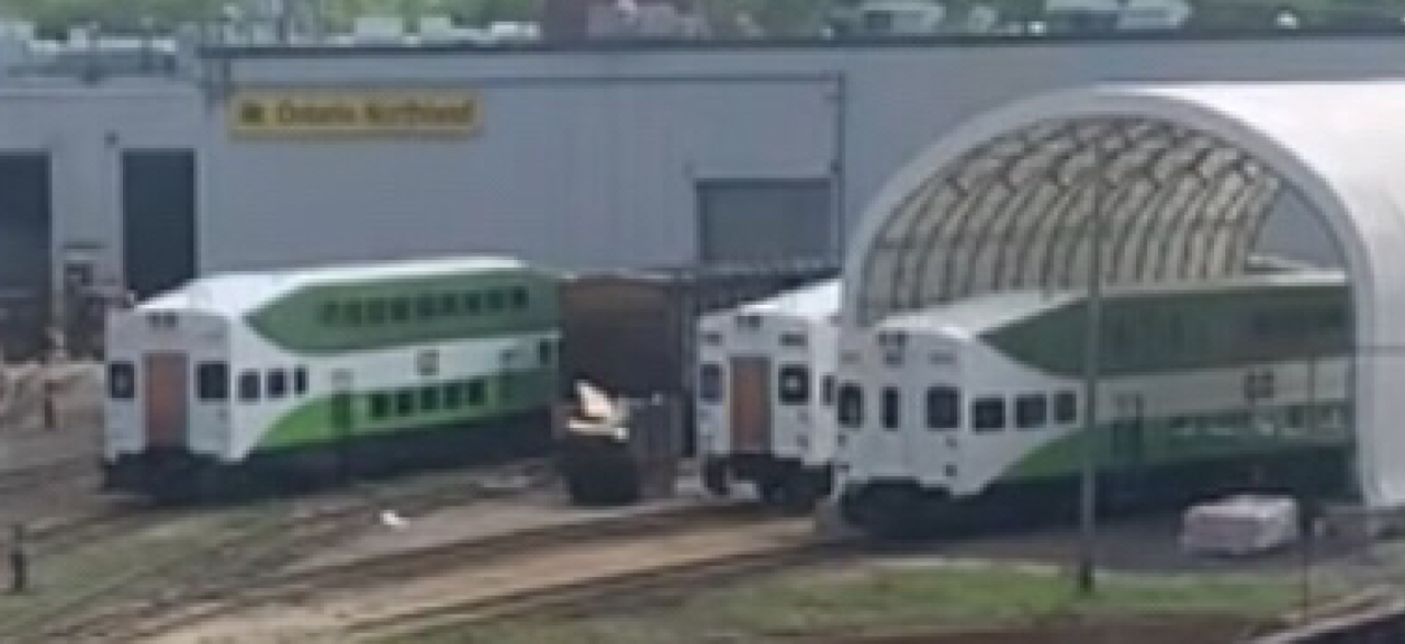

This may be something trivial to most, but for me, I hope that when ONR is done with refurbishing the Series II cab cars, MX puts the reflector stripes back on the front. That makes them look even better in my opinion.
