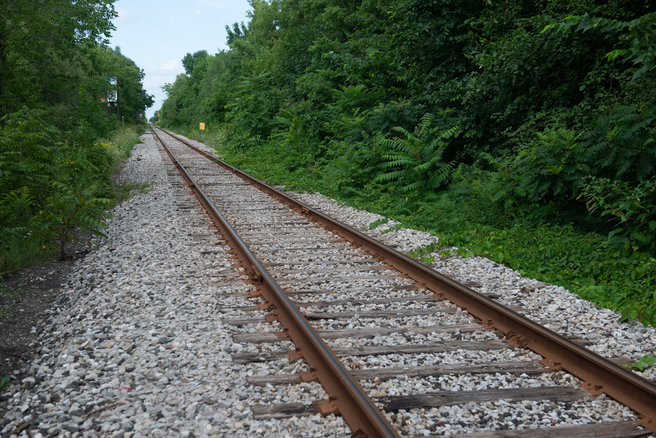

^As it happens, I was in London yesterday, and out of curiosity I took a minute to peek at the track around Florence and Highbury, which is right next to the road so accessible without going anyplace one shouldn't go.
I was mostly looking for stampings on the rail to indicate age etc. In fact, there weren't any real markings. Enough of the tieplates were dated 1955 that I would think that's a good indication of when things were last changed out..
I pretty much immediately noticed a substantial 'ding' in the rail. This particular rail had been shifted so the 'ding' was on the outside, so it's not a safety defect per se. But that, plus the level of wear on the rail tread, would tend to indicate that the rail is pretty close to end of life. Similarly, the ties were consistently worn and cracked.... no sign of any tie renewal in the past while. Note as well the yellow temporary speed restriction sign, which ran all the way up to Clarke and Oxford. Ballast looked clean, but not as deep as one would see on a heavier main line.
CN runs its track defect detector vehicle up this line fairly regularly, so I'm confident things are safe, for the speeds allowed. But this is not in the shape that one would want for an intercity passenger line. Whether ML intends to put money into the line right away or not, one can't expect a very attractive service to appear until the line gets a good rebuilding.

New sleepers, ties and new track and ballast would be required. Maybe they could increase the speed by replacing the sleepers that are in the worst shape. Leave the bolted track in place.
It’s not nothing, but installing CWR along the corridor is a doable proposition. The benifits of being able to run GO trains at 120km/h to 150 km/h would far outweigh the costs, and significantly cut travel times.

I agree with @crs1026 that we should do it once and do it right. The whole line is falling to bits, and needs to be rebuilt from the ground up. Let's build it up to a 95 mph (153 km/h) standard, just like the Lakeshore West and Lakeshore East lines already have. The alignment is good enough to support it, and the distance between stops is long enough that it would be worthwhile.
The faster the service can be, the more profitable it will be (least subsidy). Speed is critical on this line, since the potential ridership comes specifically from London, Stratford and Kitchener, with very little population in between. We need the service to be as attractive as possible to people in those cities. This is in contrast to the Kitchener-Toronto segment which generally has enough population dotted along the line that even a slow service can attract a respectable amount of ridership without achieving a very high market share in any given town/city.
Upgrading it to its full speed potential from the start also makes it possible to run a regular hourly service in both directions. Doing so requires sidings located precisely every 30 minutes along the line. Once those sidings are introduced, the travel times will be locked in. If you later reduce the travel time on one of the segments from 30 minutes to 25, the train would then need to wait 5 minutes in the siding for the train to show up in the other direction anyway.
