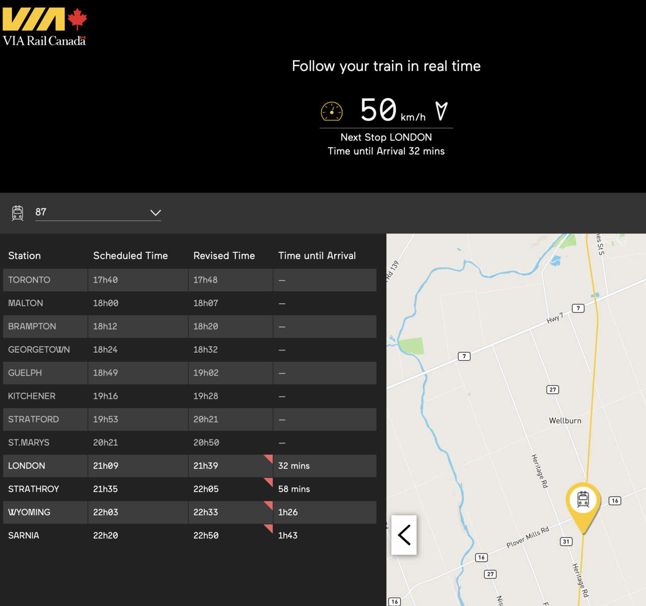

I just hope that GO and the Minister understand just how embarassing the track speed west of Stratford is.
I watched the moving map tonight - 50 km/hr is the highest speed that VIA ran between St Mary's and the outskirts of London.
Note the time used for the 9 miles from Stratford to St Mary's - 29 minutes.
I'm accustomed to seeing VIA being placed in untenable situations - will Ontario do the same with GO to London?

Is that 20mph track speed? What would it take to upgrade it to 40mph?
50 km/h is roughly 30 MPH.
That’s the result of GEXR maintaining the track for many years at a minimum speed for its freights. Though CN recently took back the Guelph Sub between London and Kitchener, it’s still in poor shape. VIA only runs one train a day through there anyway these days.
So in exchange for allowing GO to run to London could they not fix up that track?
I mean if you add up the crew hours over time if you spend 100k on track repairs you would make that back in crew hours.
Or make it part of the agreement with CN. They are getting revenue per axle anyways.
That might be why they are doing test runs to see where they can optimize the speed with the funds available.
New everything. I suspect it's just plain worn out. Specifically
- grub (remove vegetation)
- clean out culverts and restore drainage
- undercut to remove the existing ballast (which is likely mostly dirt at this point)
- new crossties
- new rail and fasteners
- new ballast, attention to subgrade, maybe geotextile in places
- resurface, restore superelevation on curves
- rebuild crossings (There are 46 of them between the platform in Stratford and Egerton Ave in London)
- new crossing protection devices
- repair bridges, replace deck
But that's by no means complicated, or even that expensive. No fancy engineering required. No large civil works, mostly just a decent sized mechanised track crew.
The cost of raising it to 75 mph or greater is probably not that much greater than the cost of 40 mph, so do it once and make it right.
