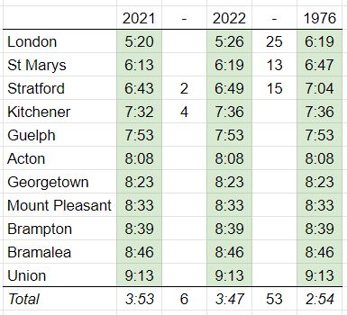

So how do you make the schedule reflect the original schedule before the track deteriorated? Shouldn't they be able to shave an hour off that trip?
Yep, 59 minutes. Here's how that would look for the morning trip.
The 2021 column is the current (Oct 2021) schedule. The 2022 column is the schedule I think will be implemented soon, to reflect track improvements completed in Dec 2021. The 1976 column then swaps out the London-Kitchener travel times for the ones from the April 1976 schedules. The numbers between are the time savings between stations.

With 95 mph speeds, 2hr 40 mins or lower could be possible?
So about 45 minutes faster than the trip today...
45-60 minutes faster. 2hr 50 minutes would be the potential time if stuff like Georgetown is also improved.
Then if upgrades are done to get the line to 90mph I think 2hr 40 minutes could be possible. Maybe lower if there is electrification.

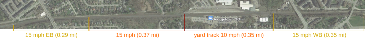

I wonder what the deal is with Georgetown. As far as I can tell, there's only about 0.35 mile of yard track, and the rest of the slowness is on bonded track built to mainline standards.
Couldn't much of this be fixed just by tinkering with the signals? For example, letting westbound trains accelerate right after clearing the yard track (as eastbound trains do already), and signalling 25 instead of 15 mph when approaching it (as with the Bramalea stub track)?
There are engineering and operating restrictions on how signalling is designed, so one cannot just arbitrarily change the rules…but…The short answer is, yes, it can easily be fixed…. with money.
Depends on things like - how many power switches ML wants/can afford for the yard at Georgetown, how many tracks will be bonded…. and that may depend on the intent of the station design ie which trains use which platform tracks, etc
I suspect that with other design elements not fully nailed down (eg the flyover) it’s wiser to let this one sit for a bit. When the flyover is finalized, one would expect the Georgetown station configuration to become clear.
I don't have current line speeds for that section of the Halton Sub, but the line speed in 2015 for that area was 50mph. Crossovers were all #20s, rated at 45mph. Considering how heavily the line is used, there's no reason to think that the limits have been lowered through there.
The Guelph Sub has a speed limit of 70mph.
The issue is the GO yard and platform at Georgetown, which are not signalized and limited to 10mph.
Now despite the higher limits, part of the reason why you may see lower speeds through that section is the signal progressions through Georgetown Station. A train leaving the station is allowed to reach track speed as soon as the last axle clears the slower limits (provided it is clear to do so), but entering the station the train will see a series of more and more restrictive signal indications leading to the final signals prior to the station showing a 15 mph limit.
