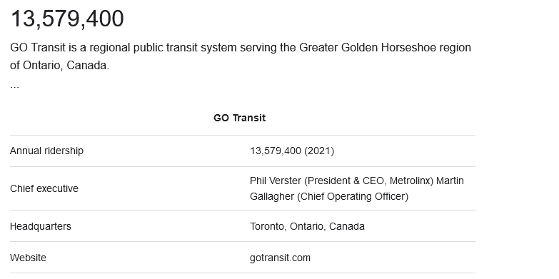

Thats fair enough, but the ability to turn over passengers will increase a lot with Eglinton, OL, and all the new urban stations etc etc.Fair enough. I went back and looked at the report, and the growth figures I quote in percentage terms are from the report I cited/linked to.
That report didn't have an annual figure, and I googled that, and failed to note that the number came from 2021:

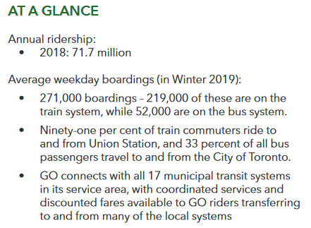

You correctly note, I should have used a pre-pandemic year:
The above would attribute 80.8% of weekday ridership to rail. I'm not sure if that cleanly extrapolates to weekends.......
But assuming it did, 62.2M would the be the annual rail ridership in 2019.
