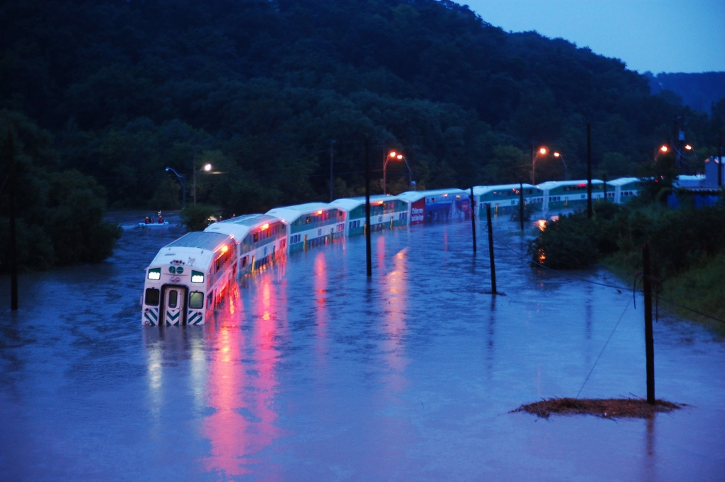

Frequent, all-day, 2-way GO service would require grade separation of Pottery Rd.
You can't go down due to flooding issues, which means the rail corridor would have to go over Pottery, given the need for a relatively gentle grade, this impacts a huge length of track, and in the middle of an ESA no less.
