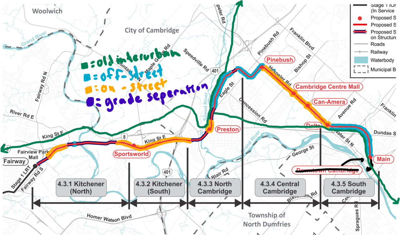

My thought is simpler -
have Metrolinx buy the Fergus Spur,
run the service as light rail but preserving heavy rail access like Waterloo
switch to on-street to get to the Guelph GO station,
negotiate a merger with ION to run the system as a unified regional entity and shared OMSF with Phase 2
