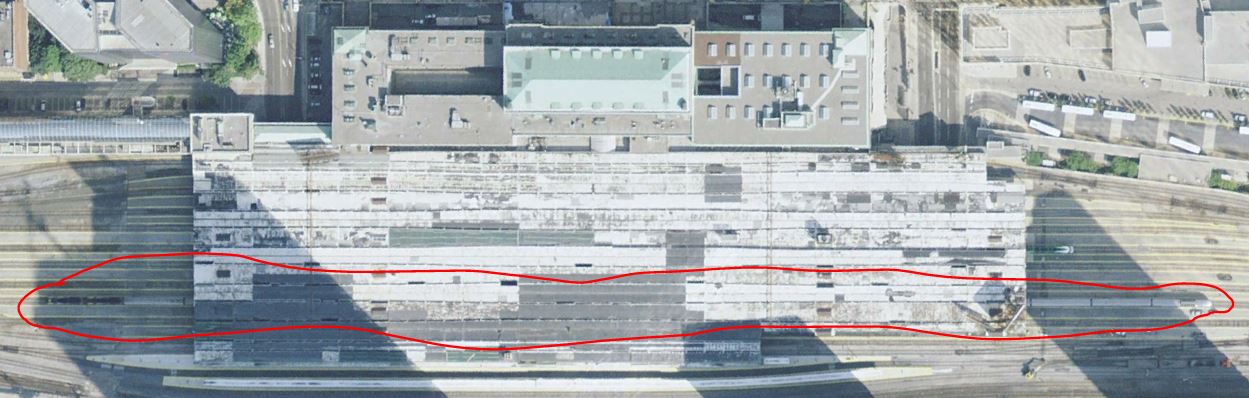

The shed is 357 metres long.

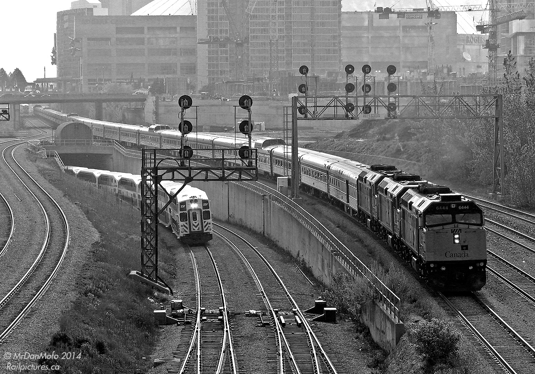

A 25 car VIA train is 648 metres long excluding locomotives. I don't know what the maximum length is for the Canadian, but it was 25 cars when I took it.
The absolute maximum they’ve run has been 30 cars and 4 engines (4th engine on the back).
