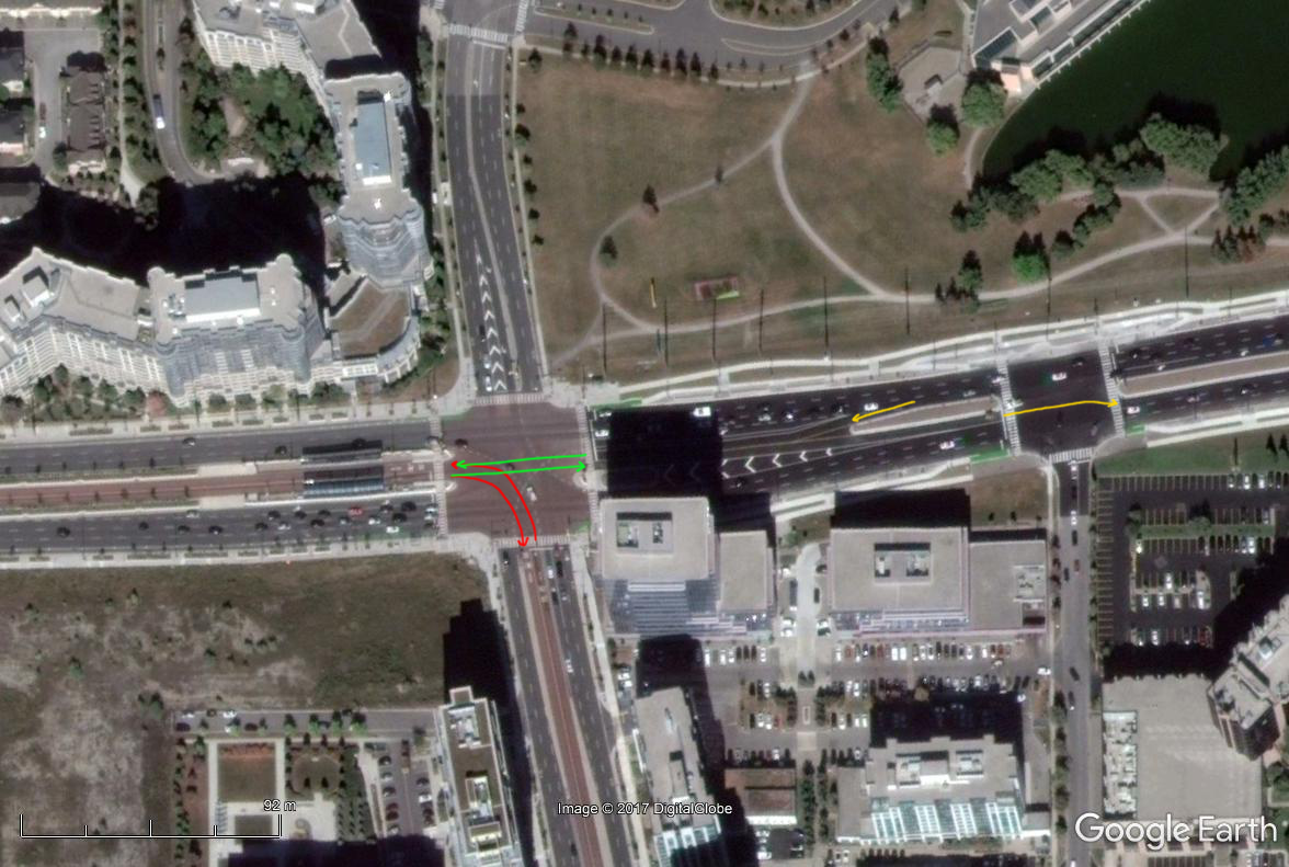

I would just like to add how the traffic signals work on Highway 7 at Town Centre Blvd, where there are dedicated centre median bus lanes that form a "T" intersection. There is a dedicated traffic signal that has 4 lights: green forward arrow, yellow, red, and white vertical bar. The vertical bar is for buses turning (while the red light is still on) and the green forward arrow is for buses going straight. The bus turning phase occurs before the normal traffic turning phase(s) :eek:. What I'm questioning is how a turning bus will cross the intersection if there is a straight bus in front of them, which will result in the need of waiting for the next signal phases. This is assuming the lights don't know which way the bus wants to go.
I know this doesn't directly relate to the King Street Pilot, but it's just something to think about.

Doesn't the rapidway currently end at Town Centre Blvd such that no buses go straight eastbound? I think they're doing two branches of Viva Purple in the future, where half of the buses will continue east moving to the curb lane, and the other half will keep turning off on Town Centre.
With buses needing to cross some 4 or so lanes to get from the rapidway to the curb lane, they will need a signal phase all to their own just as they would when turning. Presumably the signal phases will remain as present, with a white vertical bar the bus can either go straight and cut across to the curb lane, or turn right.
