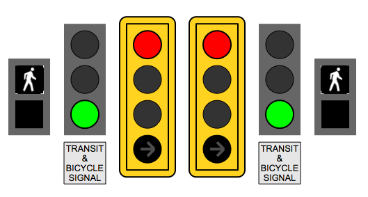

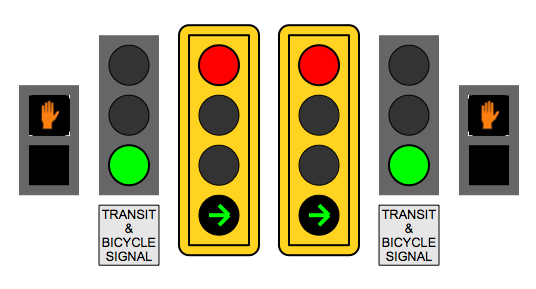

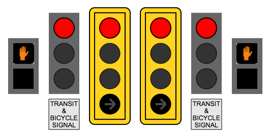

Don't give up! This particular method is a non-starter, but there are other ways of accomplishing the same general premise.
Ideally we'd have a greater array of available signal displays supported in the Ontario HTA (such as the flashing yellow arrow or a greater array of white-bar transit signals), but even with current regulations we can set up the signals to make the intersections automatically self-enforcing. For example:
E-W Thru and EWR
E-W Thru
N-S phase(s)
Since the vehicle signal is always red, we can use red light cameras to automatically ticket any unauthorized vehicle which drives straight through. Note that red light cameras are the only type of automated enforcement currently legal in Ontario.
Obviously it's less than ideal, showing green and red side by side and including wordy signs. But it's what can be done without having to go through the lengthy process to update the Highway Traffic Act and the Ontario Traffic Manual to legalize other more intuitive signal indications.
This option was presumably not used for the current pilot simply due to the cost associated with installing the additional signals and their associated hardware. If the pilot were to become permanent, a self-enforcing design would surely be installed given that it would pay for itself in fines anyway.
Personally I'd like to see this setup installed at at least one location during the pilot to measure its effectiveness in deterring illegal movements, thereby confirming to Council that the pilot would be reasonably enforced if it were permanently implemented.
Other note
- I used a unique "Transit & Bicycle Signal" sign to get around the HTA's requirement for duplicate signals. Otherwise we'd need 2 Transit Signal heads plus a separate Bicycle Signal head (note that bicycle signals are exempt from the duplication requirement as of 2016), which look more cluttered.

^ Excellent post! You'd think that City or TTC staff would already have informed the Mayor and Council on this. There are answers!

But didn't I just demonstrate that it's possible to make King work without challenging the HTA? As you know, I totally agree that the HTA needs to be changed, but I feel it's probably best to wait till Ford gets the boot before picking that fight with the Province.
Duplicate bicycle signal heads are not required by regulation, but are listed as a "should" in OTM book 12A.
Your design might work well with a white bar transit signal atop the regular yellow signal, and then the two bike signals.
Agreed. Best to minimize confusion between the transit green and the vehicular traffic green. Mount the bicycle signals somewhere near the pedestrian signals. Otherwise, a great suggestion reaper!
