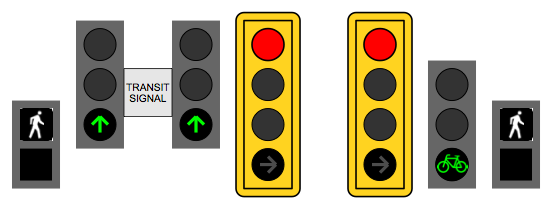

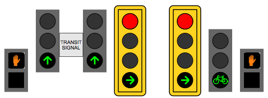

Duplicate bicycle signal heads are not required by regulation, but are listed as a "should" in OTM book 12A.
Your design might work well with a white bar transit signal atop the regular yellow signal, and then the two bike signals.
Agreed. Best to minimize confusion between the transit green and the vehicular traffic green. Mount the bicycle signals somewhere near the pedestrian signals. Otherwise, a great suggestion reaper!
I agree that it would be better to have white-bar transit signals, but as I have explained before here, implementing them would require major changes such as to the HTA and/or to every other white bar signal in the City, since currently a vertical white bar in Toronto means "Turn left or right, but do not go straight".
Further explanations here:
https://urbantoronto.ca/forum/threa...-transit-priority.19816/page-154#post-1279258
https://urbantoronto.ca/forum/threa...-transit-priority.19816/page-154#post-1279308
Like I said in my last post, this signal design is not supposed to be the best possible design, it's just a design that is possible right now without any changes or exemptions from operating policies or legislation.
Here's another option which is perfectly compliant with current regulations and standards:
Notes:
I think the guidance from OTM Book 12A is more applicable if the bicycle signal were the only signals for the approach (for example along a standalone bicycle path). In this case, they display basically the same thing as the two Transit Signals so there's no need for a fourth redundant signal. Also, if I'm not mistaken, book 12A predates the 2016 HTA amendment we're talking about so at the time of writing duplication was actually a legal requirement.
Also note that bicycle-shaped Bicycle Signal lenses were also legalized in 2016 with the same HTA amendment.
Notes:
I dont think the Transit signals should be green or arrows personally.
Drivers will just see the green arrow and assume its for them.
Most people driving dont actually read signs
FYI, your suggestion prohibits pedestrians from walking along King, given the right arrow gives turning traffic priority over conflicting traffic.
Well, maybe they should be given priority.
Give a quick light sequence to only cars to allow them to turn right with prioirity over pedestrians and bikes.
It will prevent pedestrian and bike accidents, and I mean, we are stopping cars from using King, its a good compromise that will encourage motorists to turn right versus go straight illegally.
Isn't that the arrangement now? When I'm walking along King around Church, the traffic gets a green right-turn arrow and the pedestrian signal remains red, then the green arrow disappears and the Walk signal lights up.
But there still is the regular green light for cars, which drivers understand it as if they can proceed straight forward.
I don't think so, at least at the same time, but whether it does or not, the point is moot: There's at least one set of lights and/or sequence missing to make it work. Under the Pilot section of the HTA, the City could have applied to use whatever seemed fit for "up to 12 years" as a 'pilot'. What seems eminently sensible is to adopt (with some fine tuning, as the TTC uses the vertical white bar to signify something different...probably a mistake in protocol years ago) is what other Ontario conurbations are already using, namely K/W and Ottawa.

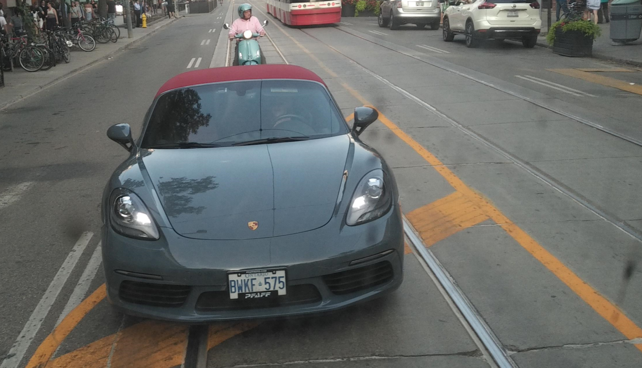

There is certainly confusion for drivers. I watched someone with New York plates behind a streetcar, run through one, and then slow down before the next, and you could see him trying to make sense of all the signage, finally turning right.
A couple of times getting out of a westbound Flexity at Jarvis, I've made a fairly neutral comment to the car driver behind that they'd run through a no-entry. And they both apologized, and did U-Turns! Which very much surprised me.
There are some (including taxis) that blatantly violate this. But some are just confused (and having the car in front of you blatantly violate it doesn't help!)
The key thing however, is that though some are violating, most are not even getting on King in the first place! There's a LOT less traffic than there used to be.
I took a rare (for me) westbound 504 all the way from Sherbourne to Alantic the other day about 6:30 pm. In the past such trips have been horrific. One one particularly slow occasion, I actually bailed at Church, walked to Union, caught a Lakeshore West GO to Exhibition, walked back to King/Atlantic, and boarded a 504 westbound ... with my original car still behind me around Bathurst! It was certainly quicker to walk!
But the other day, looking at the data points in Google Timeline - it was 16 minutes from Church to Bathurst! And only 6 more minutes to Sudbury (though Bathurst to Sudbury was never particularly bad). Plus we were very full, as there'd been a short gap in front of us, which I'd think would only slow us down ...
It's a stunning difference! I only wish I had Google Timeline running a couple of years ago, before the pilot.
I did see 3 or 4 cars running through. But I also saw police westbound just past both Spadina and Bathurst having pulled someone over and seemed to be ticketing them; so there is some enforcement ... which I seldom notice on King East near Jarvis - where I'm much more likely to be.
Here's a couple of the offenders. I have no idea which company the orange taxi was even part of - had 1053 painted on it, but no company; he ran about 3 lights. The other car I think did 4. Gosh, that's 8 demerit points! Gosh, look at all those bicycles!
