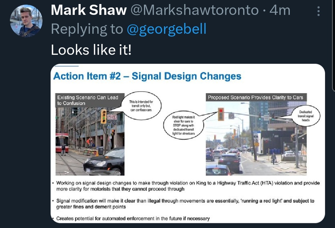

A further improvement to chows plan, which doesn’t go far enough, is to shut down the driveways that dump cars onto king. The obvious one to start with is the major parking exit just east of York, it has other exits on Wellington; and no entrance. It dumps people onto king who must turn right and then block Bay, or turn left across two tracks, often blocking them. Shut it down from 3pm to 7pm, and reroute everyone onto Wellington…

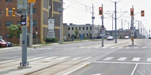

If they really want it clear for motorists, they should be using the standard transit signals than normal signals and a sign telling you that it's a transit signal.
If the "standard transit signals" you're referring to include horizontal bar for red (such as the ones on the Waterloo LRT), instead of a red circle, then they are specifically prohibited in HTA Regulation 626.
Red bar in Waterloo
It's literally rule number one in the traffic signal regulations:

The Waterloo signals don't need to conform to the HTA since they're only used by rail vehicles (so they can arguably be controlled under the street railways act rather than the highway traffic act). The King Street signals cannot be exempt because they also need to accommodate buses.
White vertical bars for "green" are allowed in the HTA - in addition to a literal green light per reg.626(1) - but in Toronto a white vertical bar has been defined to mean "left turn and right turn only, no through movement", which is exactly the opposite of what you need for streetcars travelling straight along King Street.
I have already explained this several times in this thread. Here is a post where I linked to several other posts where I explained the HTA and City issues with bar-style transit signals.
