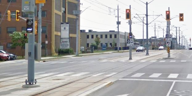

If the "standard transit signals" you're referring to include horizontal bar for red (such as the ones on the Waterloo LRT), instead of a red circle, then they are specifically prohibited in HTA Regulation 626.
Red bar in Waterloo
It's literally rule number one in the traffic signal regulations:

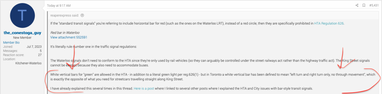

The Waterloo signals don't need to conform to the HTA since they're only used by rail vehicles (so they can arguably be controlled under the street railways act rather than the highway traffic act). The King Street signals cannot be exempt because they also need to accommodate buses.
White vertical bars for "green" are allowed in the HTA - in addition to a literal green light per reg.626(1) - but in Toronto a white vertical bar has been defined to mean "left turn and right turn only, no through movement", which is exactly the opposite of what you need for streetcars travelling straight along King Street.
I have already explained this several times in this thread. Here is a post where I linked to several other posts where I explained the HTA and City issues with bar-style transit signals.

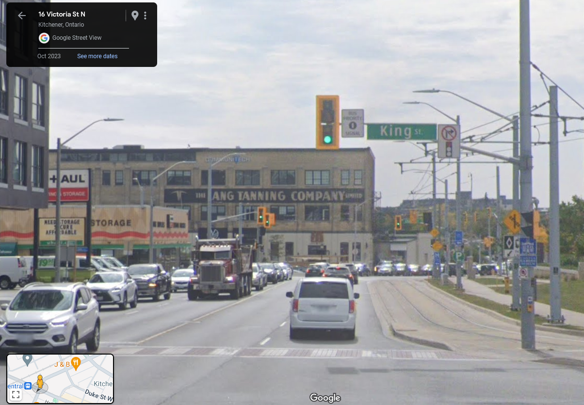

Some extra perspective from Waterloo Region, there are other intersections that have bus priority signals like here at King & Victoria. In this case, there's a dedicated bus queue jump lane in the far right lane (to the right of the Google Maps car in this case). The light will remain red in all directions, but the top of this signal has a vertical white stripe that illuminates to permit the bus to advance first and make a protected left turn from the right lane.
I don't doubt your HTA knowledge, but there's clearly precedent for exceptions if you know where to look. Maybe King St could use something similar?

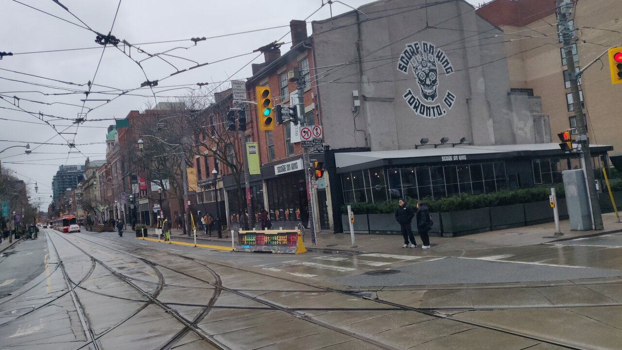

Are combined transit and bicycle signals allowed under the HTA?
I'm assuming the main signal will always be red (except between 10 PM and 5 AM for taxis). If thats the case, I don't see how bikes could legally move straight through the intersection outside those times.
It sounds like they're just using ordinary red/yellow/green signals so yes bicycles and transit can be controlled by the same signal since both are vehicles. They just need to write "Transit & Bicycle Signal" on the sign.
Yes the main signal will need to turn green from 22:00 to 05:00 if taxis continue to be allowed to use King as a shortcut overnight

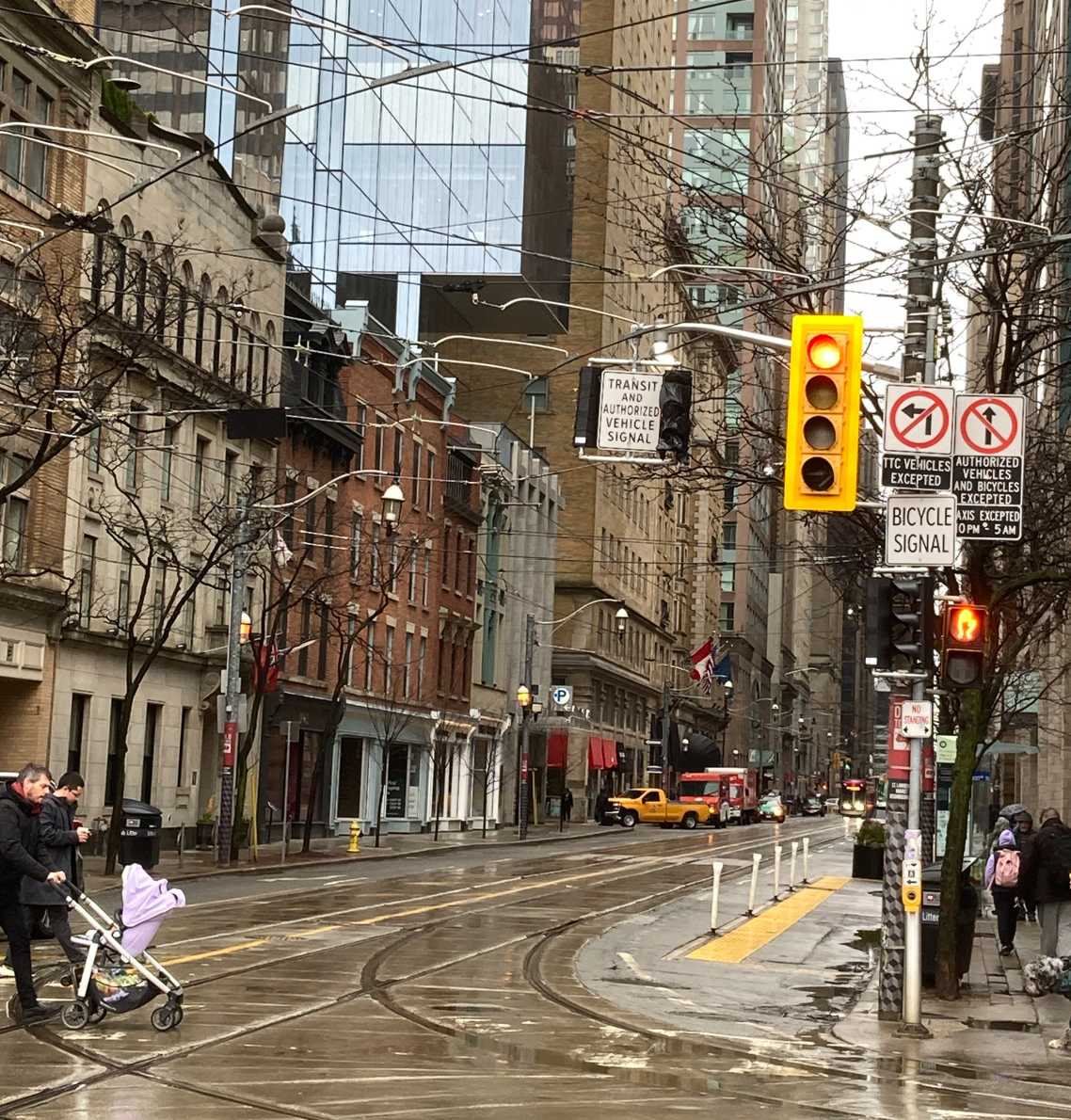

For those above wondering about the issues of the signage, the new ones have now been installed above the mini signals and they say simply "Transit and Authorised Vehicles Signal"
So it's a catch all sign that will actually allow the main light to stay red at all times of day with a separate sign indicating what is authorised and when to use these new mini signals.

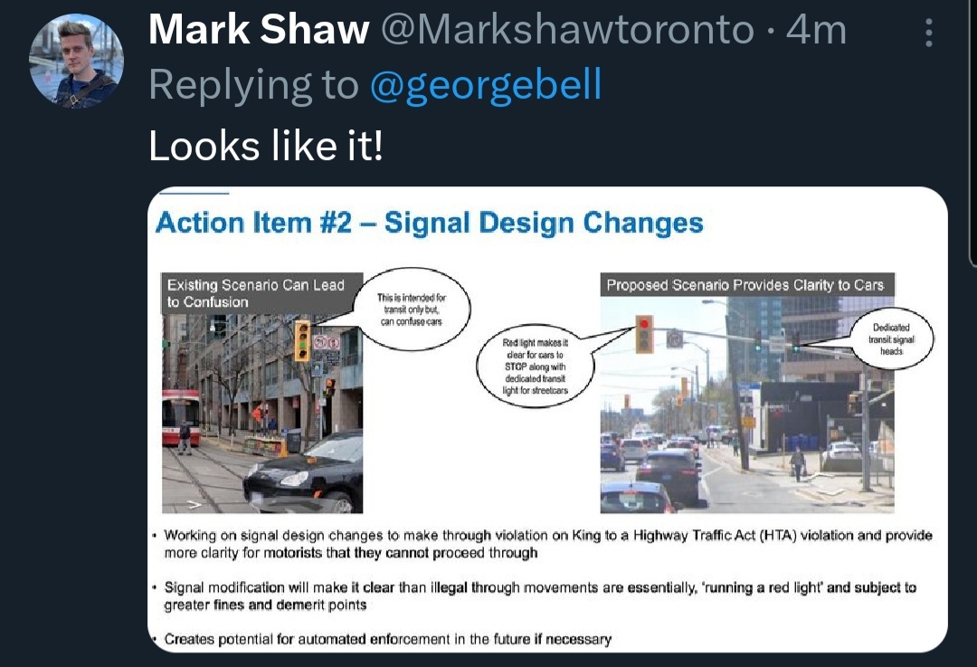

Does this mean that red light cameras will be installed to catch violators? The Highway Traffic Act requires a red signal for them... seems like this clears the way for camera enforcement.
Then we'll really see some compliance.

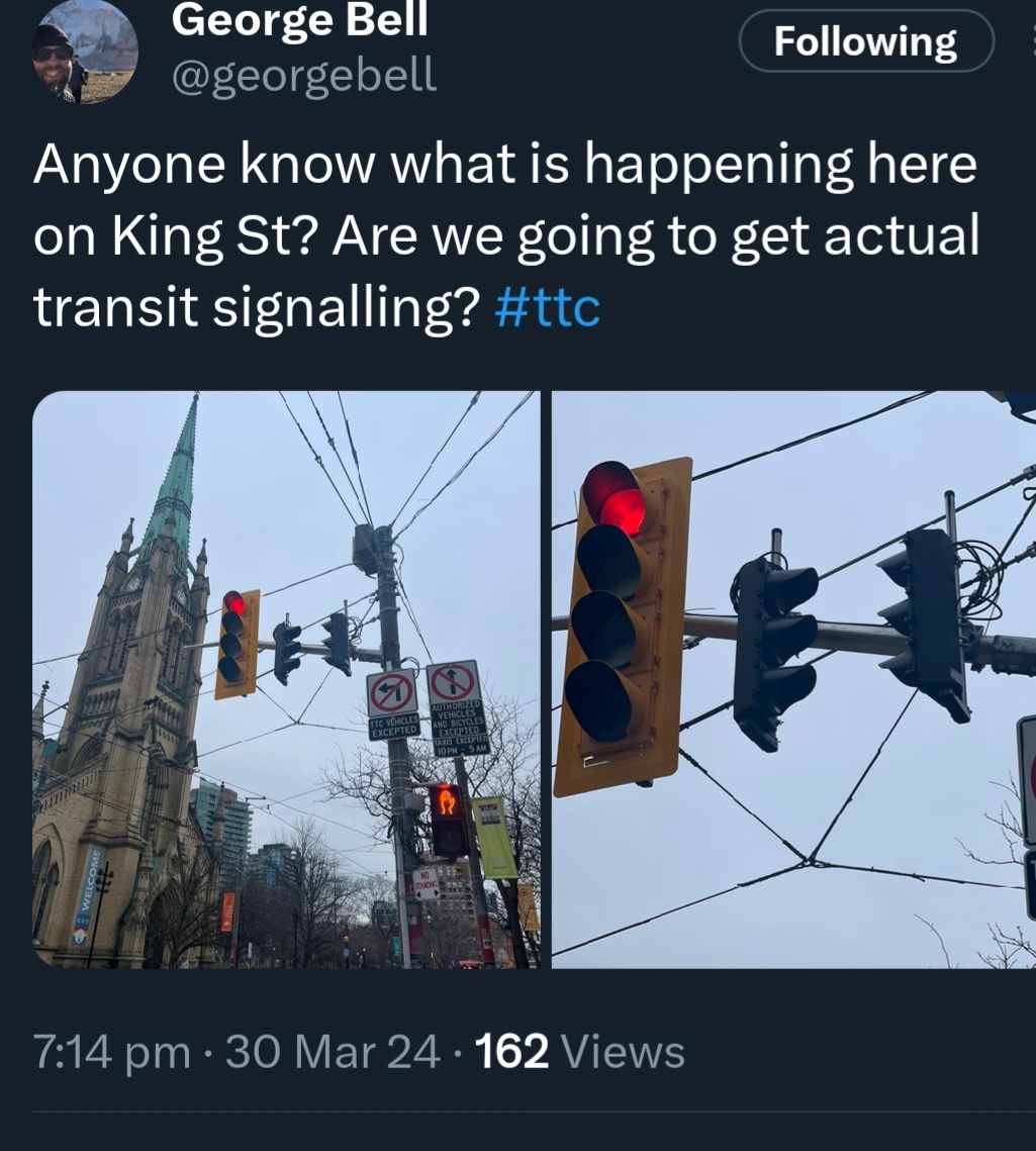

King & Church this afternoon
I honestly can’t believe this actually happened. Good on Chow and Council.
I think this will help. It’s one thing for people to drive through an intersection on a green traffic light. It’s another thing psychologically to do it when facing a big red light. I’d still support putting red light cameras at every intersection in Toronto.
