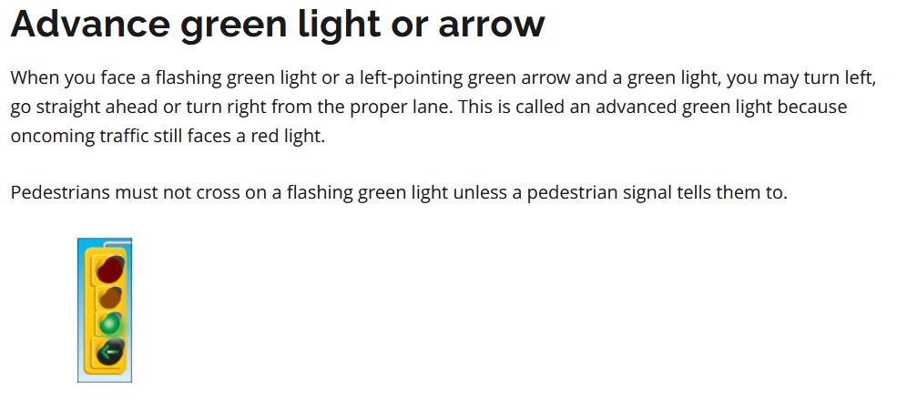

If you want an arrow and a walk light on at the same time, it needs to be a flashing yellow arrow, not a green arrow. That would indicate "proceed with caution" and the ordinary rules of an (unsignalized) intersection would implicitly apply, meaning that turning drivers need to yield to pedestrians.
The HTA does not explicitly assign right of way at traffic signals, it merely defines the directions they can proceed. The assumption is that traffic engineers have designed the signal phasing such that people can proceed safely according to their driver's training. Not everything that you are tested on in the G1 test is a law. Engineers also need to take into account that people do not drive based on the technical wording of the HTA, they drive based on their previous experience with roads in Ontario:
Specifically, drivers are explicitly instructed that a green arrow tells them that conflicting traffic will face a red light. The HTA can't tell people to turn blindly because even with the right-of-way a driver entering the intersection must yield to traffic already legally in the intersection (e.g. an elderly pedestrian who is still crossing from the previous pedestrian phase).
https://www.ontario.ca/document/official-mto-drivers-handbook/traffic-lights

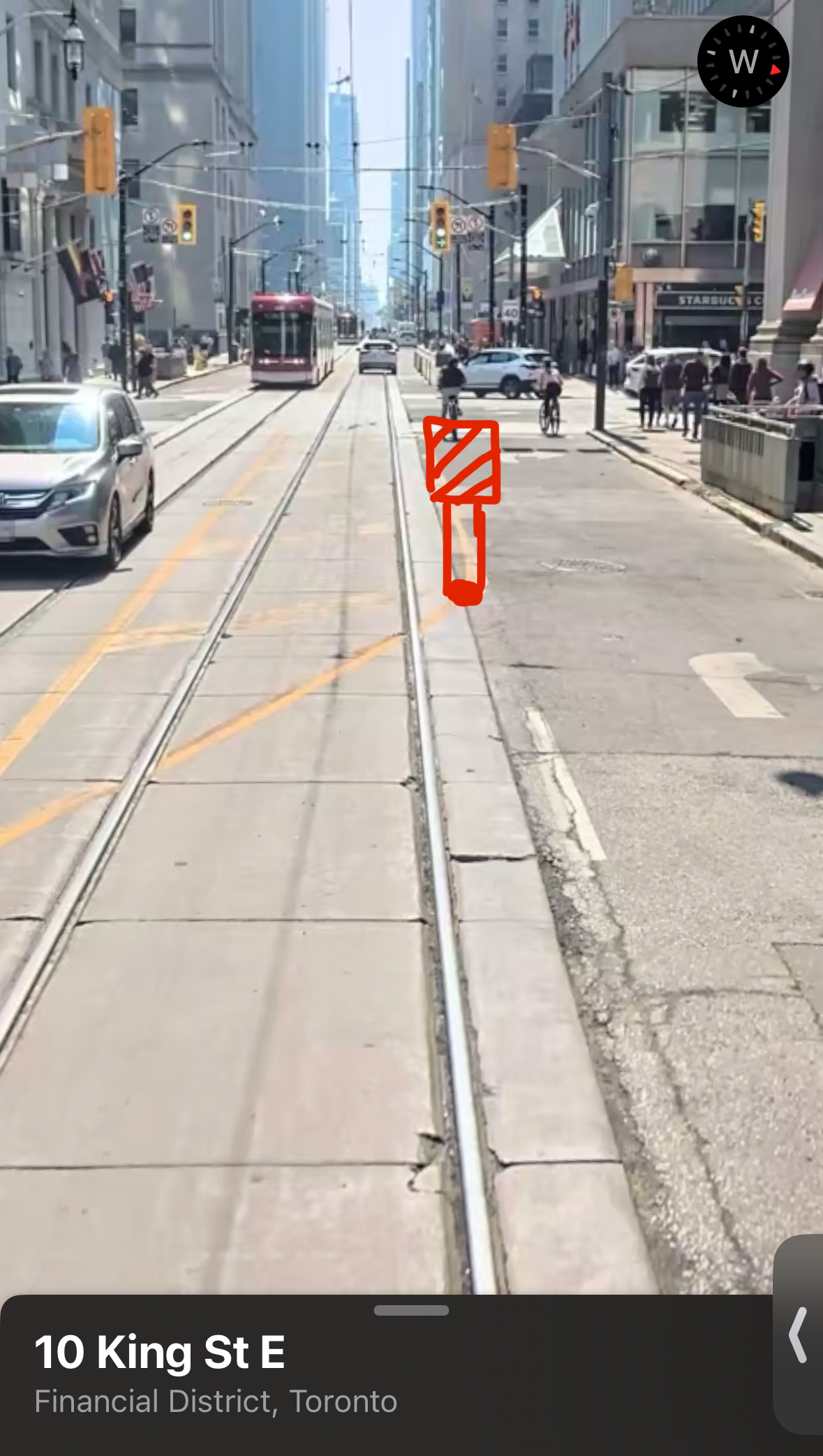

Imagine flexi posts positioned like this with some kind of slim signage attached. Would be a good early warning to drivers to move into the right lane.
Could be one of the cheapest temporary measures, considering the future reconstruction of the street. I’d definitely also like to see a solid coat of paint over the tracks here.
