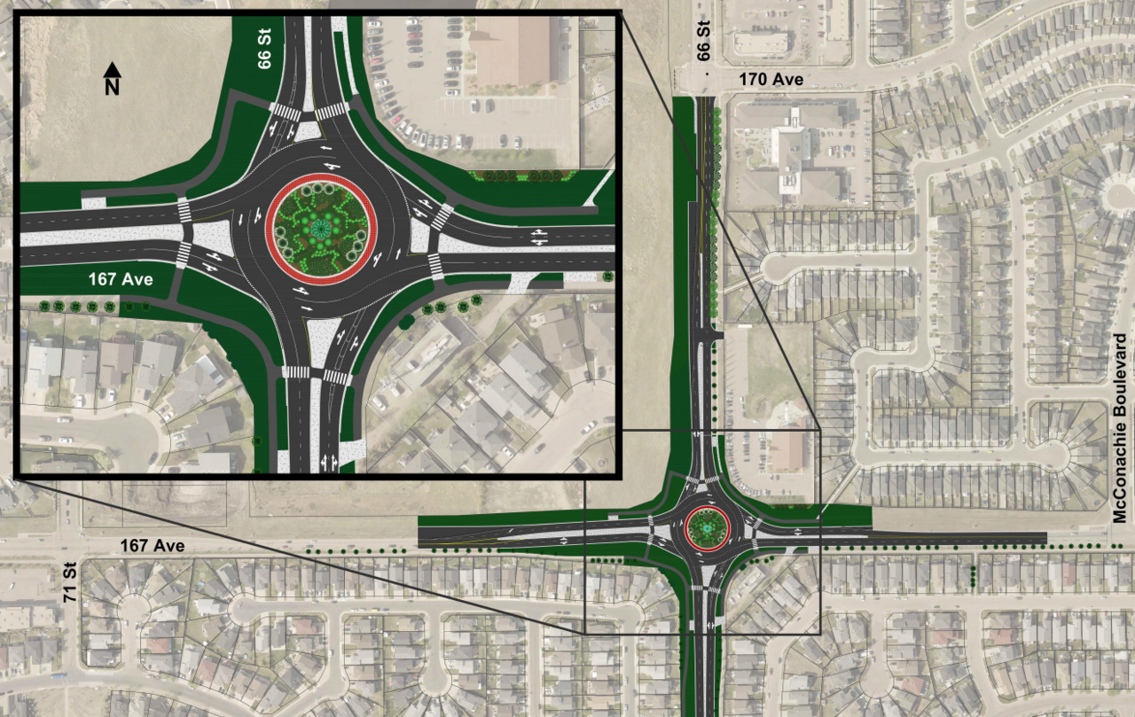

A new roundabout has started construction at 66 St and 167 Ave

These are all the rage these days... 'turbo roundabouts'. I've seen a few and they are intended to speed things up, but are even more confusing it seems.
Can someone explain to me why Edmonton roundabouts are like this? Normal roundabouts are right lane to go right, left lane to go through or left.
Every roundabout has a high collision warning because allowing the right lane to go straight creates 4 yield locations inside the intersection.
Is this correct? I feel like I saw plenty of roundabouts in Australia that worked exactly like this one. Problem here is drivers that don't understand how they work and careen through them without caution.
Transportation engineers like 'em for intersections where a lot of the traffic travels straight so it allows for higher traffic volumes rather than everyone jammed into one lane. The resulting accidents are usually fender benders without significant injuries so it's viewed as more of an acceptable risk.
Could be. Roundabouts in Southern AB were always in the form I described, to the best of my knowledge. I had never seen this variety until moving to Edmonton.

Roundabouts are objectively the safest form of intersection, and as soon as they try to "dumb them down" they make them far more confusing. On a related note, if they're going to chew up an intersection to make a roundabout, couldn't they make it somewhere with higher traffic? It seems like they chose this location at random.
