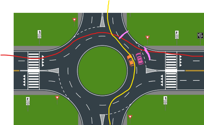

Can someone explain to me why Edmonton roundabouts are like this? Normal roundabouts are right lane to go right, left lane to go through or left.
Every roundabout has a high collision warning because allowing the right lane to go straight creates 4 yield locations inside the intersection.
Actually, this works fine. You’re right that within the roundabout, drivers in the right lane within the roundabout continuing past an exit have to yield to traffic in the left lane exiting the roundabout. However, it looks like drivers in the outer lane won’t be allowed to driver past the second exit. Hence, they only yield to inner-lane traffic when entering the roundabout (where they’d normally have to yield anyway).
Yes, but inner-lane traffic exiting cuts across the direction of outer-lane traffic going through. That's what I'm describing.
In a conventional roundabout, you yield at the entrance to the intersection then you can proceed as normal. In a "turbo roundabout" as Ian called it, the right lane has to yield when entering, then yield a second time to inner lane traffic leaving through the first exit. Many drivers don't understand that they need to. I'm not sure if it's faster or not, but it definitely seems more likely to cause accidents.
Yield points in pink.
In theory, there should never be the second yield. As long as a right lane driver going to the second exit yields to oncoming traffic like they're in the left lane, they should never have to yield a second time within the circle.
Technically, you’re right. In practice, though, that second yield would be heeded at the same time as the first yield before a car enters the roundabout.
