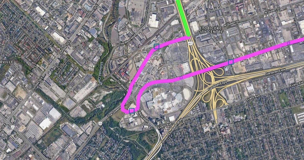

Ontario Line West Extension
This is my proposal for a western extension of the Ontario Line, including exact routing, rough station locations and explanations for each section of the line. To preface and prevent any confusion, this is set roughly 15+ years in the future and assumes that the Gardiner east of Park Lawn has been capped and eliminated as a highway, with the entire structure east of Exhibition being destroyed. However, west of Exhibition the former Gardiner R.O.W is preserved and used to create a widened GO/OL corridor. Additional tracks are added to allow for future express/branch lines or interlining with any future TTC/GO project.
These three images are a relatively low detail rendition of the full map I created on a separate platform. The link to the full map is below and on it each portion of the line and each station have in depth explanations given for them.
I hope you find my proposal interesting and I welcome feedback and advice.
The colour key is as follows:
Blue = Expanded GO Lakeshore West Corridor
Green = Highway Median
Pink = Elevated Track
Section 1:
Starting from the current OL terminus at Exhibition, the line runs along the repurposed Gardiner R.O.W until Park Lawn road. The OL will have a connection with the currently under construction Park Lawn GO Station. From here it enters the median of the Gardiner Expressway and runs at grade so as to not conflict with the low bridges over the Gardiner along Royal York and Grand Avenue. There is already a substantial median on this portion of the Gardiner so no major lane reductions (if any at all) would be needed. Arriving at Islington, the line raises off the Gardiner and runs elevated over what is currently the Cineplex parking lot on the south west corner of Islington/Queensway. It then runs elevated down the center of the Queensway. An elevated trackage further east of Islington on the Queensway would not be possible due to the narrowness of the road and existing suburban homes.
Section 2:
Continuing elevated along the Queensway, the line has a flyover over the 427/Gardiner interchange. From here it continues elevated along the Queensway until the West mall where it turns south to a station on the north side of the existing medical facility. Thereafter looping north-east, there is an additional station as close to the rail corridor as possible to allow for an easy transfer from the future Line 2 extension to Sherway from Kipling along the rail corridor. Briefly after this the line runs elevated along North Queen Street, then enters the median of highway 427.
Section 3:
The final and likely least controversial portion of track continues along the median of the 427, then runs elevated over the interchange of highway 427, 27 and the 401. There is a westwards run towards the eastern terminus of the Mississauga Transitway and future Renforth station of the Eglinton Crosstown Western Extension. Turning north again the route runs elevated again for a short time before entering the median of the 427 before making a western turn onto the ground of Pearson Airport. Here it once again runs elevated to avoid the complex road network below, before finally ending north of the terminal where a new station will be constructed adjacent to the existing building.

I do think it follows the the 427 too closely, and also that diversion to Sherway Gardens is a bit match. A better choice might be to make it a general Kipling RT line.

The question I am asking is no different than what I have stated in the past for maps, ""HAVE YOU LOOK AT THE AREAS FIRST HAND"" to see what there today????
Do you Think MTO Will allow 2 lanes of traffic for 13+ Months to be remove to allowing for building of the Guideway on 427??
The Same Question for the Gardiner under City of Toronto control Question??
Where on 427 do you think the guideway will be built??
Where do You Think it Will Happen on the Gardiner??
Where In The Rail Corridor do you think you can place the guideway???
What impact will the building of the guideway have on GO Service??

The pedantic engineering and service delay issues you feel obligated to comment on every post in existence is mind numbing. Half of your questions, including but not limited to
"Where on 427 do you think the guideway will be built??"
"Where do You Think it Will Happen on the Gardiner??"
"Where In The Rail Corridor do you think you can place the guideway???"
Have been answered in the forum post or within the route map itself, I encourage you to read what you are attempting to critique before commenting.
Your more political questions also ignore answers provided within the document or route map itself. This proposal PRESUMES that through whatever political machinations you can imagine, the Gardiner east of Park Lawn has been eliminated as a highway. In terms of Highway 427 service disruptions what answer are you honestly expecting? Would you like if I called up the head of the MTO and asked if their ministry would allow for lane reductions for my speculative proposal set decades in the future? Please be serious and on topic in your comments as what you have produced so far is of essentially no value.
You also expressed concern that I am unfamiliar with the area and am simply crayoning on a map. I have spent my entire life living within the areas discussed in this proposal and have been on each of the roads and highways quite literally hundreds of times. I travelled up and down them where sidewalks exist to see if what if I am proposing fits the geography and if space would be available.
Finally, as for GO service disruptions, there has continuously been weekends without GO service on the Lakeshore West corridor to facilitate construction of the Hurontatrio Line. So yes, GO disruptions may be needed for construction, but there is immense precedent for that in the case of expanding rapid transit.
I looked closely into the following the old Kipling RT plan, but apparently the hydro corridors are no longer available for transit? Something to do with the provincial ministry. The other issue with that route is it misses all the existing and future density in Sherway gardens and along the 427 (west/east mall). I don't think building a whole light metro through deeply suburban central etobicoke is worth the cost.
