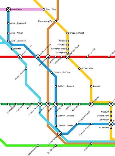

A Dufferin-Jane alignment could offer a long term solution to many of the problems we've collectively identified. This map includes GO lines, proposed GO stations as well as Line 5 and 7 in their entirety for context. The dark blue line is the DRL West. This is a longer version of the previous map I posted on Page 1.
Some very solid ideas here. A few suggestions:
- There aren't enough stops. DRL west should have stop spacing similar to line 2. I would add stops at Bathurst and Queen, at Dundas and College with an underground connection to Dufferin Mall, and maybe one at Dufferin and Davenport (close to George Brown?).
- The line misses Parkdale and the important connection to multiple lines at Roncesvalles. How would you address this gap?
- Perhaps Dufferin should get its own subway line while the DRL serves Parkdale, Roncy, the massive coming density hub at Dundas West, the Junction, the Stockyards, then veering north-west to Mount Dennis, Weston, and up Jane into North York as you proposed.
- Taking DRL along the Queensway is insane overbuilding. A surface LRT ROW west from Humber Loop to Sherway is the solution there.

If going up Dufferin, the last station would be (1) Ossington or Shaw and Queen, and then the big 90 degree curve would begin. The next station would be (2) Dundas/Dufferin. Next would be (3) Bloor/Dufferin. North of Dufferin, you could have (4) Dupont, (5) St. Clair, (6) Rogers, (7) Eglinton, (8) Lawrence, and (9) Yorkdale West. There are no real routes that lead towards the northwest.
If going up Parkside/Keele, stations could be at (1) Ossington or Shaw and Queen, (2) Dufferin/Queen, (3) Landsdowne/Queen, (4) Roncessvales/Queen/King, then the more gentle curve to go up Parkside, and likely an express run to (5) Keele/Bloor (but a nice cut-and-cover portion to save costs). North of Bloor, it would be (6) Annette/Dundas/Keele, (7) Keele/Weston/St. Clair, (8) Rogers/Weston, (9) Eglinton/Black Creek, (10) Lawrence/Jane, (11) Jane/Wilson, (12) Jane/Sheppard, (13) Jane/Finch.

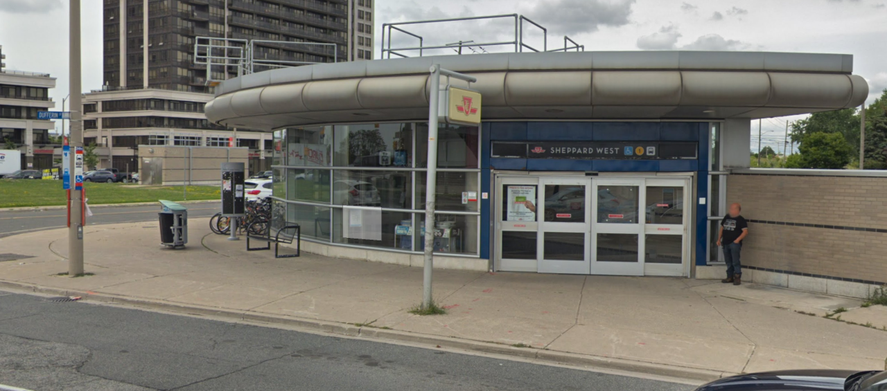

Which locations on Dufferin are subway accessible? Nothing comes to mind, except the vicinity of Dufferin station on Bloor, and in the near future, vicinity of the Eglinton & Dufferin station.
Well there is Sheppard West station at the northeast corner of Dufferin and Sheppard.
But good question in terms of the relief line other than at Eglinton and Bloor.
