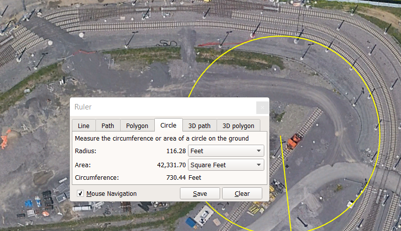

There are no curves on the system that are much tighter than the King to Union curve in Toronto, around 400 feet. At the same time, the storage yard has much tighter ones, and we have not heard of any issues there. These are essentially LRVs, not heavy rail. There seem to be some problems with the type of rail and the way it is laid that are a little too complex for me.

Good points. But it is not the case that any curves in the main line are too sharp by design, but rather that they were not built correctly in fact. This is causing the noise and damage issues, resulting in the slow orders that are currently frustrating riders and transit wonks.
Alstom states that the vehicle is suitable for streetcar service and has a turning radius of 25 meters, or 82 feet. So the repeated stuff about "sharp curves" leads to misunderstanding the problems.
