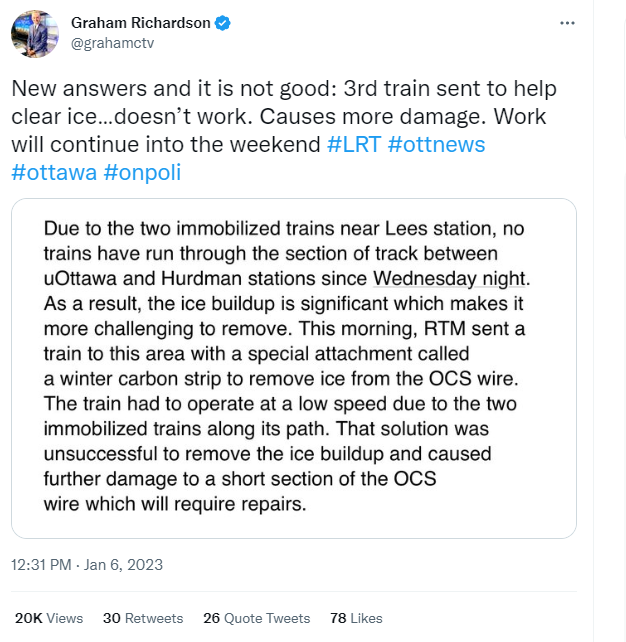

My goodness and I thought the decrepit 35+ year old SRT in Toronto running on it's last legs was bad, Ottawa's LRT is making the SRT look like a joyful experience. And that's a really hard thing to do.
To be fair the last 5 months there has been very little issue its been running really good.Even that bad snow storm a few weeks ago it ran fine even with many systems around Ontario shut down or was running a limited schedule.

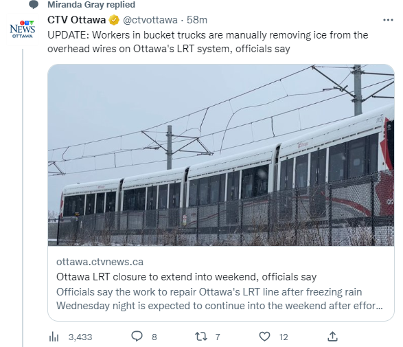

I visited the scene of the crime between Tremblay and Lees on Saturday around 5:00pm and Sunday around 1:00pm. In both instances there were only 6 workers present on the line, 3 crews of 2. Of those 6 workers only 2 were in buckets and physically working on the overhead line. Another 2 were the operators of the respective boom trucks. The last 2 were at track level, seemed to be Alston techs. The 2 workers who were actually touching the line (ie. doing actual repairs)were running their hands along the lines looking for burrs and filing them down. A time consuming process for sure and something that more man/person power would’ve obviously sped up. They were also checking and adjusting the bolts of the dropper wire, the wire between the messenger wire and contact wire. Boggles the mind that 2 people doing actual repairs to the catenary is the level response that was mustered. I suspect that RTM/RTG are not getting penalized that much as they are likely able to claim that the yare delivering ~60% of planned service since the rest of the line is operational. This of course would not drag the monthly average vehicle kilometres travelled/delivered down all that much. (I forget the actual name of the metric they are measured on).
I don't know why but most of the issues seem to be on this one small area on the east end.
